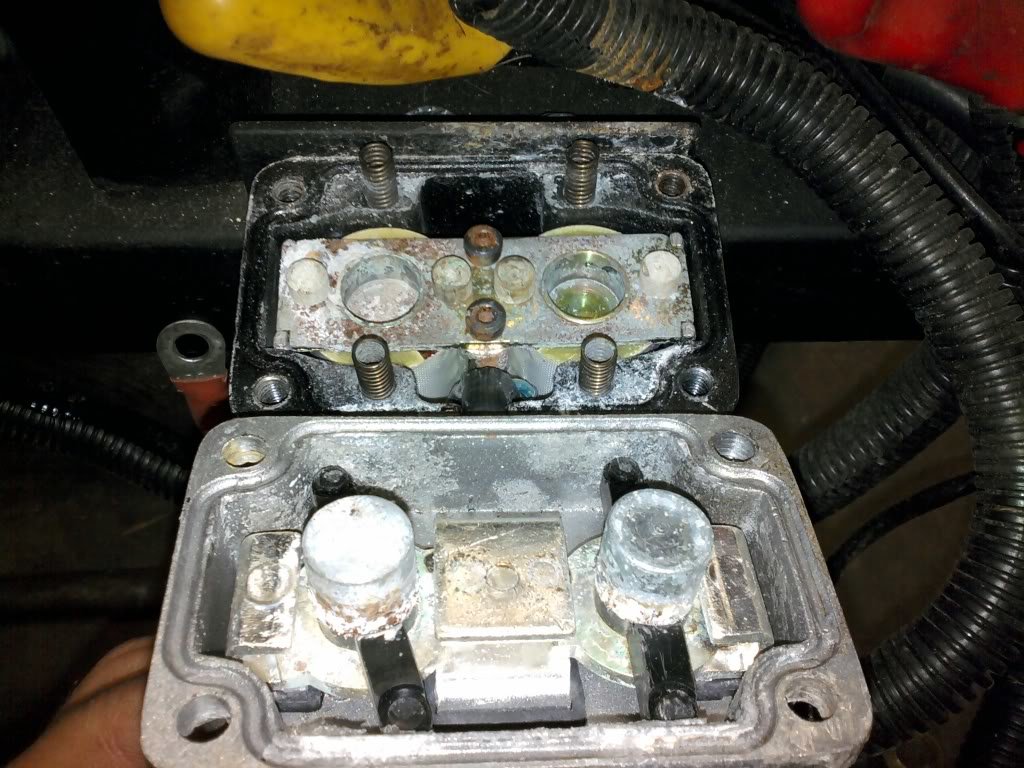

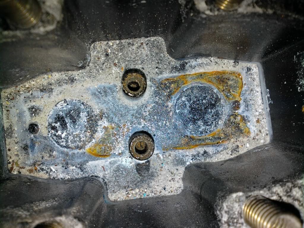

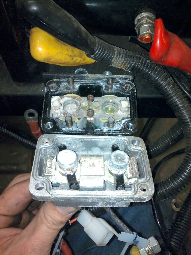

    I've had my XRC8 mounted on my truck for a couple years now, but never used the truck or the winch (it's been a shop whore because the motor went and I was slowly swapping the drivetrain). One day I decided to pull the winch solenoid to make sure it was sealed properly, but to do so I had to unspool the cable a bit and disconnect my hook. When I tried to unspool the cable the solenoid failed spectacularly. It only clicked, so I started the truck thinking that maybe some more power would coax it along. As soon as I started it up, the winch decided to unspool almost the whole drum before I could shut the truck off and get the battery disconnected. I pulled the winch from the truck and opened up the solenoid to find MASSIVE CORROSION. Enough that there's a pile of powdered corrosion on the bottom of the case.
    I've contacted Smittybuilt numerous times with no response back from their tech department. Even tried their Facebook page with no luck. I contacted the distributor that I purchased the winch from and they only want to sell me another solenoid. It did have the little clear rubber seal, I just removed it for the pictures.
    I officially regret purchasing two of these for my truck. Anyone else have a similar experience?

    Just take rtv and run a bead where that clear seal went. Then put it back together and seal off all connections coming out of the solenoid.

    I'm going to give them a call and see where that gets me. I already have the solenoid disassembled so I think I'm going to clean it up, make sure the coils work properly, check the wires for corrosion, clean up the contacts, use 1/2 my tube of dielectric grease, and seal it up good.

    I wouldn't be too confident, my truck sat in a garage since the winch was installed and this happened...

    Yeah, if I actually used this winch I wouldn't be so annoyed about the solenoid failing, I'd just buy another. But for it to sit unused out of the weather and have this happen? Well that's a problem.

    Seal it up. RTV around the clear seal. RTV around all terminals. RTV around all wires exiting the solenoid. No issues with LOTS of submersion.
    Krookz posted nearly the same pictures here and then he did a write up for sealing after his went to shit. Then he was banned and that was all lost.
