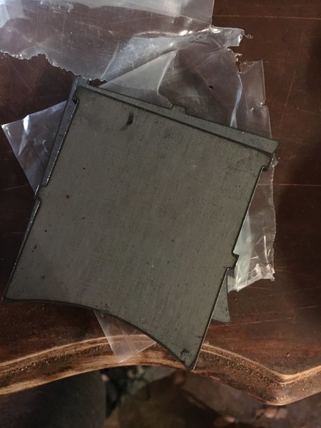

    Ight so I've been googling and searching to no avail... what are these for? Came with the 63 kit.

    Cap plates for the front spring hangers.
    Blackout14 likes this.
