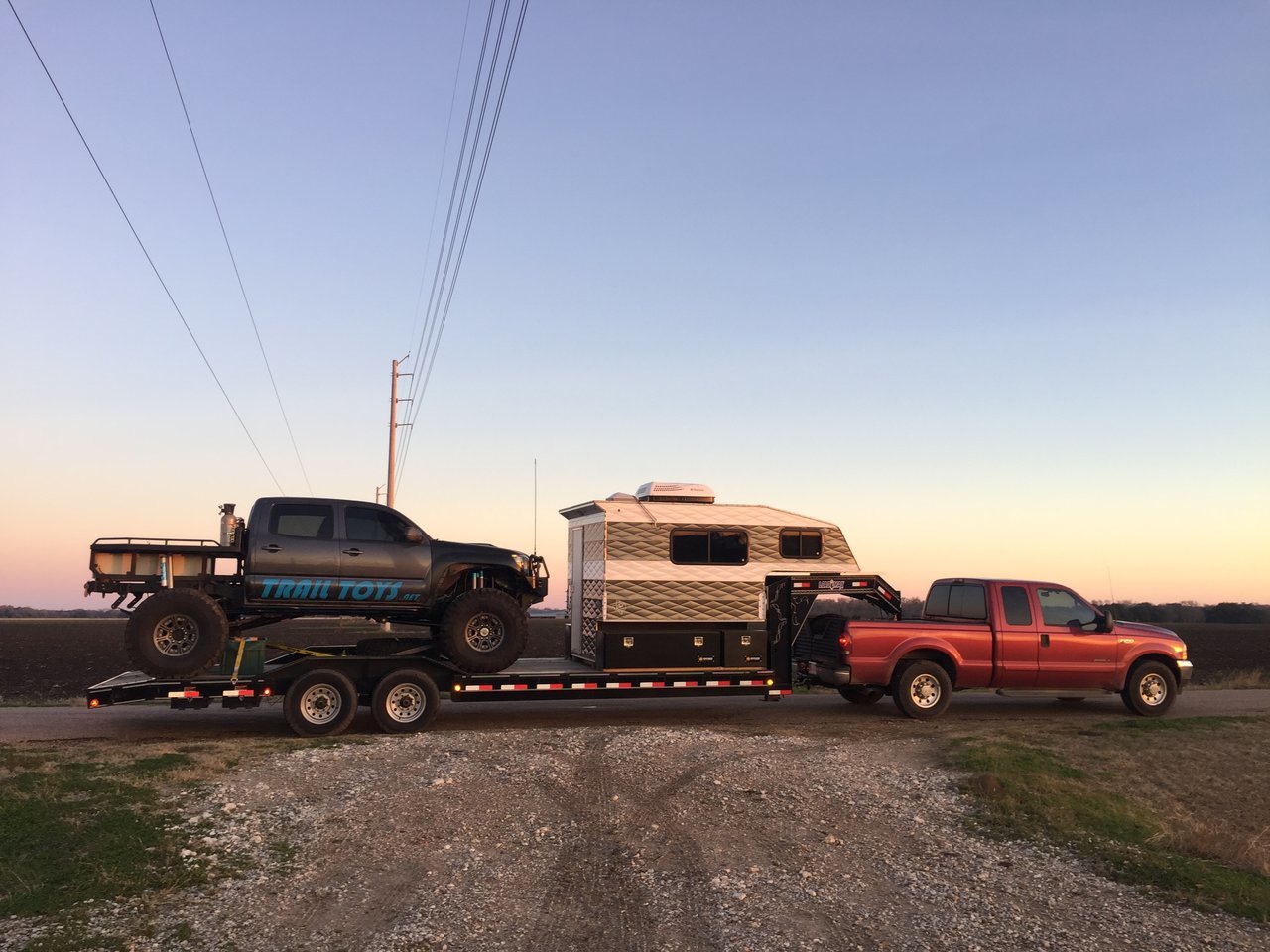

    Loaded up and headed west!

    Man that looks so sweet!
    Should Vinyl Wrap the camper something cool!

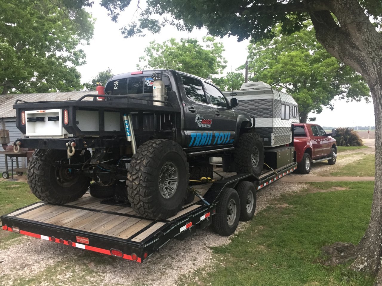

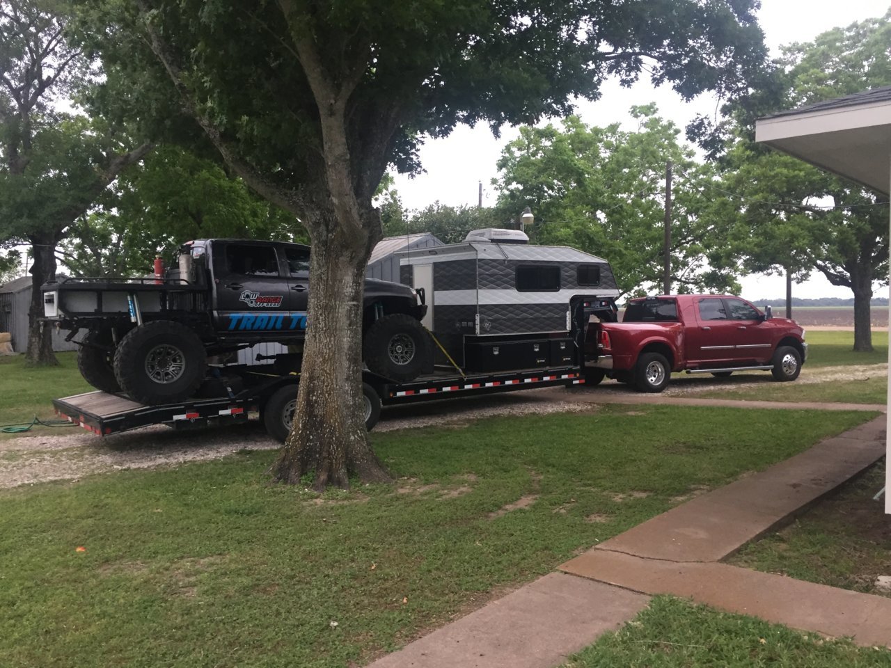

    Loaded up! I’ll hit the road in the AM bound for Jambo.

    Time to dominate! Was it a pinch getting the cage finished in time?

    I broke her, fixed her, and then broke her again. She sat at the booth for the majority of Jambo unfortunately.
