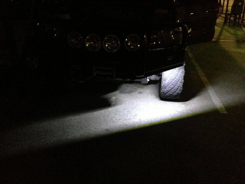

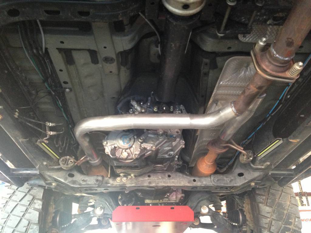

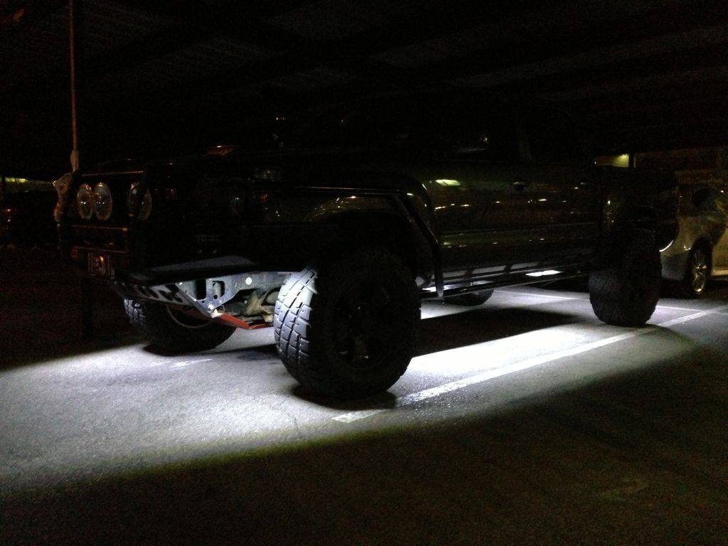

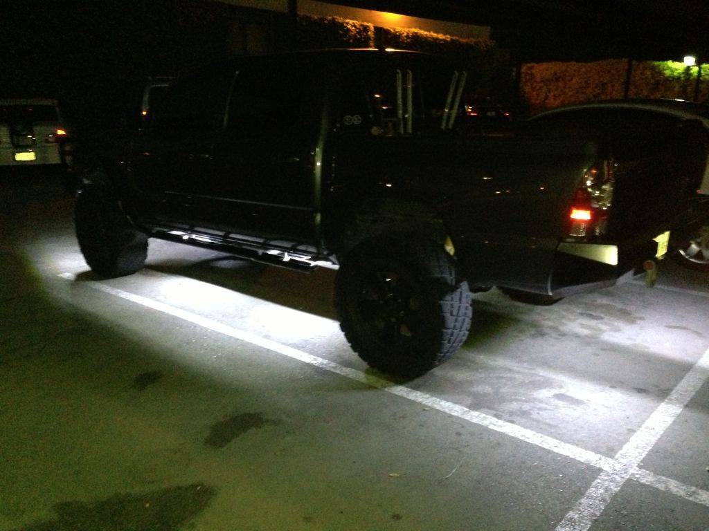

    Starting on the rock lights. I have one light mocked up to figure out the best position for them.
    This is with 9 of the lights, notice the center wasn't lit up. That'll change soon.
    Added four more lights on the inside of the frame rails to light up the center of the truck.
    You can see the lights on the frame in this shot.
    Here are the lights in action. You'll have to forgive the electronics issue. I had a short in the ribbon cable that lead to my switch panel. That problem has been fixed now.

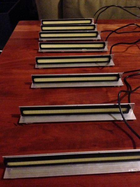

    The picture in the previous post was just one of these lights. We'll see what eight of them will do shortly. :D

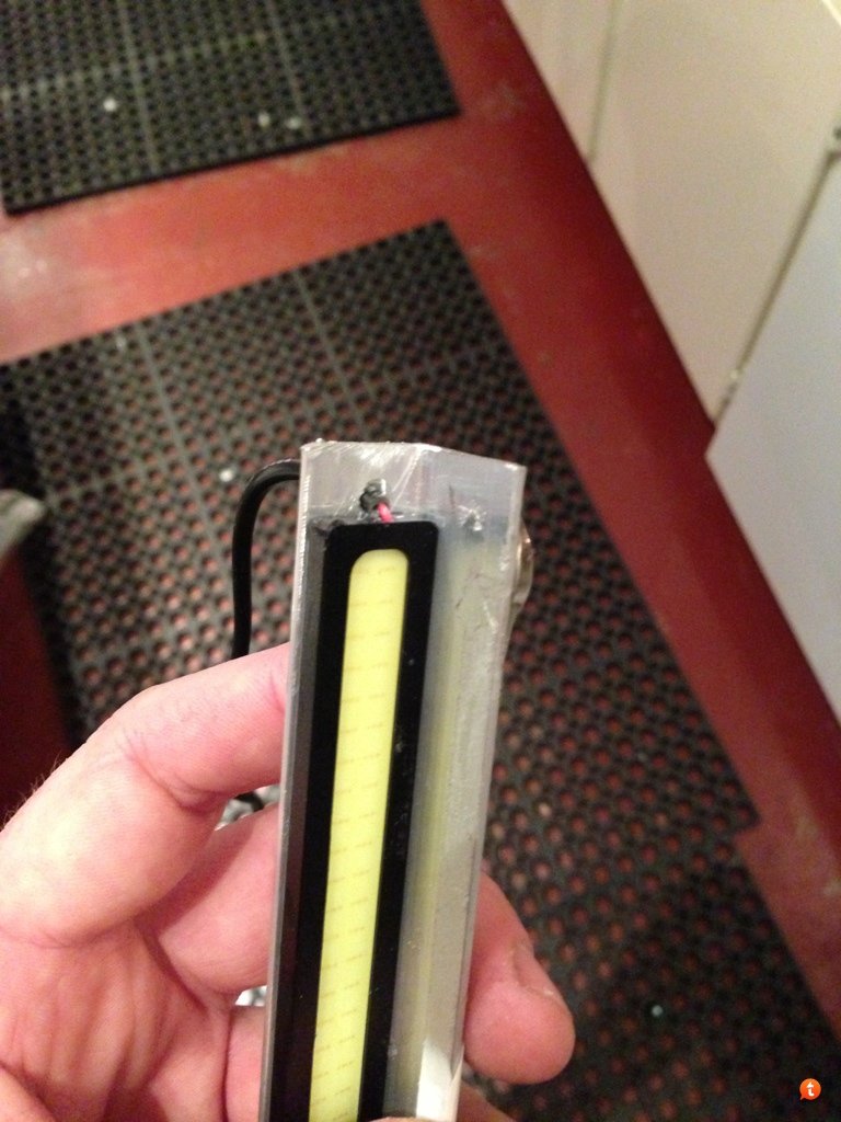

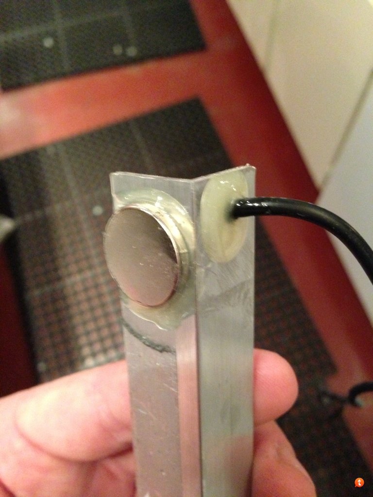

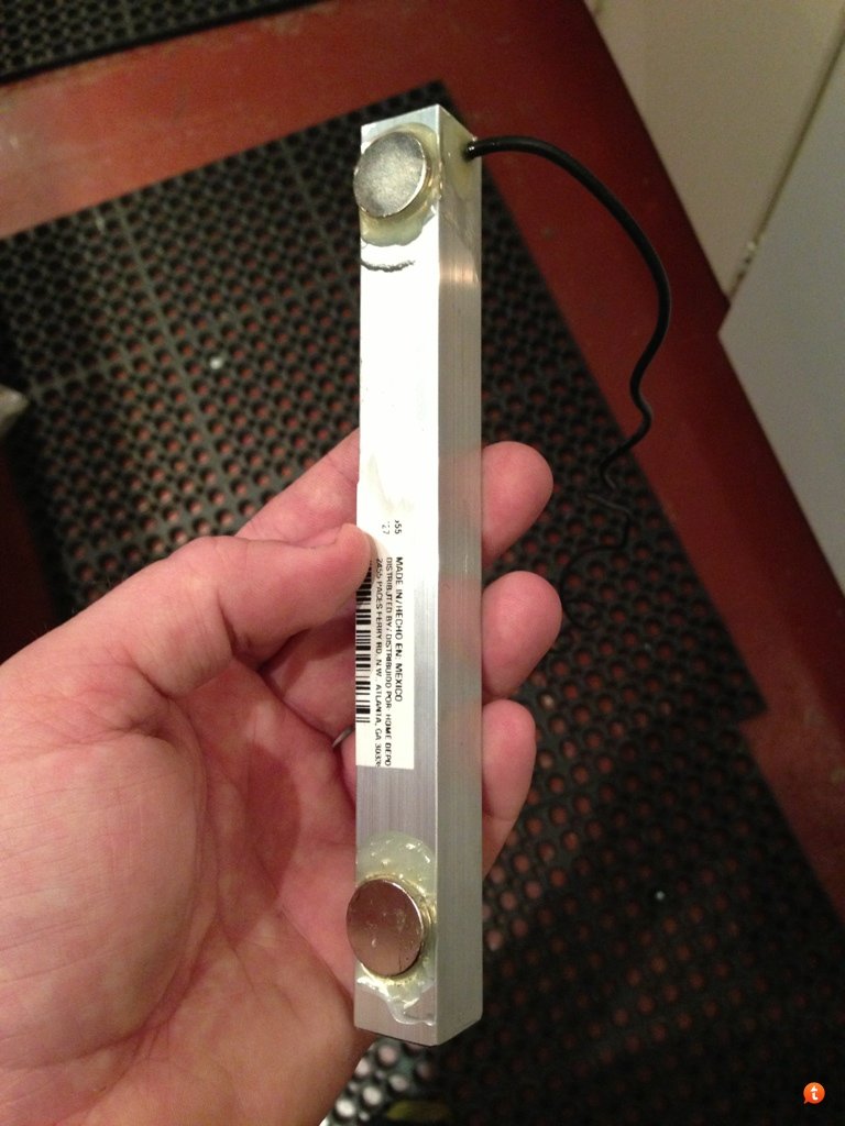

    I bought the aluminum angle and magnets at Home Depot. They're both in the hardware aisle. Cut the angle to 7-1/4" and drill a 1/8" hole to feed the wire through.
    The magnets are just epoxied on the back and I epoxied the wire where it comes out the top of the mount. I did that so I don't rip those tiny wires out.

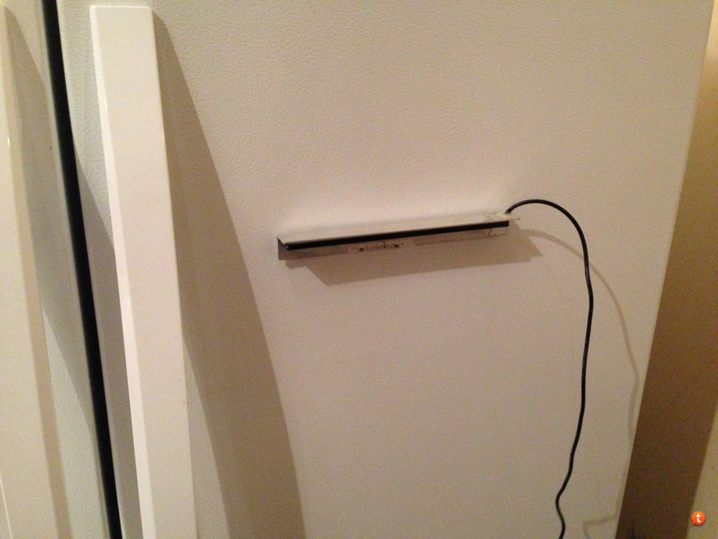

    py6e3a3e_3993d78c67ee7eec7d95ba0e8e2fdffaad16af58.jpgyte2e9ys_78a1e3dd61b7ceebcf3fb7f86a22551f4466587d.jpg2uju9e7a_2a4cf39d0a9d82530d7d20730779366ac07fc364.jpg
    New refrigerator magnets! :D
