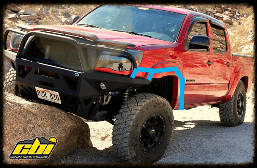

    Makes sense, I have been contemplating how to create and install a set of these on my truck ever since I saw them on the expodition overlands new tacoma. Just having a time determining how to hook it into my CBI bumper.

    What diameter are the wings on the CBI? I ordered the clamps from ARB direct.

    Therein lies my dilemna, I just got the front stinger hoop when I got it, decided not to opt for the light hoops. I am thinking might be able to make something with some of those ruffstuff connectors you used. Btw thanks for taking the time to answer my questions, always nice to find good advice here.

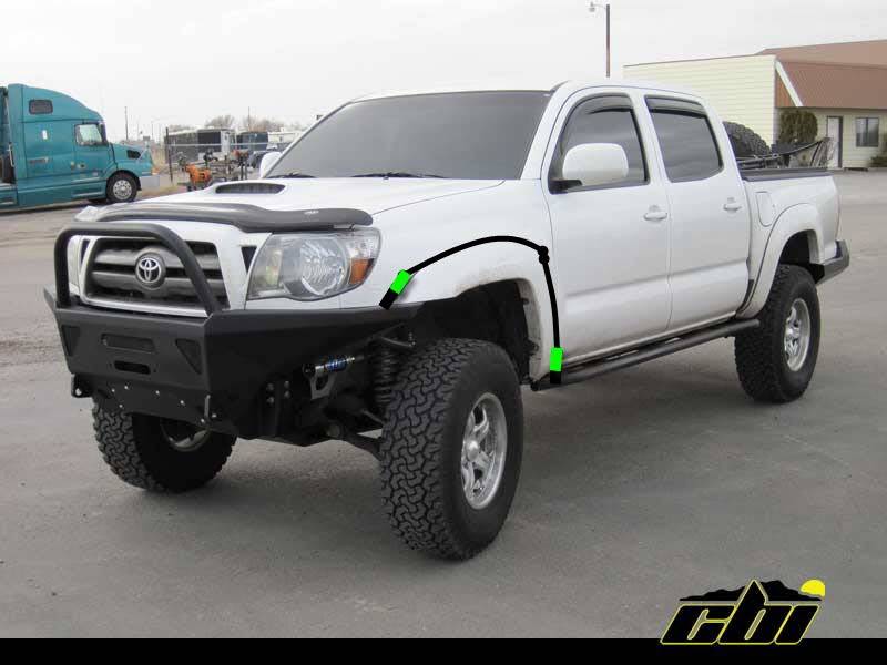

    You could come off of the side and top of the wing with two standoffs and then work the bar from there. Maybe something like this? Don't mind the hoops.
    The two bars aren't necessary, but I think it would look pretty sharp.

    I like that option, that would look pretty clean theres nothing wrong with overdoing the mounting points. I was thinking about stubbing a pipe off of the bumper at an angle with a connector on the end of it. Then run the pipe over and down to another stub off of the slider like you did on yours. Like so

    If you're going to be welding to the bumper anyway why not have CBI send you the light hoops. Then you'll have more options for your scrub bars.

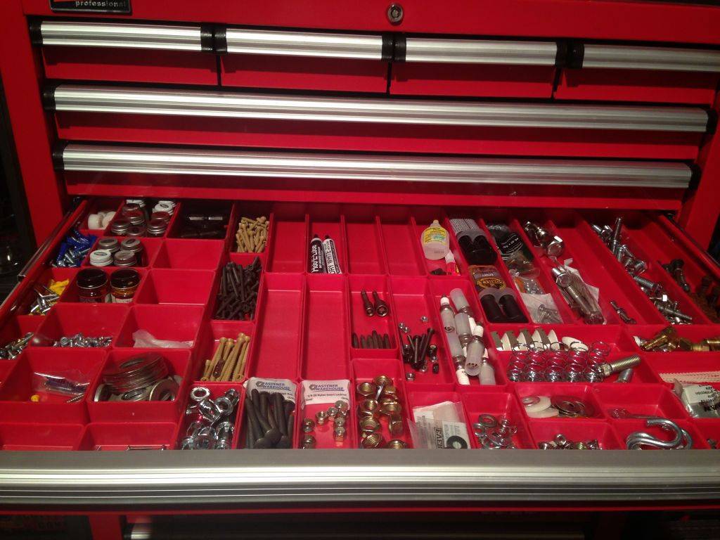

    Worked on another drawer in the toolbox tonight. This is the drawer that we all have, the one with the leftover nuts, bolts, screws, ect that collect after projects.

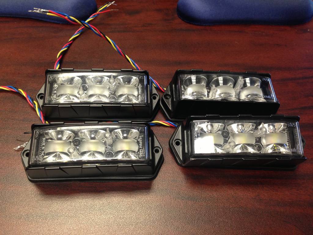

    More lights for Smokey! :eek:
    These are Feniex Apollo F6 in amber/white. They are dual mode and will light up in all white as well as flash. Two of them will be in the rear bumper and double as reverse lights. I still need to figure out where the two front lights will live.
