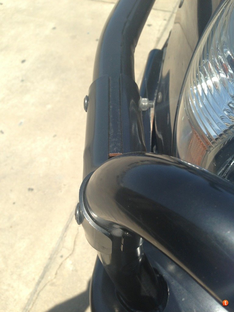

    Awesome job on the lights, they look bright as hell. One last question on those scrub bars, what are the ARB clamp dimensions? The CBI light hoops 1.5" DOM, didnt know if ARB uses 2" or not. Trying to determine if thats a valid option now.
  14. Apr 25, 2014 at 8:15 AM
    #374
    SMKYTXN
    SMKYTXN [OP] If it can't be overdone it's not worth doing Vendor
    Mar 11, 2011
    #52810
    14,040
    Nathan
    Houston
    11, 4dr, TRD Sport, 6sp
    DCFB
    I measured the OD of the ARB hoops. It came out to 1.885".

    Interesting, those clamps may be out for me then, that would be a big gap in the clamp around the light hoop. Looks like I'll need to think this over some more. Thanks for the info!
  16. Apr 25, 2014 at 10:51 AM
    #376
    SMKYTXN
    Mar 11, 2011
    #52810
    14,040
    Nathan
    Houston
    DCFB
    The clamps don't come all the way together so there is room for a smaller pipe. 3ydamuva_f597df08822e5f9d2c4794fd68ef29fd45b97763.jpg

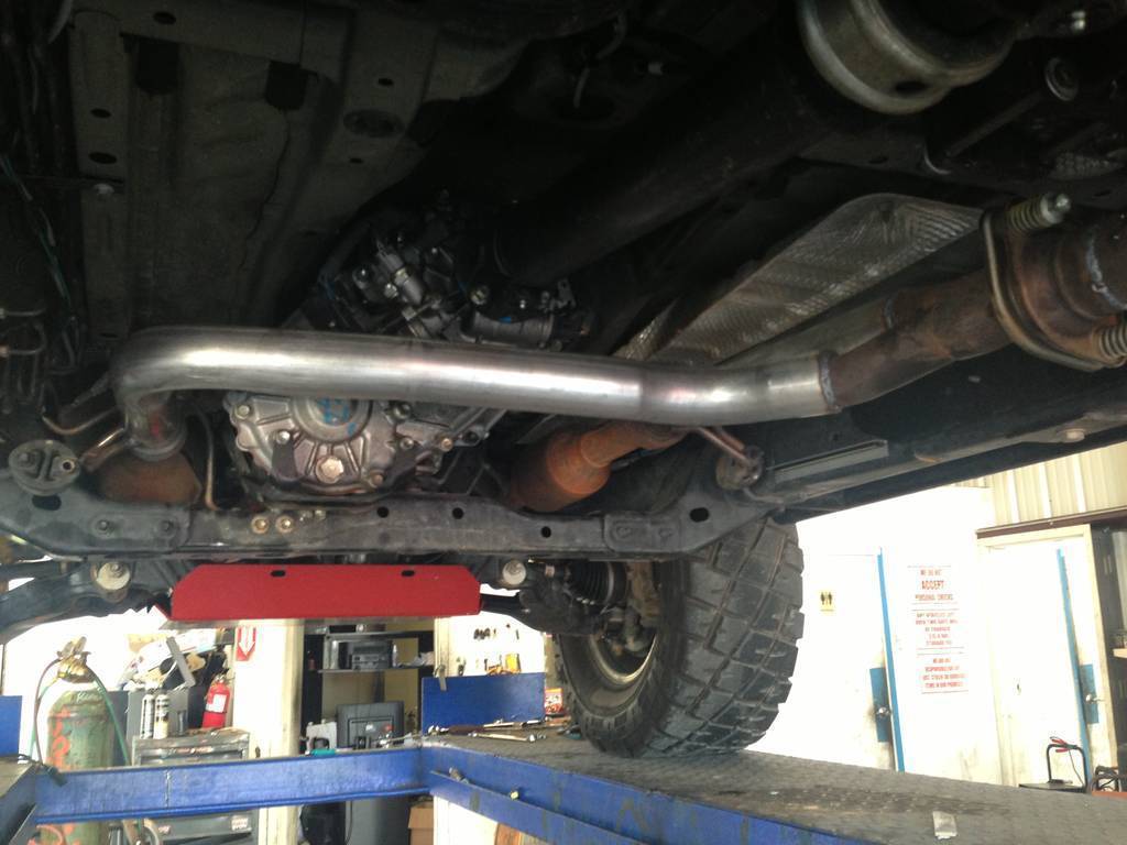

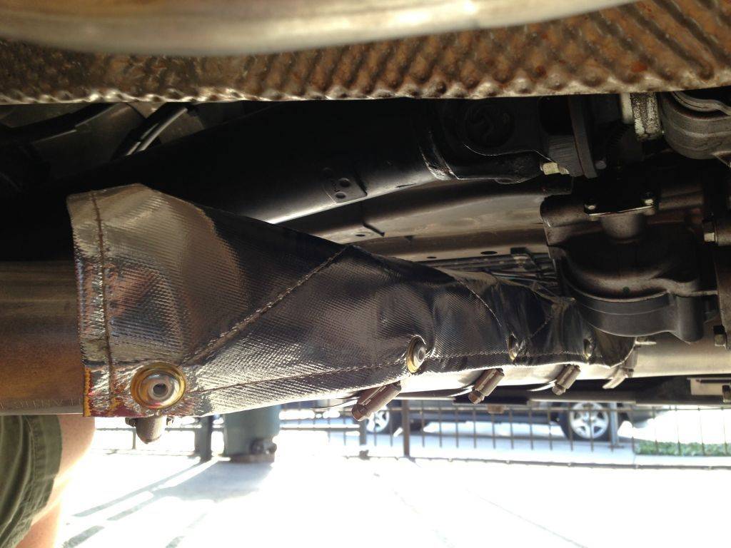

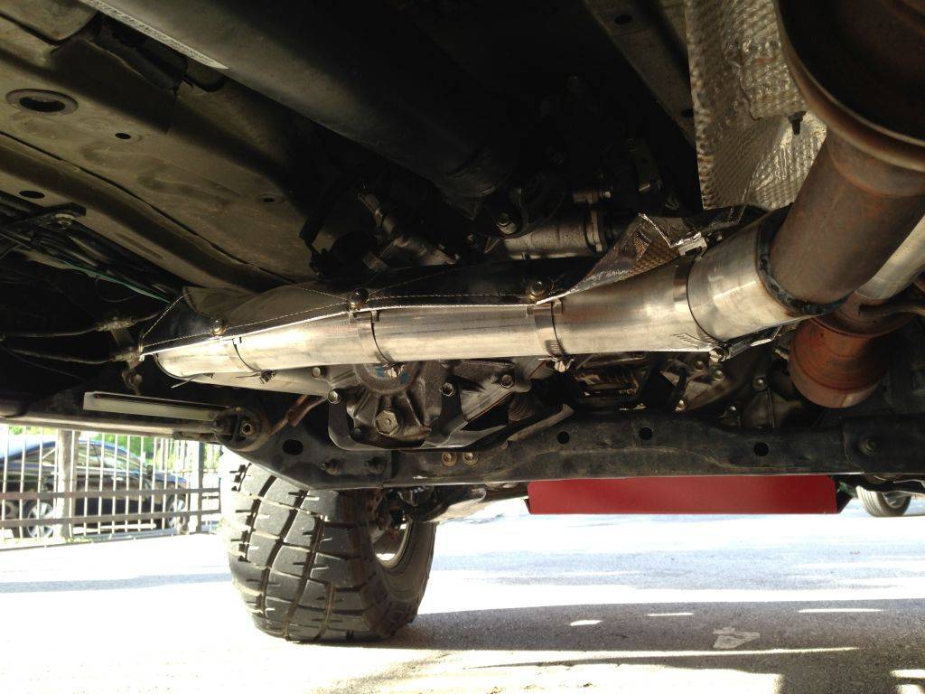

    Finally had my exhaust re-routed over the weekend. Today I added a thermal barrier to keep from cooking the driveshaft and transfer case actuator.

    Nice! VW days at work on that one?
