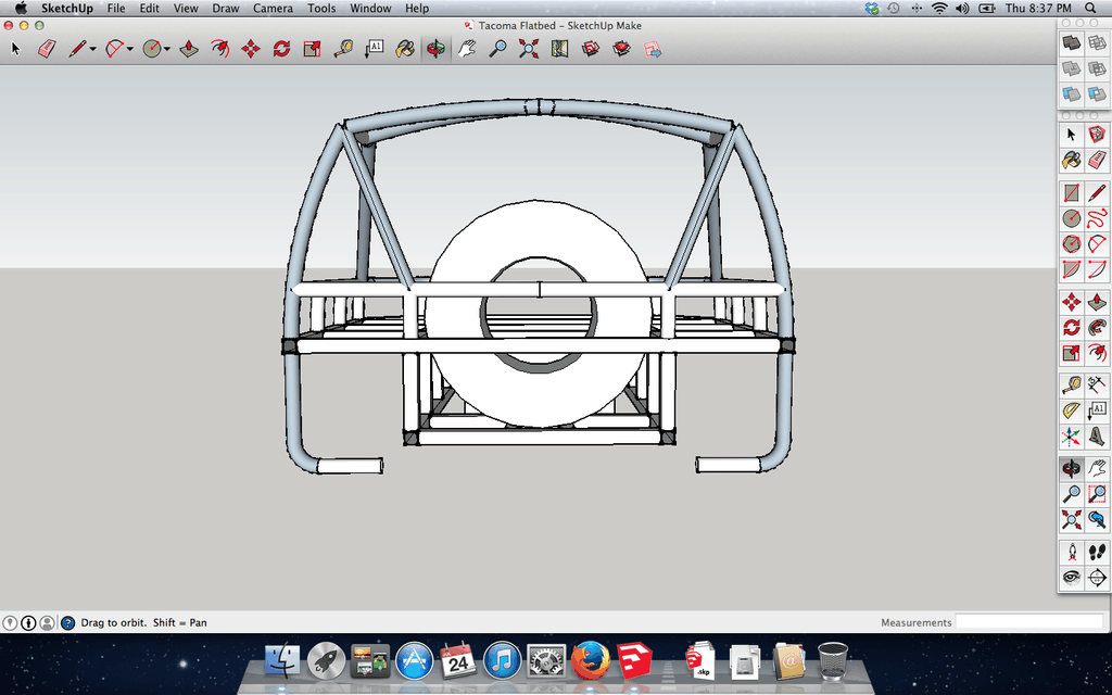

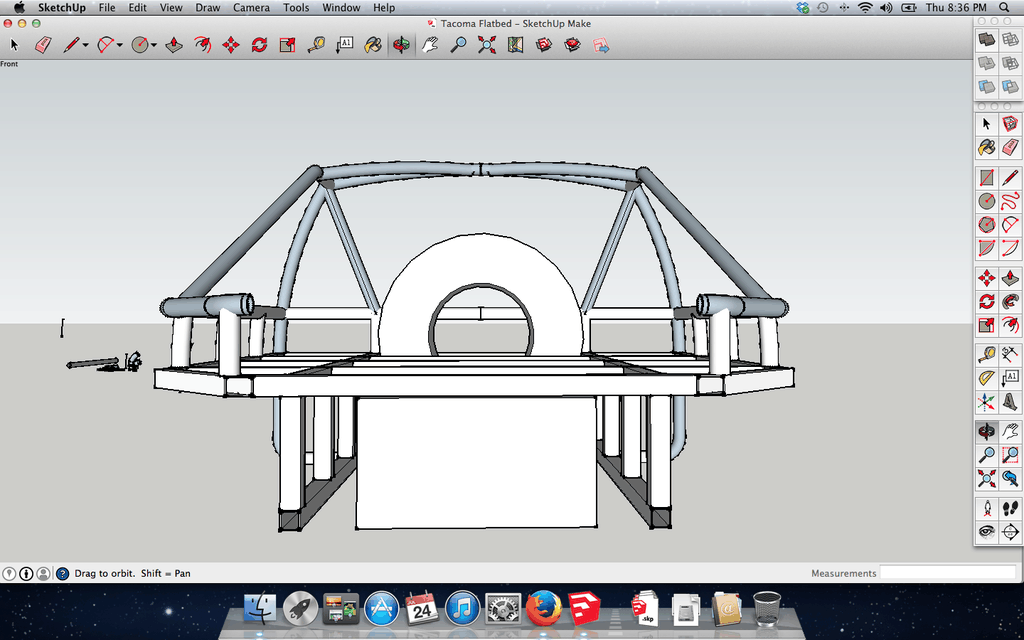

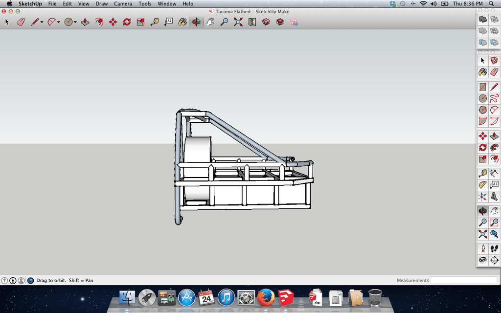

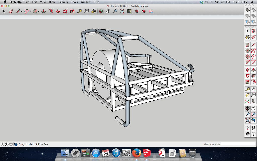

    Any ideas on how to integrate a tailgate into the back?

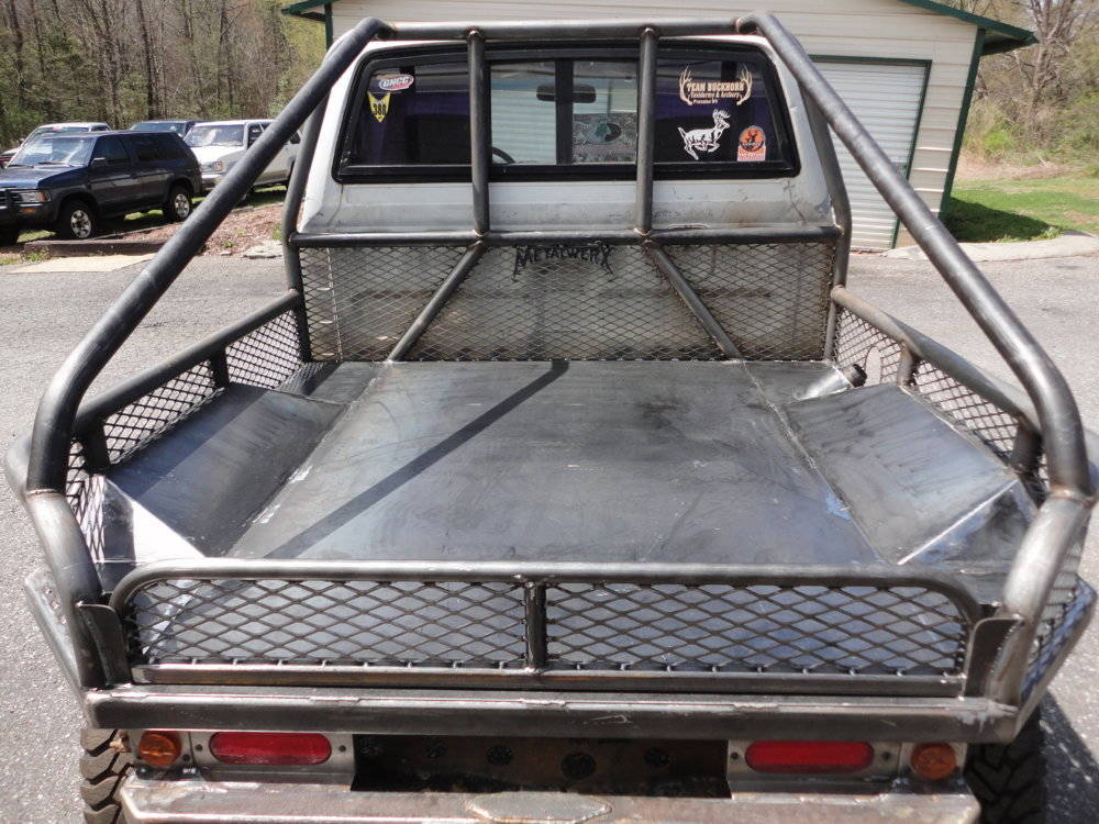

    This is one idea for a tailgate, but what do you do with it when you have a load hanging out the back? Strap it down somewhere?

    I've got it figured out. I'm going to use a trailer style hinge pin for the bottom and a Destaco latch clamp to hold the top.
    The trailer pins will allow me to take the tailgate off easily.

    I plan to build mine with heavy duty hinges and latches so that it will function like a normal tailgate.
    Edit: hah, forgot to hit post on my phone until now. those are the exact two items i was talking about. then all you need chain, cable, or some other limiting device to keep it from dropping past the angle you want.

    I'm thinking I'll have two tailgates. One that is the height of the bed rail and a second that is just a square tube. The square tube gate will have my wheel and fork mounts on it. That way I don't have to have those mounts permanently installed on the bed.

    they cost a little more, they also make hinges that style with have a brass washer/bushing on them. keeps the squeaking at bay on bumpy surfaces (aka houston roads)

    Well, I have my work cut out for me in terms of coping some weird angles, but I really like how this thing is shaping up. Now I need to figure out where the CO2 tank, fire extinguisher, and extra battery will live. I would like them to be under the wings if at all possible.

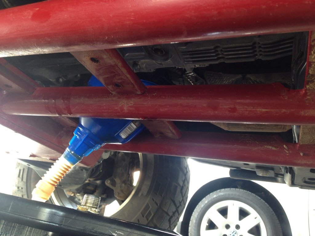

    The new mid skid holds my funnel perfectly for fluid changes. udurazyt_a937808e39fd99a83dfab507e7852a7cb9441371.jpg

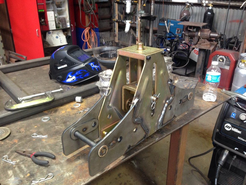

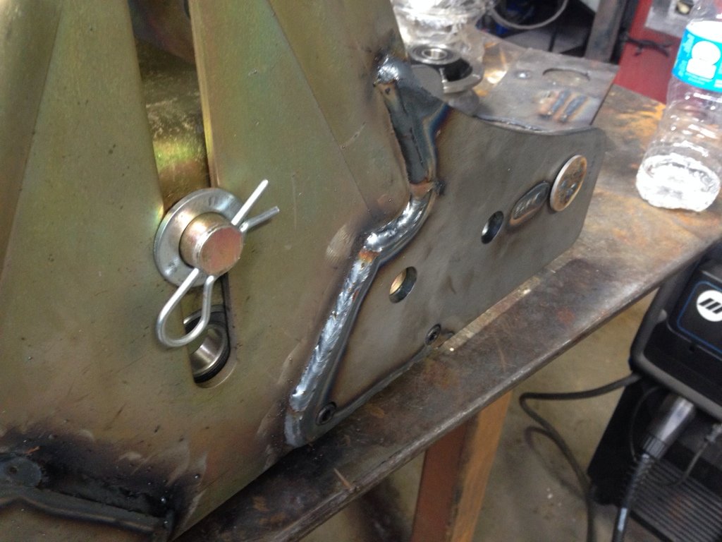

    Got the harbor freight tubing roller put together and welded on the SWAG roller extensions today. 2a4ama8a_8ca5d8ce624e1cb456badd89e82d6c9aa3599fff.jpg
