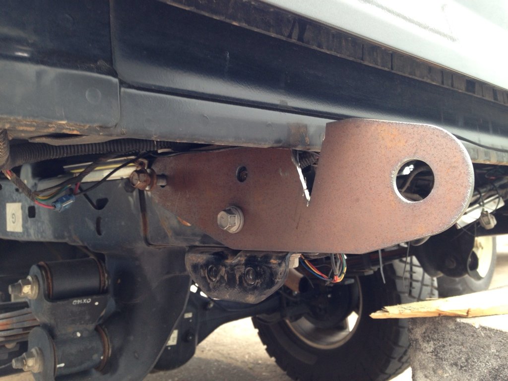

    Here is the recover point for the rear bumper.
    Just need to get a lesson on the cnc plasma and I'll get a mockup cut out for testing.

    Just a thought since you're planning this out. My bumper has a slot notch on the forward most bolt hole so you can have those bolts installed loosely. If you do that though I'd used the OE angle brackets so you can use the additional 2 bolts that are on factory tow set ups. The slot notch makes getting it on/off a breeze by yourself.

    That is something I had considered. My brute force has that feature. It will be harder to install, but I'm going to stick with the three bolt design and have the forward hole captured. That will gain me another couple inches of clearance. The factory angles will be removed.

    Thought I could build the new bumper without removing the bed, but turns out it's going to have to go first. These are my mockup recovery points. 7asy9y4u_2275c6dac207c0d410e68ff382ce502d84cf95e7.jpg

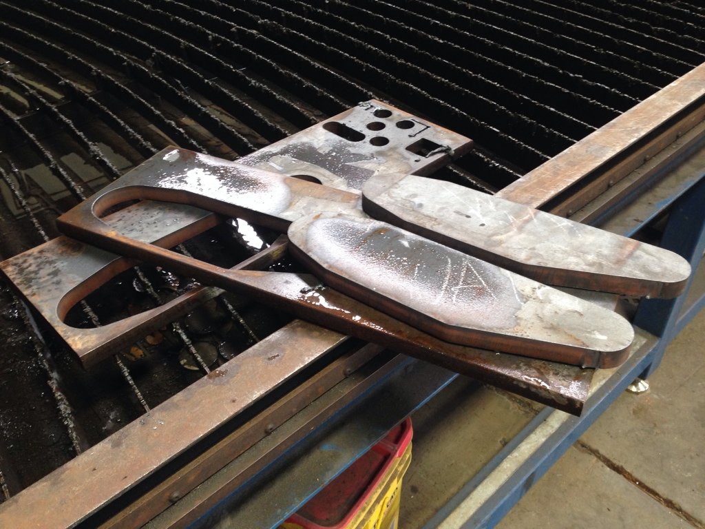

    Found out that the plasma cutter at the shop had only a thirty amp service which meant that I couldn't cut the 3/4 plate for the recovery points.
    I tried an edge start with a 65a tip, but that wasn't enough for a clean cut. The breaker tripped halfway through the practice cut as well.
    So today we ran 6 gauge to the plasma and a 60 amp breaker. Problem solved!
    I will be drilling the holes on the mill for more accuracy.
