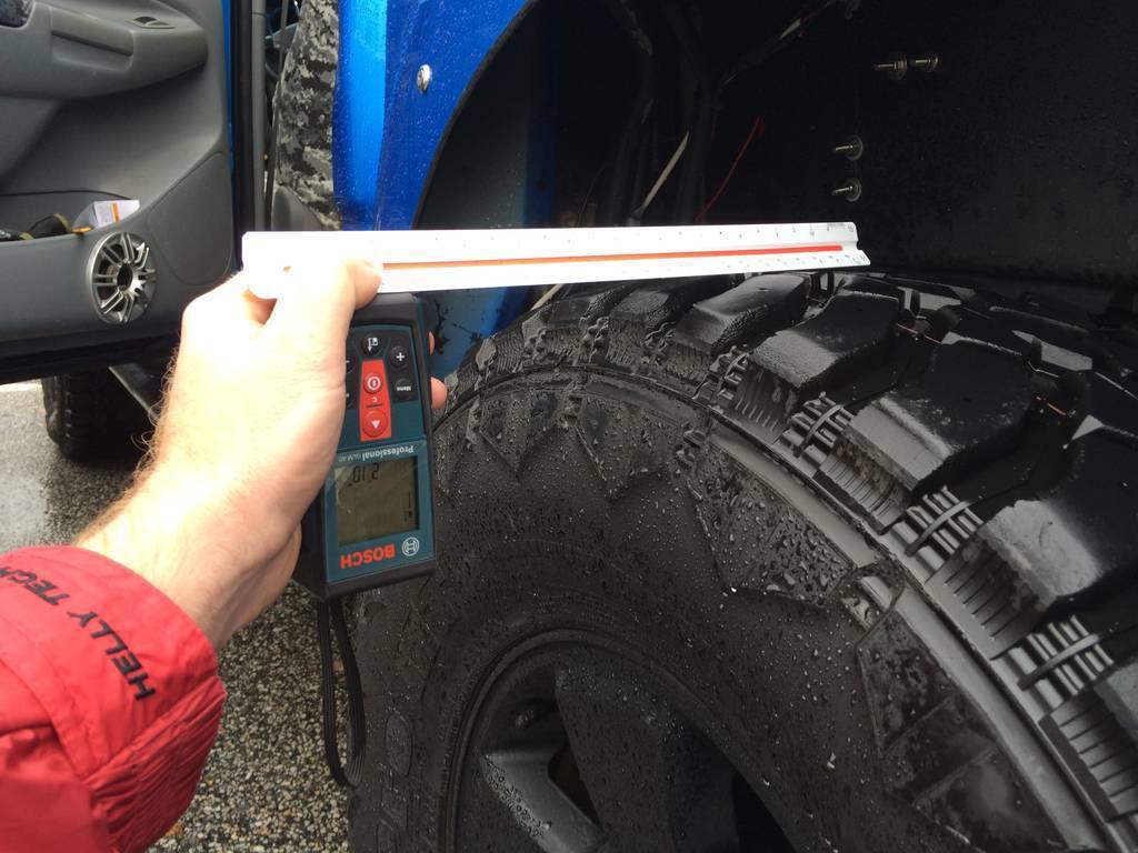

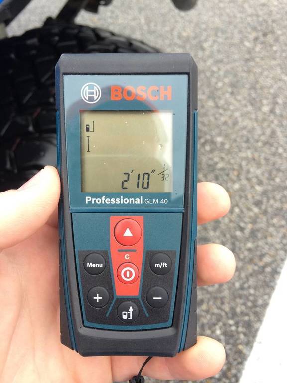

    Build thread in sig... 4-link long travel
    took a measurement over lunch.
    this picture is for illustration purposes only. when I actually took the measurement, i measured the level of the ground i was parked on, and matched the level with the ruler. i just don't have enough hands to take a picture with the level in place.
    laser range finder is measuring from the face of the scale, not from where the laser comes out of the front, so the body of the range finder is accounted for.
    and here's the actual measurement. at a fraction over 34'', it would make sense that one would measure 35'' unloaded, and without 15,000+ miles or wear on them
