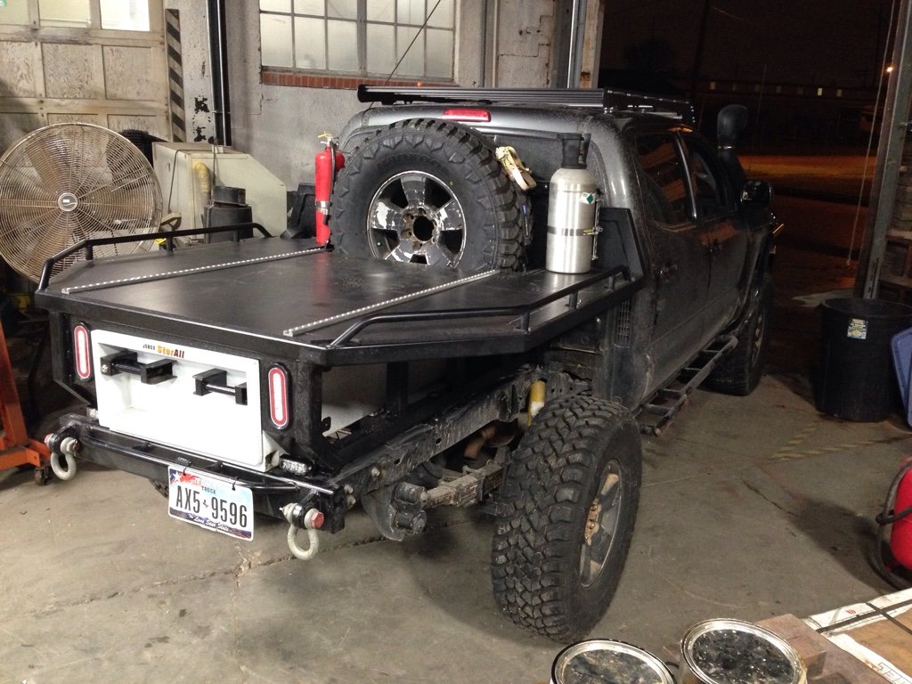

    Gonna be a little different than the grabbers, huh?
    Looks like my cab mount may need some additional chopping.

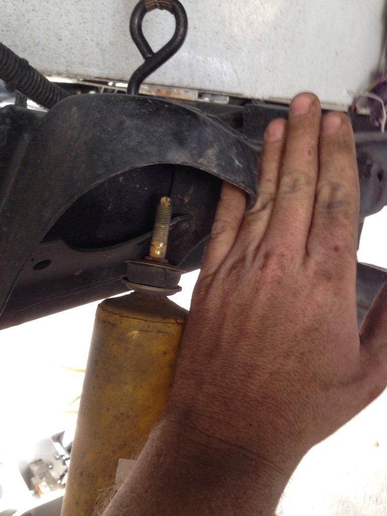

    The shop is hosting a welding class this morning so I can't get anything done on the bed until 1:00. So I installed my Dakar add a leafs this morning. So much easier to do when there's not a bed in the way. :D
    And when I get back from holiday I'm going to address the rear suspension. The OME's have served me well, but they severely limit droop. I could have dropped it more, but a couple of wires need to be lengthened.

    The Dakars moved a lot more than I thought they would. I'm thinking a shock hoop with a 14" shock coupled with a shackle flip will yield fairly impressive results.

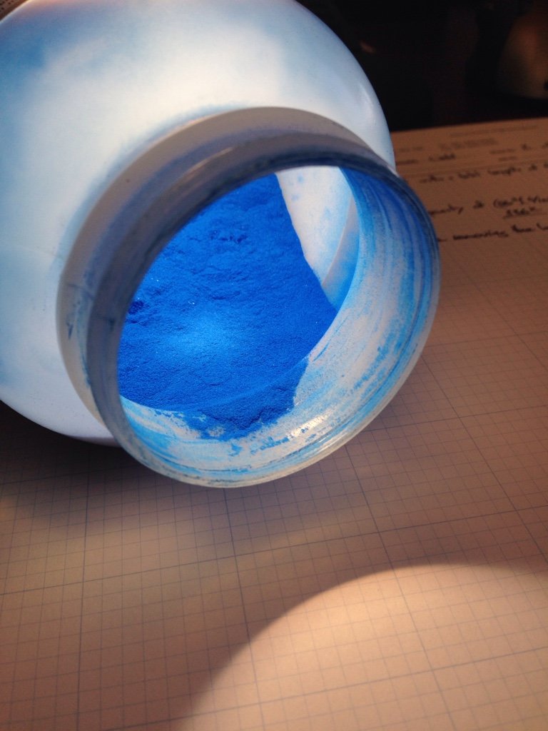

    Hmm... New powder for the skids?
  12. Dec 16, 2014 at 12:43 PM
    #752
    Manwithoutaplan
    Manwithoutaplan the full Monty
    Jan 30, 2008
    #4500
    54,633
    ID
    blue cocaine instead of white ...nice. Pablo will be very proud
