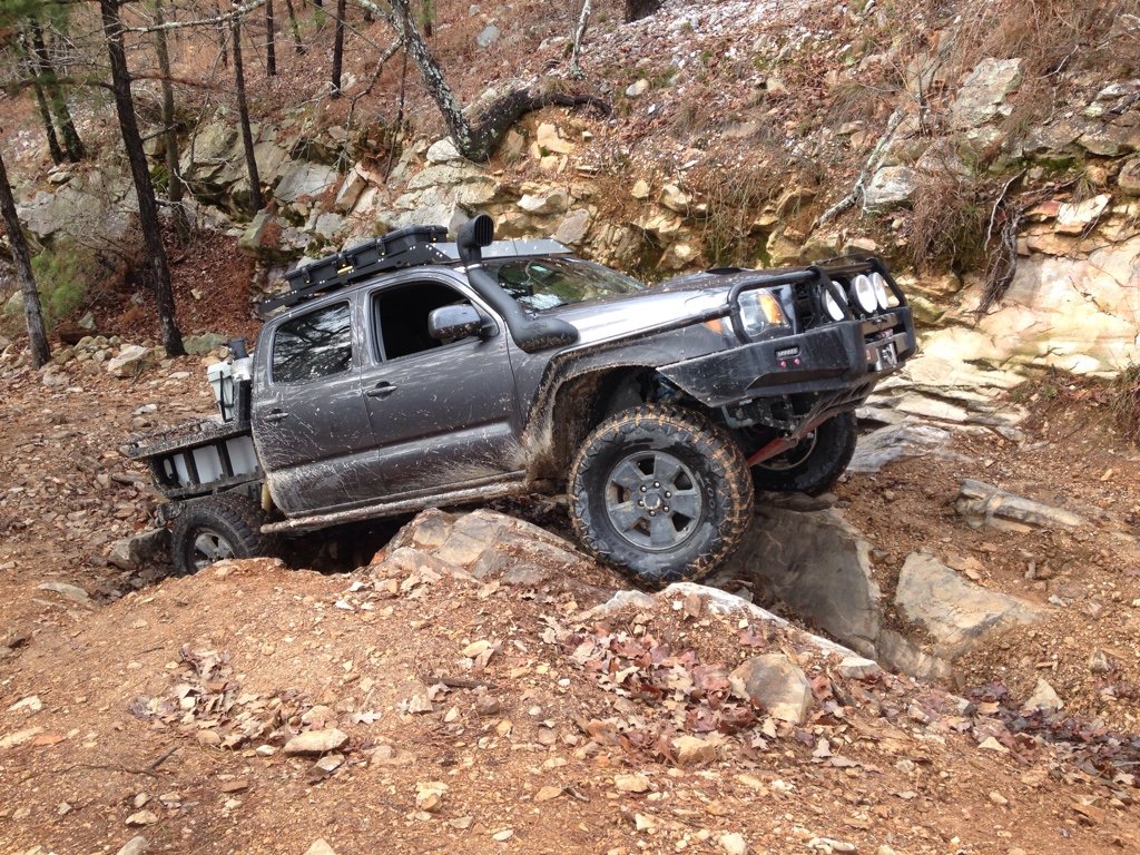

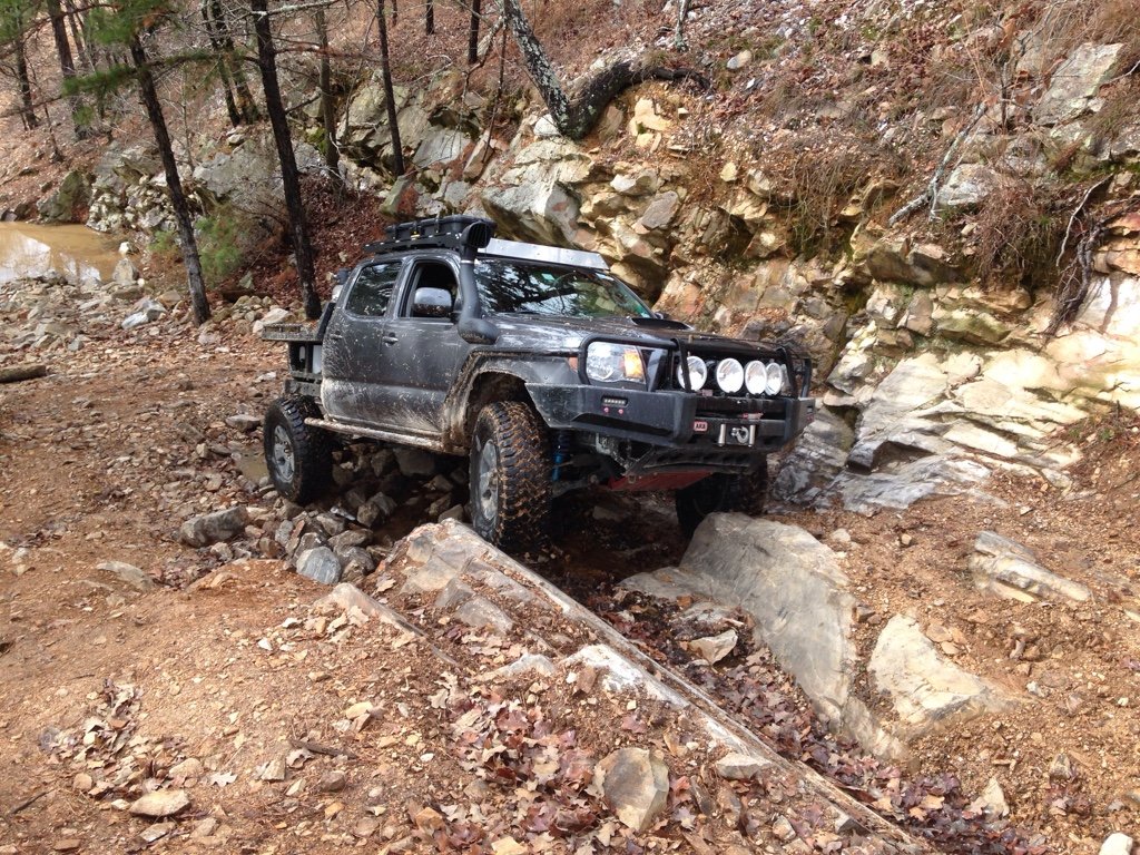

    Ok Snorkie. Lol, we tried all the lines. They all lead back to the ruts in the trail.

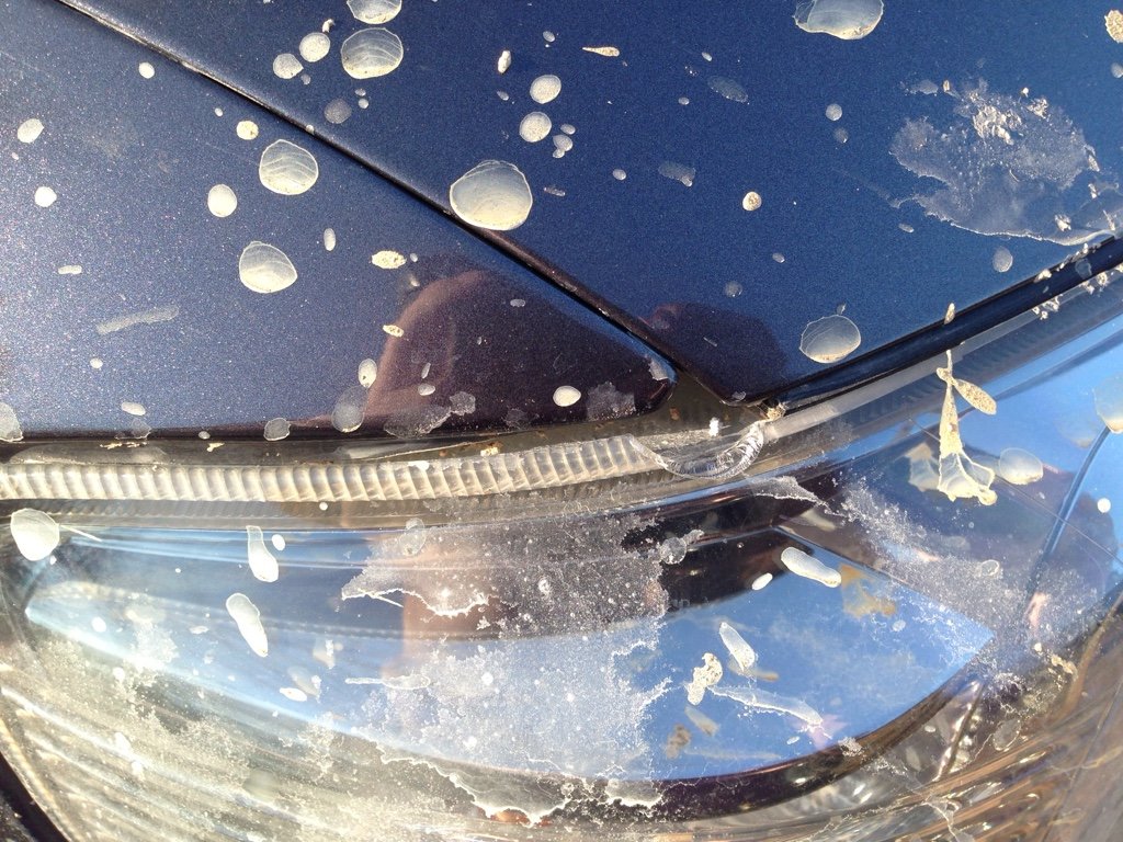

    The passenger side fender introduced itself to the headlight.

    Looks like it wants to introduce itself to the hood too. I'm guessing the tire keeps reintroducing itself to the fender.
