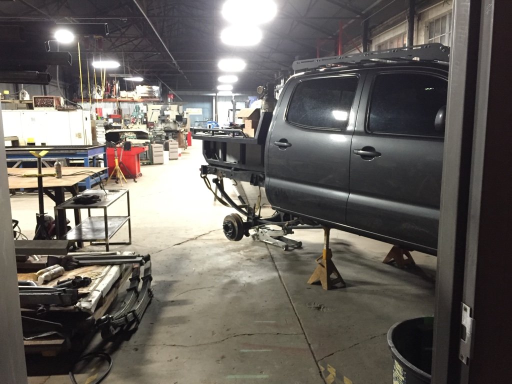

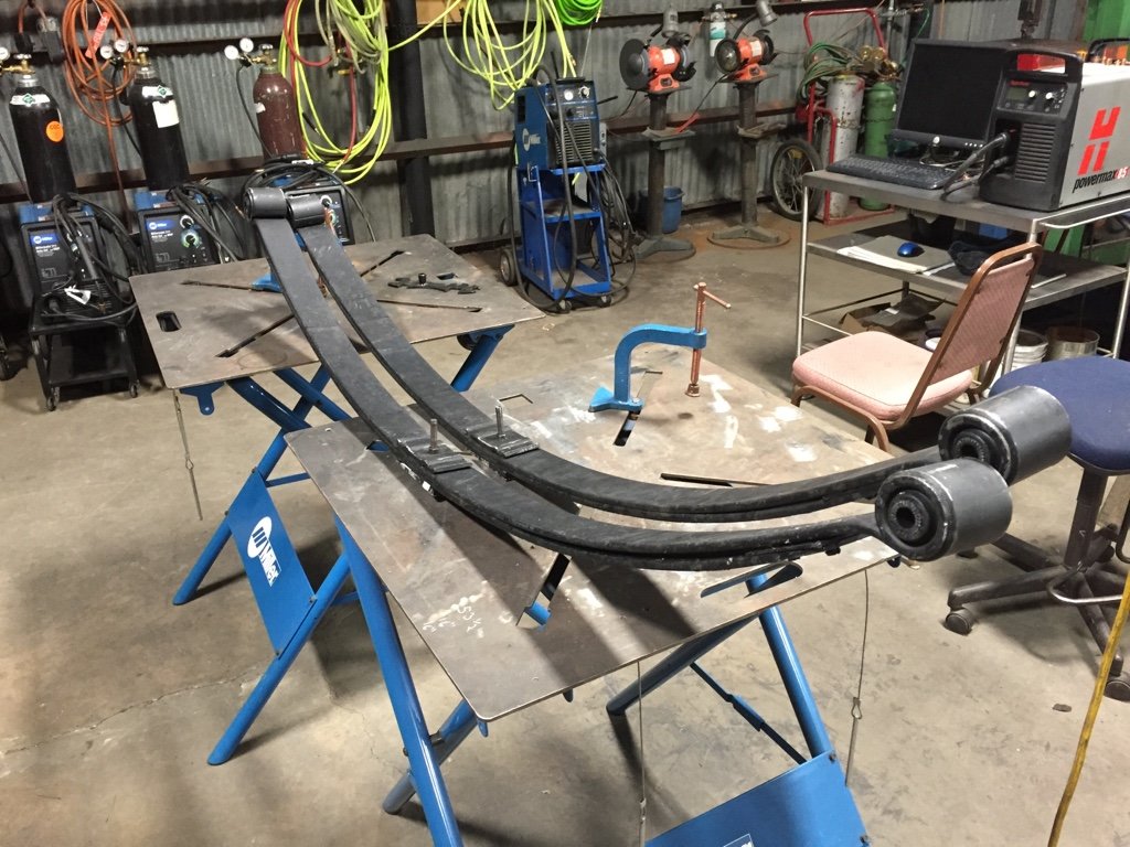

    Time to get started. 259dcc578d5dfdff106f50dbc1a67a9a_0fa1087a703fd1e8e272462ca1974eddf0e6229b.jpg

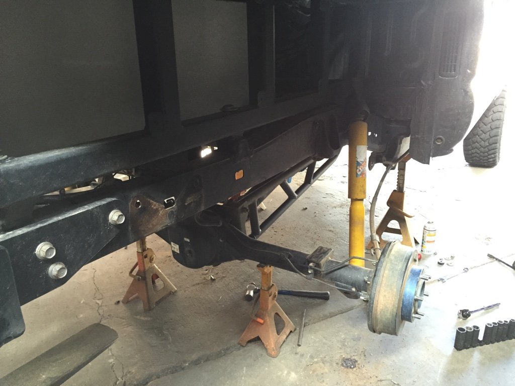

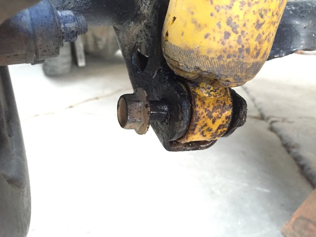

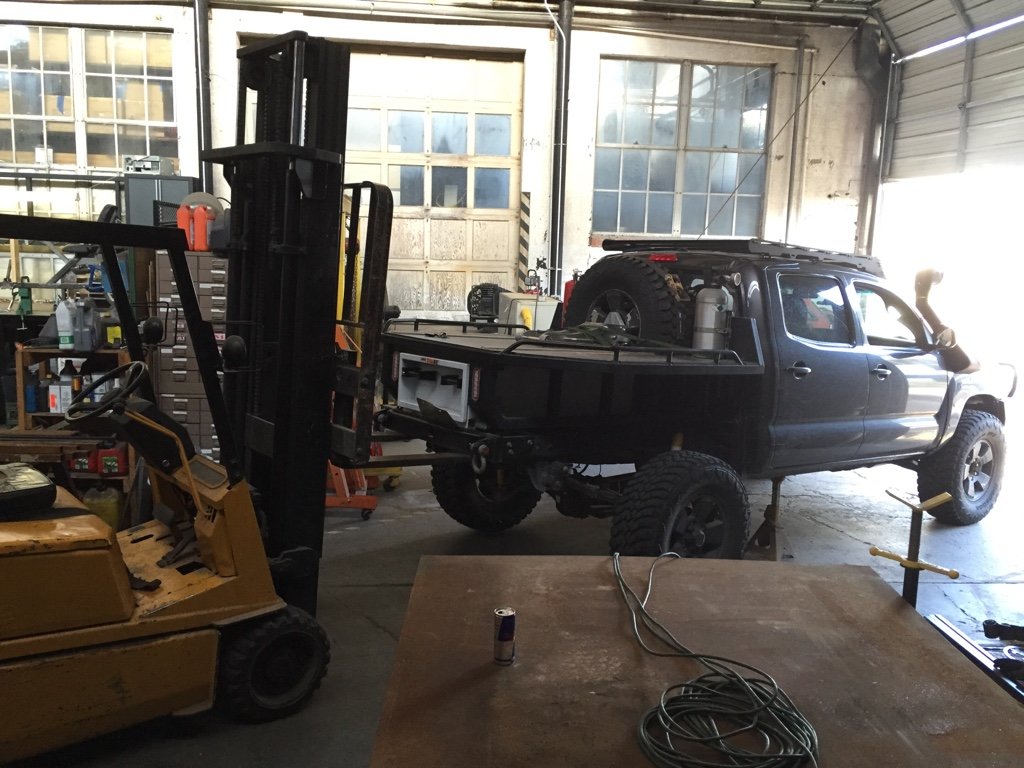

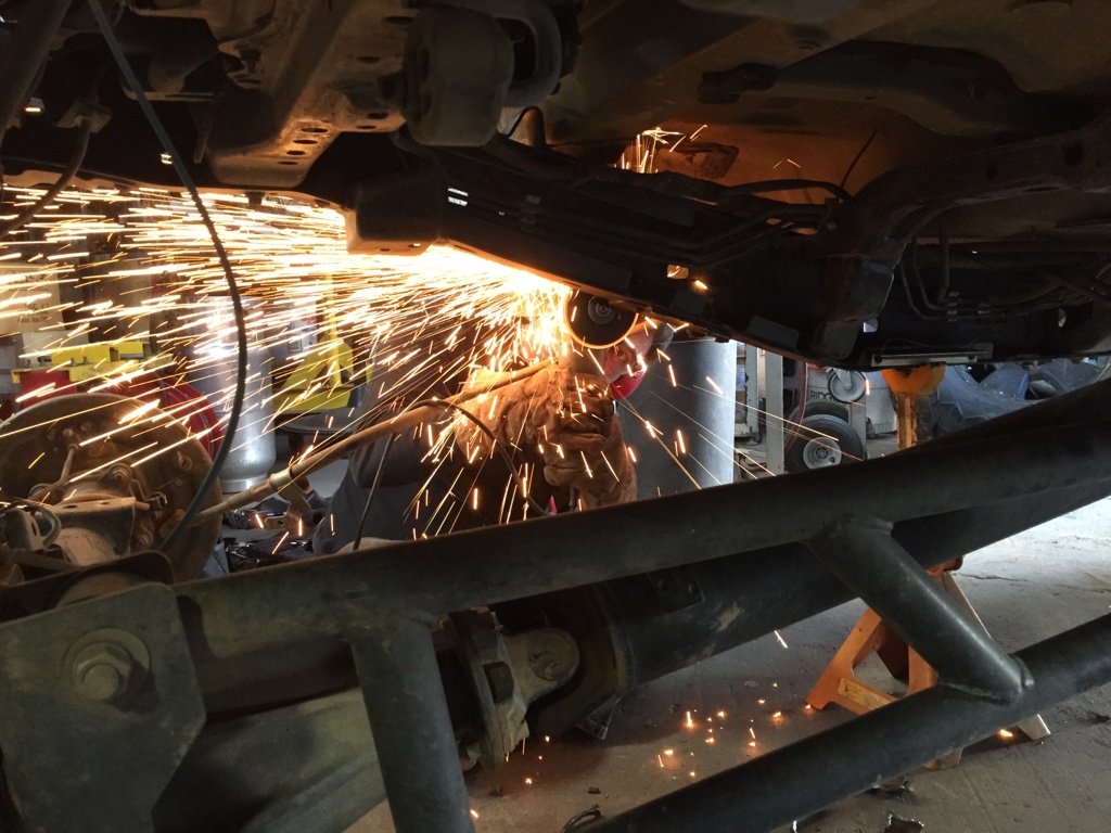

    Making room! I also pulled the muffler.
    Damn stupid stuck bolt!
    Rear hangers out and ready to start cutting the front hangers out. Lol, the trucks not moving till I'm done.

    Had to go out and buy new 5/8" bolts as the skyjacker leafs have two different size bolt holes in the bushings. Starting to lay out the front hangers now.
    Phill lending a hand.

    Well, that's all for tonight. The front hangers are tacked and the springs are in place. I'll get the rear hangers tacked in tomorrow morning and see how my dimensions worked out.
