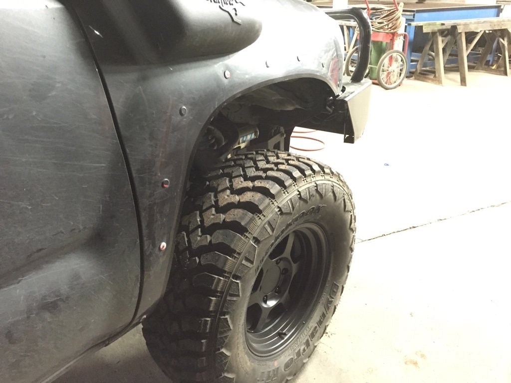

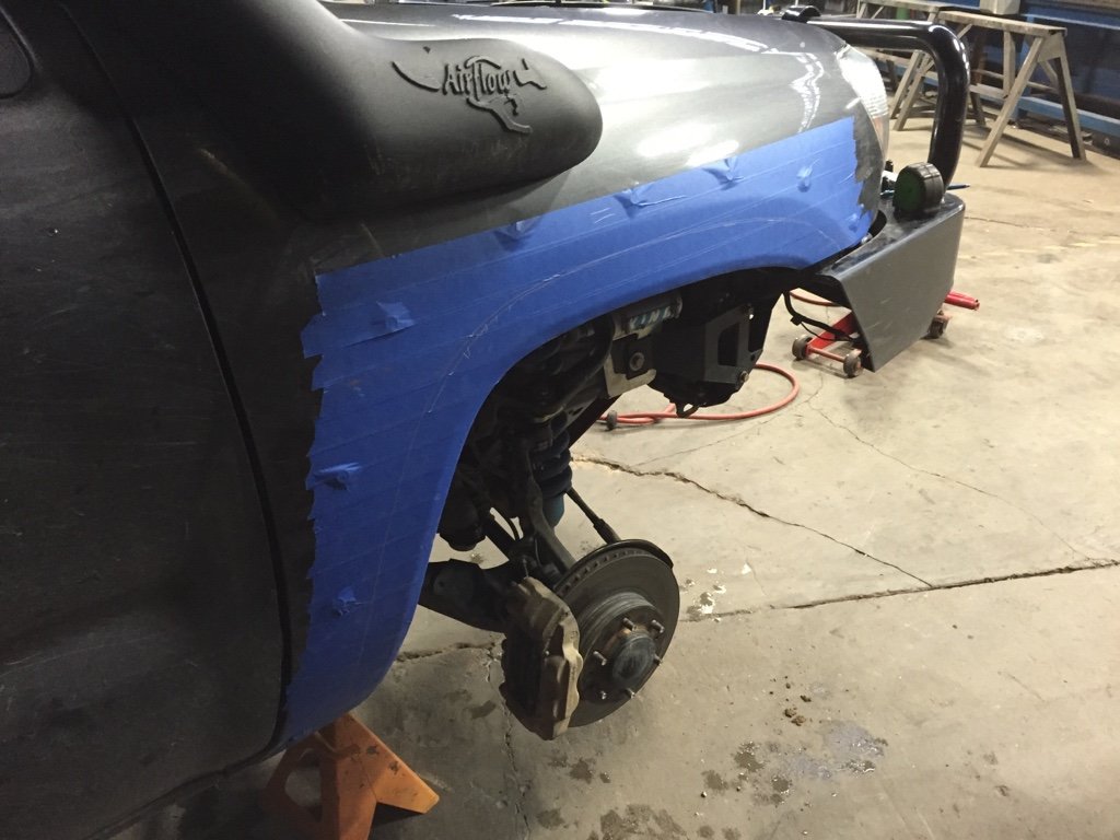

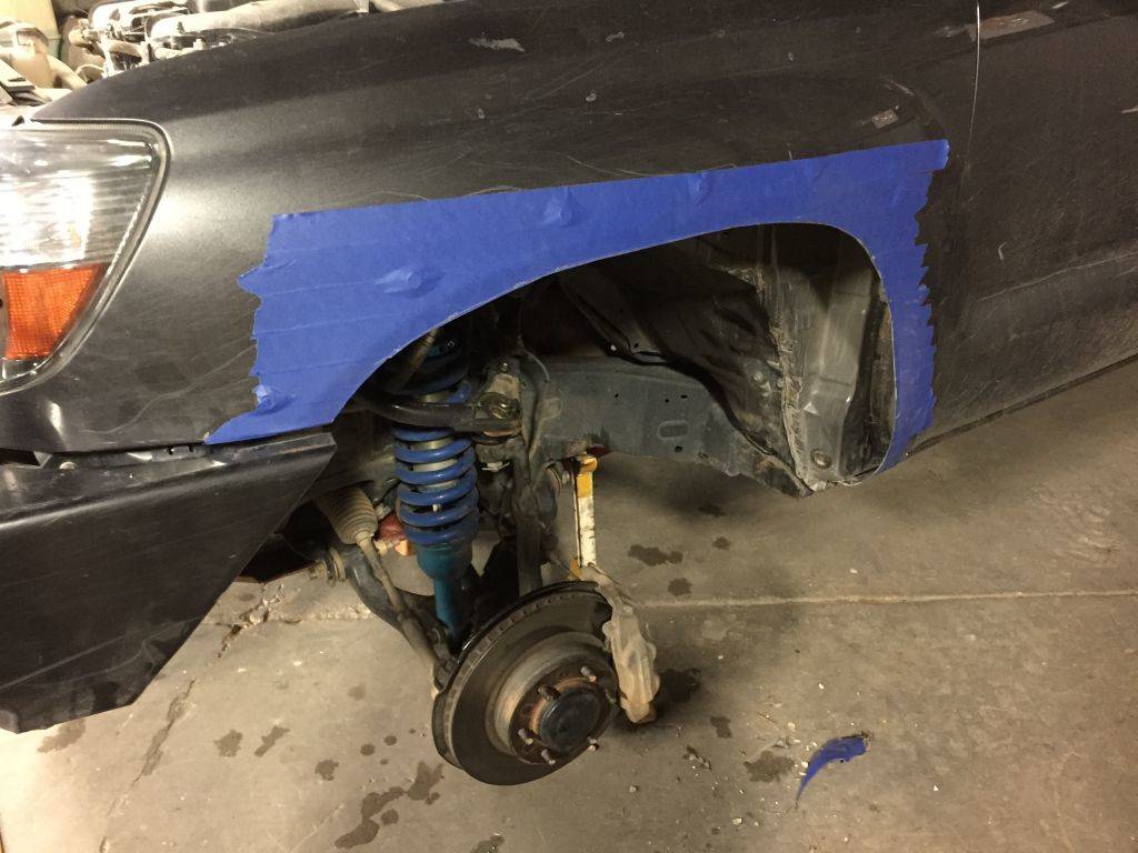

    Trimmed a tiny bit off of my fenders tonight. I also took the same amount out of the ARB. This is the second time I've trimmed the ARB. I'm pretty sure I've taken five inches off of the wings.

    Sold...
    So with no liner, do you have any trouble with dirt on parts that should be avoided?
    Also, what did you use to trim your fenders and bumper?

    Well, the only thing that's under the liner that you have to worry about is the intake. I have a snorkel, so that's not a problem anymore. The trim on the fenders is just autozone panel trim.

    I think he might have been asking what tool you used to cut the fenders.
    Common choices are jigsaw, angle grinder, and dremel. I saw some guy on here that used some heavy duty tin snip things and had great results, but I have no details for you.

    I see said the blind man. Originally I planned on using a jigsaw, but mine crapped out on me about four inches into the first fender. I ended up using a grinder with a cutoff wheel. Worked pretty well, but you have to be careful with it.

    You'd be at it a long time with a dremel. I'd say skip that and go with either a jigsaw or a grinder/cutoff wheel.
    You're not going to hurt anything buy taking the rear liners out.
    The front fenders have a good amount of strength left when cut, but the rears need support. The link above has some good options.
