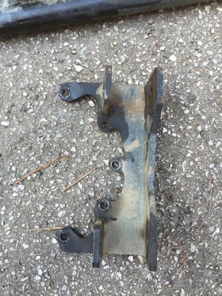

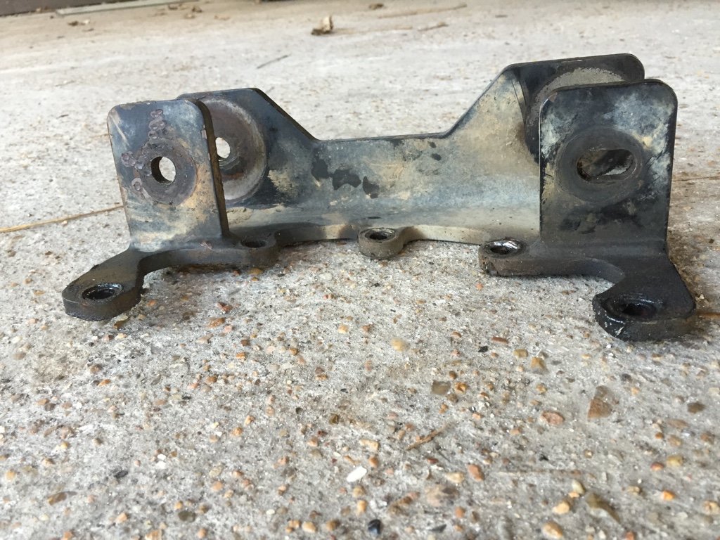

    Found a new issue today. My ATO traction bar, which bolts to the rear diff studs has managed to shear off one of the studs on the housing. I'm going to try and find stronger studs and replace all of them now
    Also need to make a new traction bar, and one that welds to the axle.

    That's not supposed to be bent.

    Being an engineer and access to the stuff you do, I wouldnt just weld the mount to the diff. That would make trail fixes a PITA if you wanna swap in that spare 3rd you got. Why not just truss the axle and design a mount that's spreads the load out more throughout the mount and have a few more bolts to reduce the stress on them as well ? Or something like that. Welding it just kinda sounds like a way to 'rig' it and is something I'd do. Not something you would do after all this time you've put into trying to build yours right.

    Kase, I'm not going to use the old bracket. I'll build a new bracket that will sit to the passenger side of the diff itself. A truss is a decent idea, but I wouldn't want to build a full truss without anything else planned for it. I will have to change the muffler out to one that's smaller in diameter though. There isn't room with the stocker.

    Good looking out Kase. I'll be mocking up a bracket tomorrow and cutting it out of 3/8. I think you'll approve.
