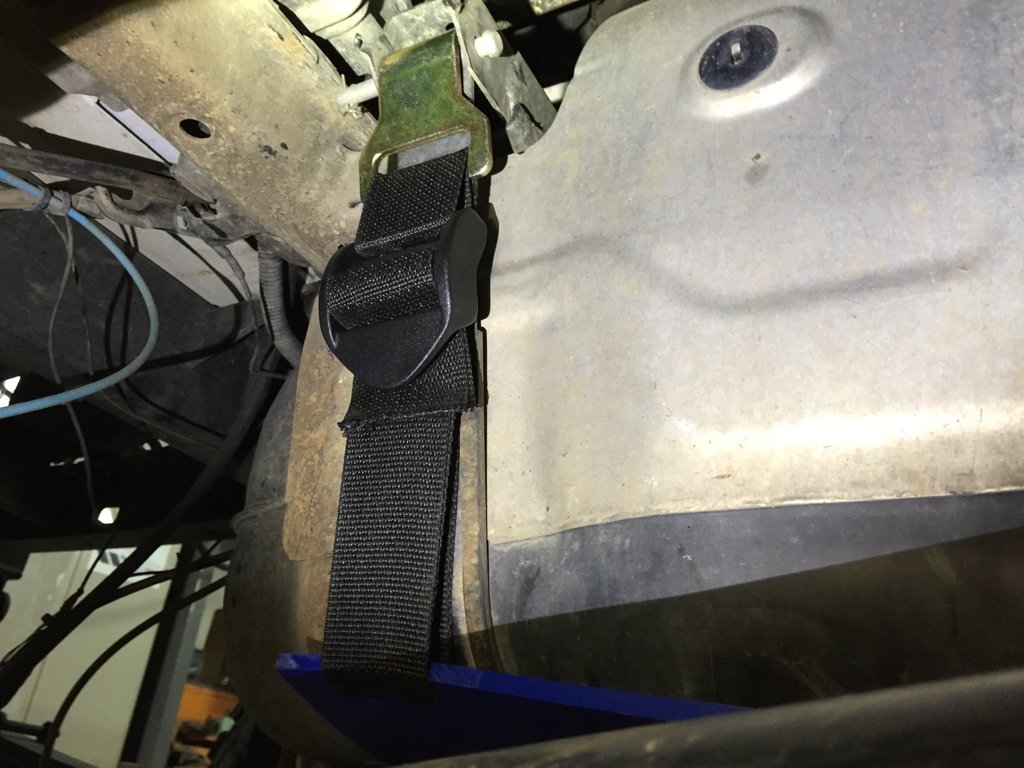

    That's a sweet skid Nathan, put my name in the hat for one of those when you start getting some made. How is it held on the sides under the tank itself?

    Thanks! It's held on with straps to the gas tank hangers.

    I'm switching to a cam buckle instead of the regular buckle shown.

    Nice! Simple and effective, how much does that piece of uhmw weight? also thanks again for those leaf packs, truck rides like new now.

    The skid weighs about eight pounds, lol. The steel skids weigh more than 40.

    I like the cloth strap idea... I made some metal bars with bent ends and one tapped side to latch on where the stock straps sit. This is on my Ford though

    are you concerned with the straps fraying/breaking if they get run over a rock?

    based on all of the scars on my steel gas tank skid, his straps do not sit in an area that is exposed to rocks and debris. if you hit a strap with a rock hard enough to damage it, odds are, you're going to be replacing your drive shaft from the same hit. being 1/4'' UHMW, it will also flex upwards where obstacles contact the skid, lessening applied pressure, especially around the edges.

    Any concern with landing on an obstacle and the skid starts to indent the gas tank or whatever engineer logic makes sense with those words lol

    The areas where the straps sit also wrap up on the sides of the tank. Even so, if you rip one you can just re string it with a piece of webbing and be on your way.
