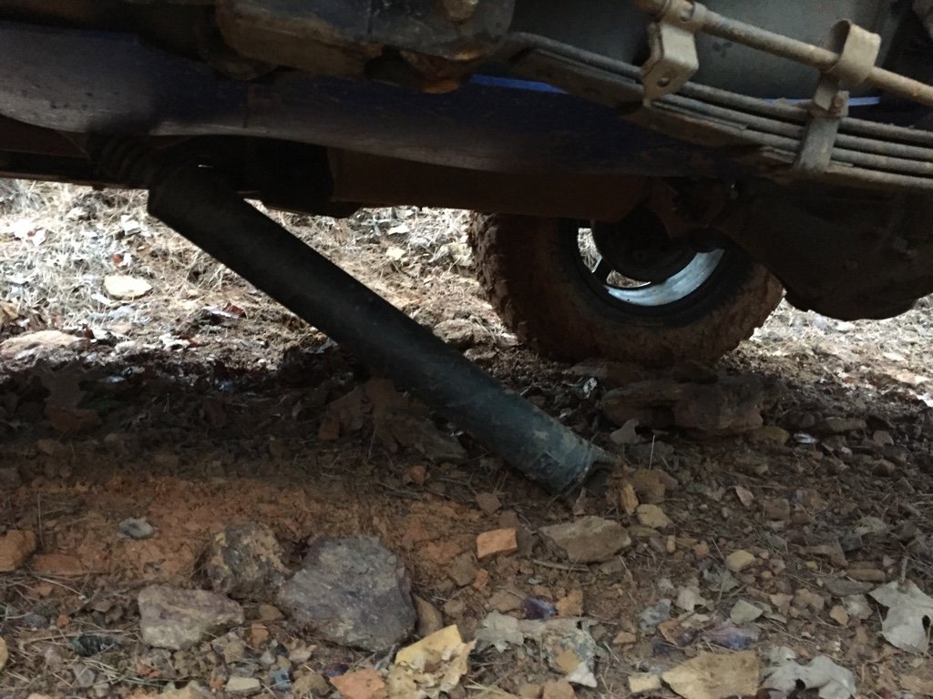

    No, it's not good. The axle wrapped hard enough to break the rear flange on the driveshaft and bend the leafs into an W. I'll be starting on my trac bar and ordering parts tomorrow.

    Need to build my traction bar so I won't have this problem again.
