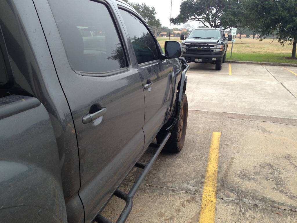

    We ran a little short on time, so Nathan will have to post thos photos of the final, painted product.

    Here is the information on the clamps that were used for the scrub bars.
    I would suggest calling ARB directly as their customer service is outstanding. I did however find this:
    http://www.rocoperformance.com/produ...roductid=17630
    You can search for "ARB side rail clamps" to find more vendors.
    $42 for the set of clamps, which includes four pieces and the M8x60 carriage bolts. I would suggest you source alternate hardware as the supplied bolts are weak. I'm going to replace mine with 5/16" grade 8 carriage bolts from here.
    http://www.fastener-warehouse.com/Gr...olts-s/418.htm
    Thanks for posting the pictures Colin, I was about to copy them over from your build thread. :)

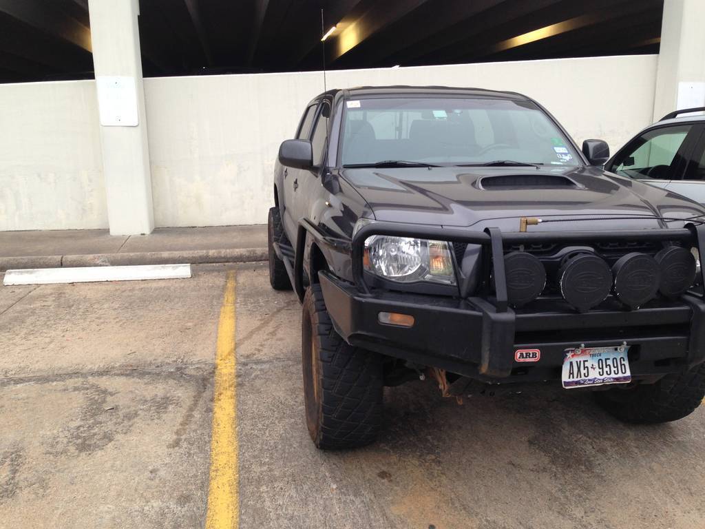

    Man do I need a garage! I painted the scrub bars by flashlight after work today. We'll see if the paint is set enough to warrant bolting them on in the morning.

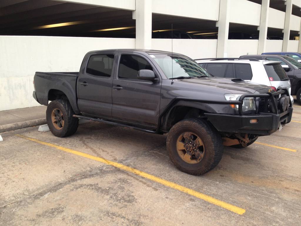

    I was able to paint the scrub bars last night. The truck needs a bath and my sliders obviously need a fresh topcoat, but here they are.

    I love it! ruffstuff clamps still fit together easily with paint on them?
  18. Feb 18, 2014 at 6:00 AM
    #118
    SMKYTXN
    SMKYTXN [OP] If it can't be overdone it's not worth doing Vendor
    Mar 11, 2011
    #52810
    14,040
    Nathan
    Houston
    11, 4dr, TRD Sport, 6sp
    DCFB
    Umm... No, they do not!
    Fortunately the paint isn't 100% cured. I took a chisel to the mating surfaces so they would fit together.
    I will tape off the mating surfaces next time.
