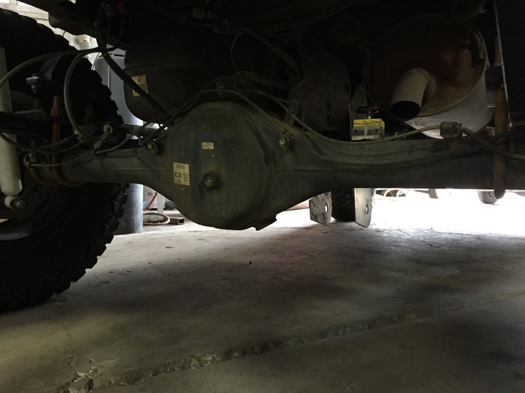

    I have 3-4" of up travel and 12" of down travel in the rear. The plan is to mount both shocks behind the rear axle with a slight angle towards the back of the truck and inboard.

    Are you running any sort of carrier drop? I just noticed on my u-joints the other that im getting contact at full droop with stock leafs :confused:

    I have the OME drop, which is basically two 3/8" spacers.
    Did you have both tires off the ground when you saw the bind? Typically the rear diff doesn't drop too much when flexed out.

    I've got some small spacers in there also. I just noticed it the other day re-torquing u-bolts. Thats exactly what I'm thinking..So im assuming I must have been at full droop (ass hanging lol). Going to check it out this weekend. I figured if anyone ran into this issue it would be you. Just cant wrap my head around the idea of the stock leafs dropping that low

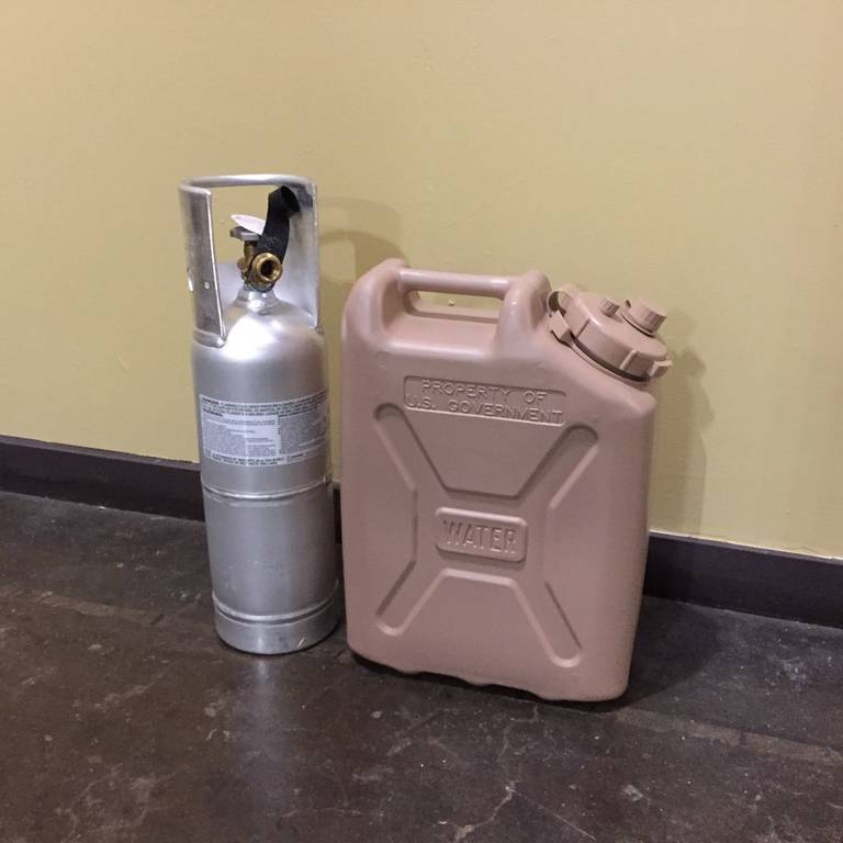

    Received some new gear for the truck today.
    6 gallon aluminum propane tank and a scepter water can. I have the matching fuel can on it's way.

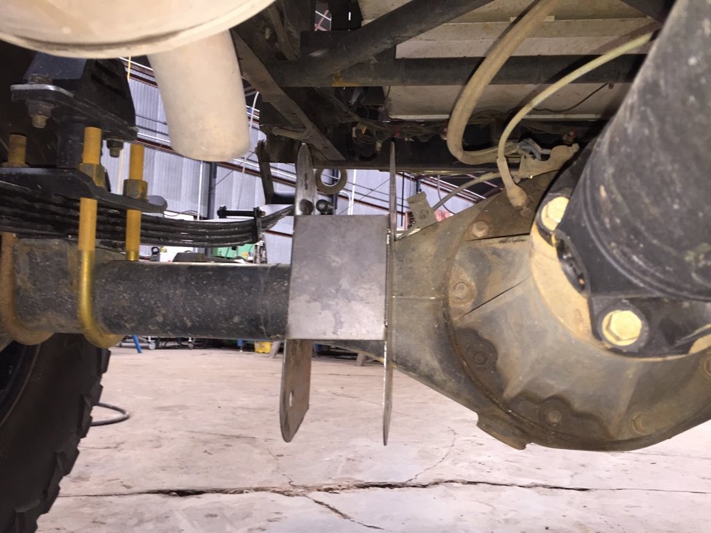

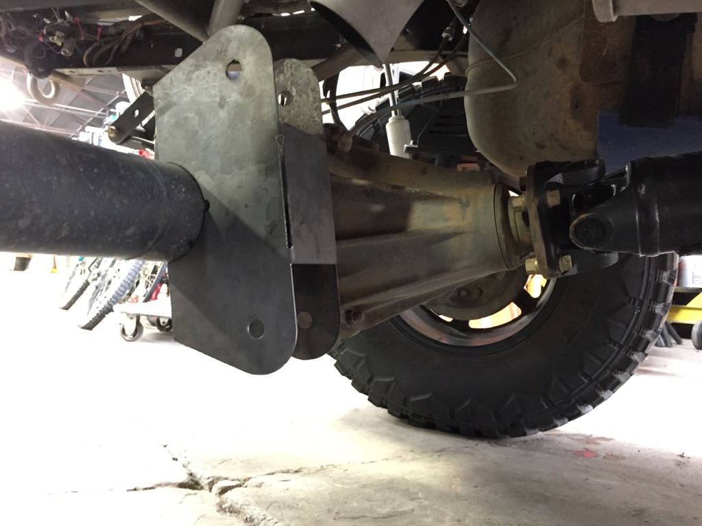

    Started working on my trac bar as well. 15843098146e1d1fabca4a8971ed43e3_b697520f84a0a500b0c1c72c95b7c3e47bd0b162.jpg

    Is that for mock up purposes? Kinda looks like I could bend that with my hands...

    :rofl: I guess I should have clarified that the pictures above are mockup pieces cut out of 14 gauge. :D
    I just wanted to confirm that my cut file was right.

    Are you losing ground clearance?

    The rear hanger doesn't extend past the bottom of the diff and the bar will act like a slider. Technically yes, but it's not a big deal to me.
