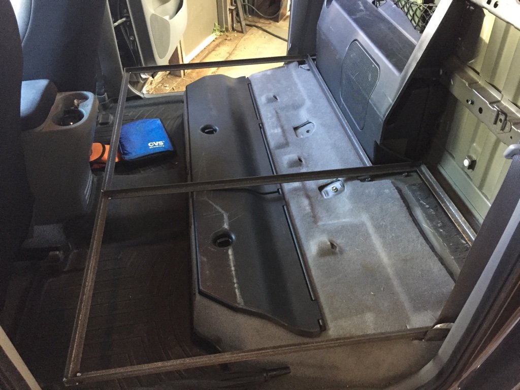

    Can't get rid of my tunes!

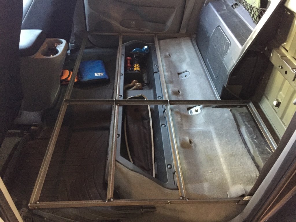

    Here's the main framing. I'll have two lift out covers to access the under seat storage bins.

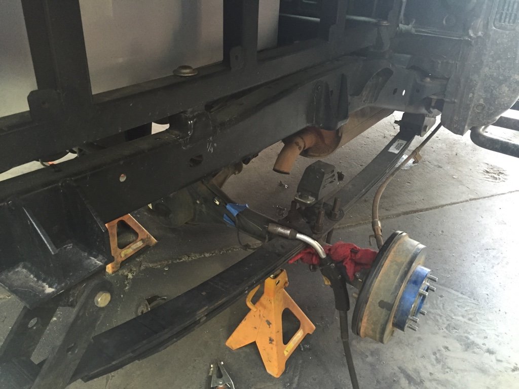

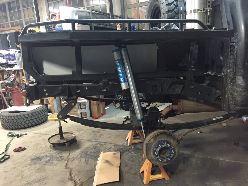

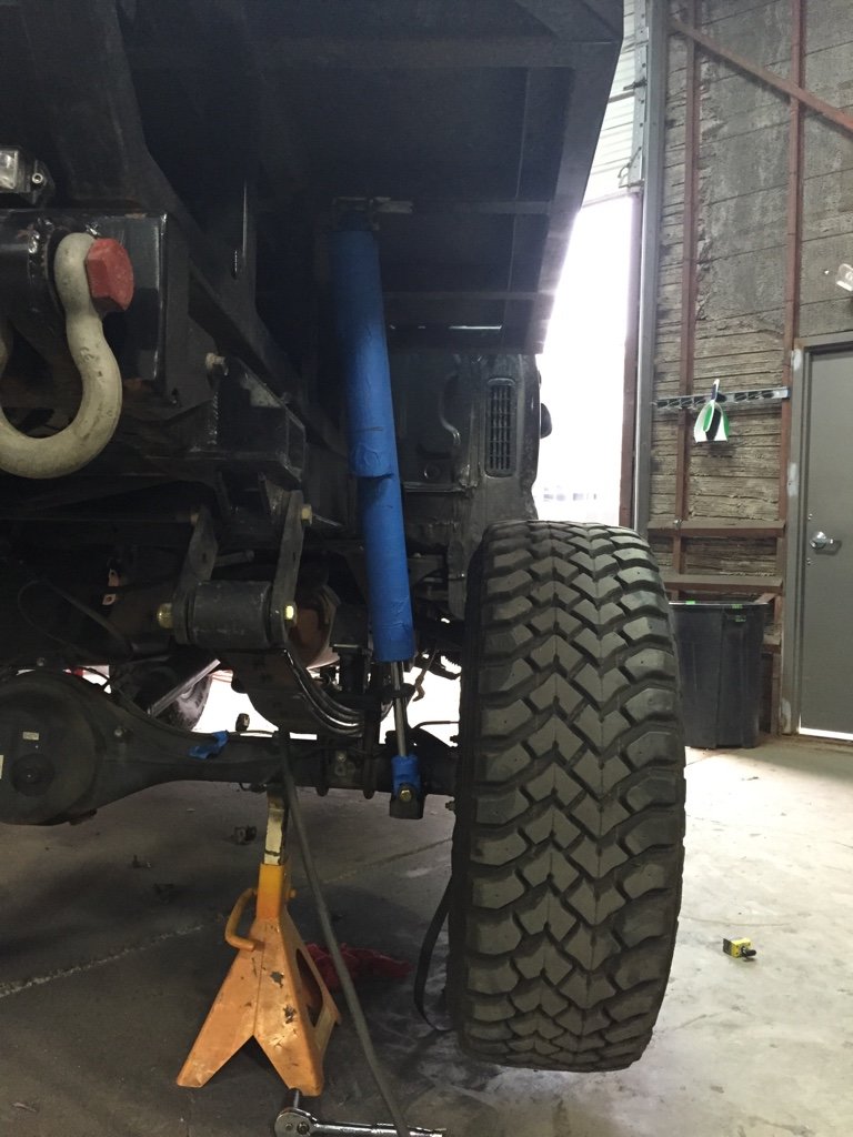

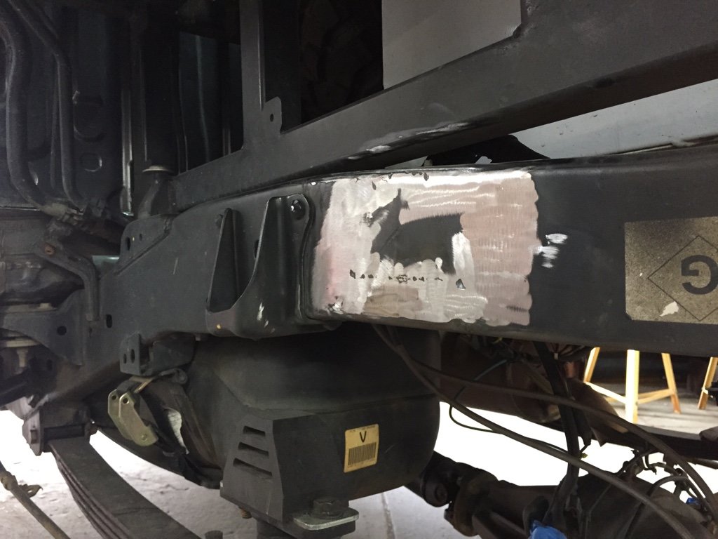

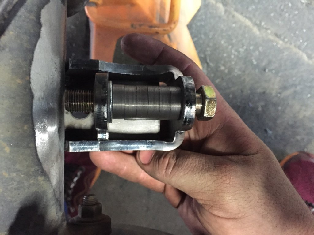

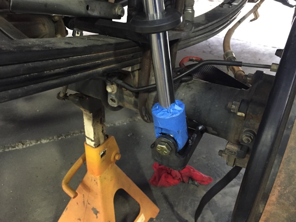

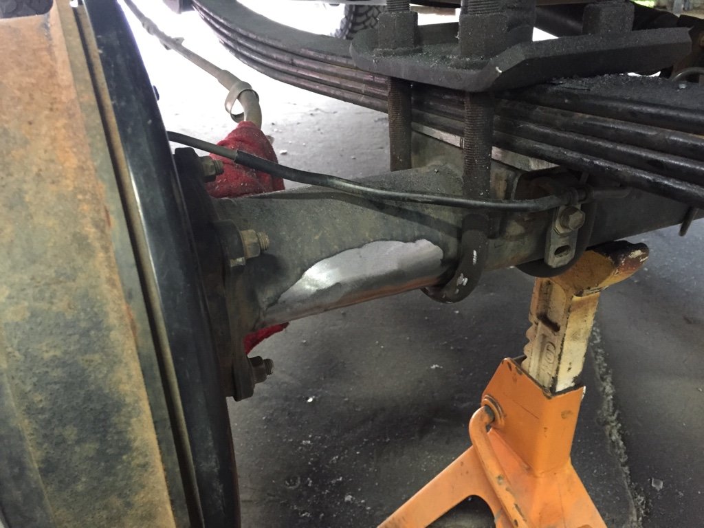

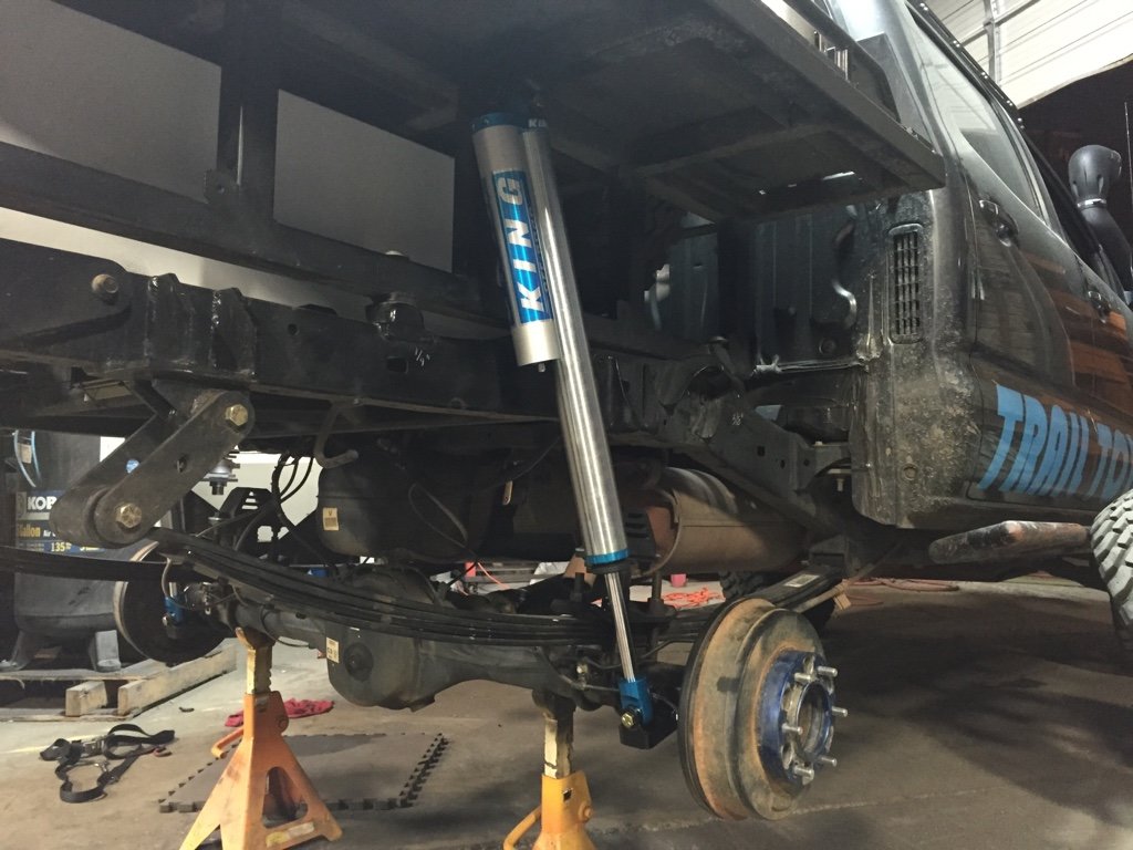

    So I got frustrated with the rear shelf and decided I needed to put my shocks on. My good buddy Jesse came over the shop today to help. I definitely needed another pair of hands and a second brain to help me get this done.
    I used a Ruffstuff lower shock mount. We had a few issues with the mount though. It should have been a little longer on the sides to allow the supplied bolt to fit. You can see here that it hits the frame.
    I also did a little machining since I didn't have spacers on hand. I turned down, and bored, a piece of sch 160 1/2" pipe for bushings. Each one is 1/4" thick. That also helped with spacing out the tabs since the shock eyes are 1-1/4" wide.
    The point of no return. No more stock shock mounts.

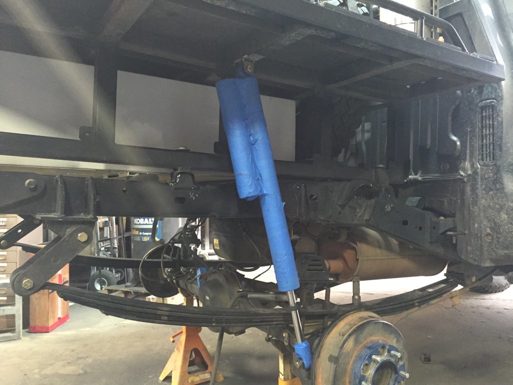

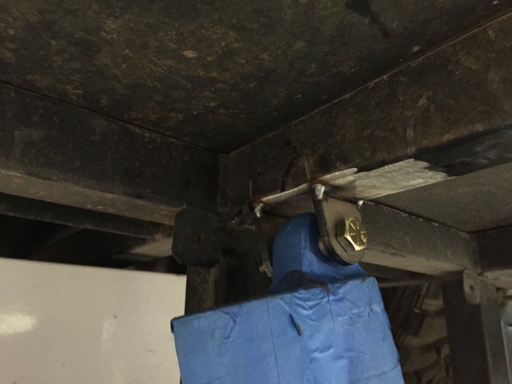

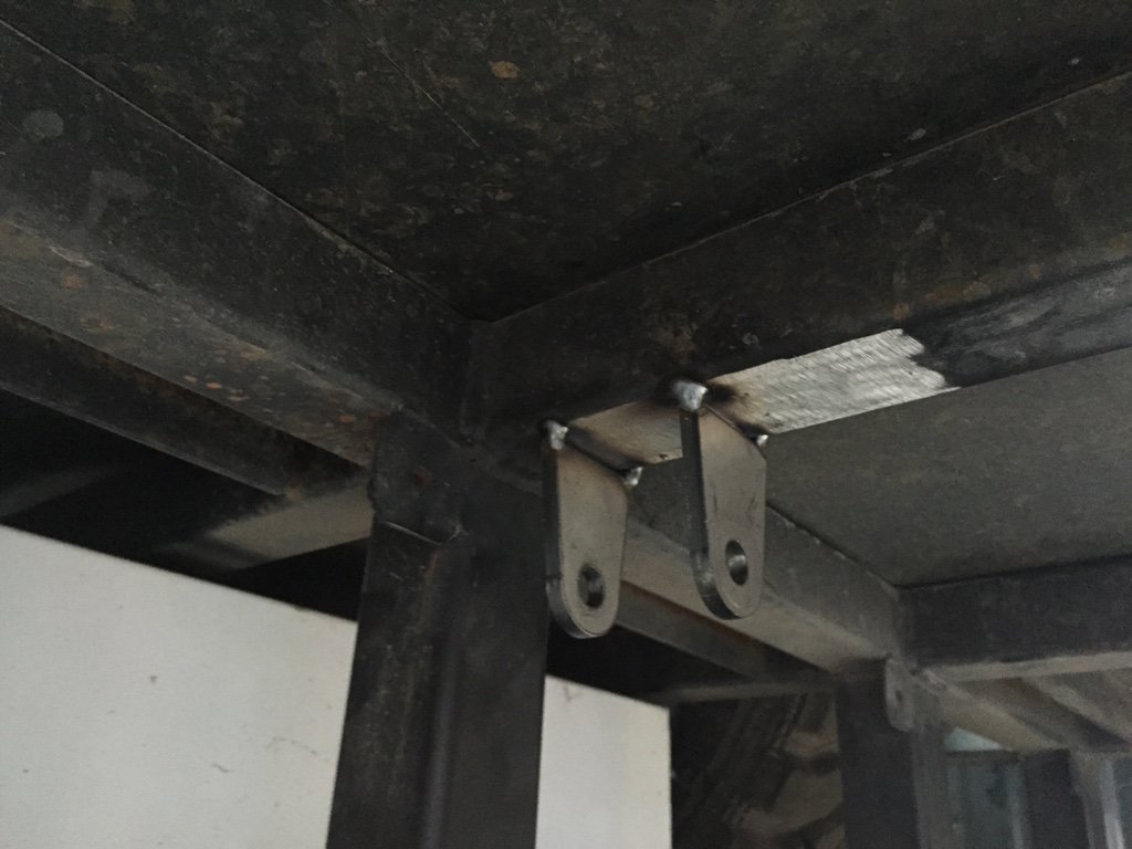

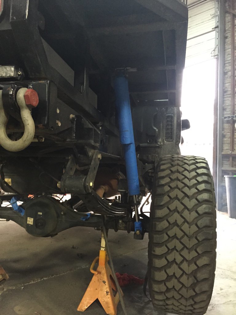

    Tacked on the upper shock mounts to the flatbed. Quickly realized they needed to be angled to get the lower shock mount to line up.
    First shock mocked up.
    Cut down the outside upper tab for the correct orientation.

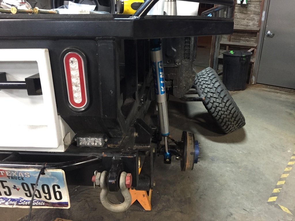

    With 4.1" backspacing on the wheels and a 1.25" spacer it looks like there will be plenty of room for the shocks.
    All welded up.

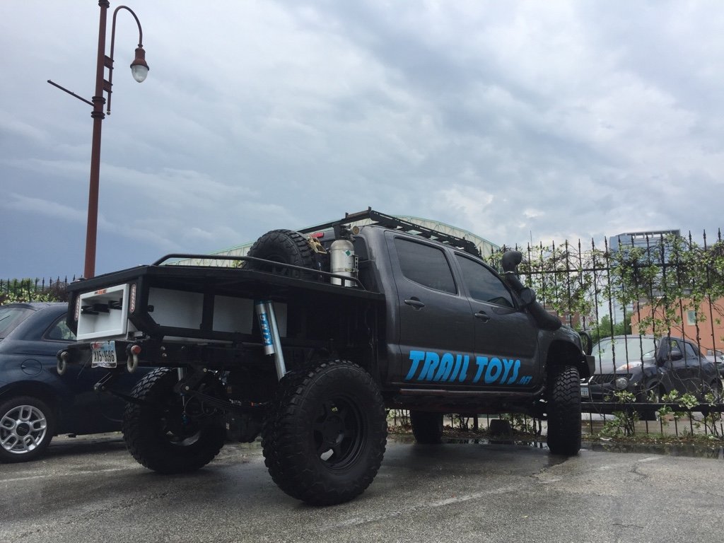

    I'll get the bumpstops knocked out tomorrow. I'm still not happy with the skyjacker leafs. I either sit too low and have frowny leafs or I sit to high. I've been adding and subtracting leafs to try and find the best setup. I may head out tomorrow and pick up a set of stock 3/4 ton chevy leafs just to see how they work with my setup.
    For now, this is how she's sitting. The rake is pronounced, but it's not quite as drastic as the picture makes it look.
