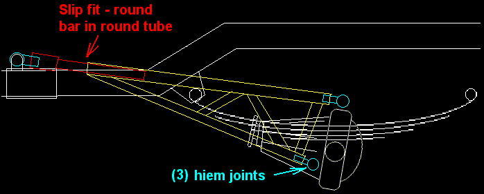

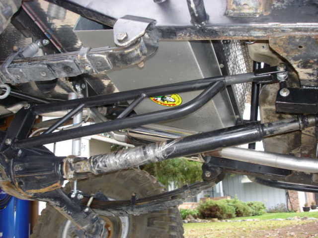

    '12 DCSB Supercharged 4x4 TRD Sport
    See Build Thread
    Any progress on a traction bar setup? I'm starting to eye brackets and heims now. I need one bad.
  15. Jun 17, 2015 at 6:39 AM
    #1355
    SMKYTXN
    SMKYTXN [OP] If it can't be overdone it's not worth doing Vendor
    Mar 11, 2011
    #52810
    14,040
    Nathan
    Houston
    11, 4dr, TRD Sport, 6sp
    DCFB
    I still need to build one for myself. My holdup is that I've lost access to my old shop, so I'm dead in the water as far as metal fab.
    I am planning to build a twist-n-slip style traction bar though. With the amount of travel the rear axle has a traditional heim joint won't cut it. It will be very similar to this, except I won't have a shackle in the front. The front will me mounted with a heim joint and no shackle. There will be an inner and outer top bar. So when the axle rotates the outer sleeve will rotate on the inner. The outer will also be free to slip on the inner, but will still stop any upward movement. That will prevent my axle wrap. I just have to find a new spot to set up shop in.

  16. Jun 17, 2015 at 6:44 AM

    Hmmmm interesting. You think the traditional design will limit flex with the 63's?
  20. Jun 17, 2015 at 7:24 AM
    #1360
    SMKYTXN
    Mar 11, 2011
    #52810
    14,040
    Nathan
    Houston
    DCFB
    I actually twisted my ATO traction bar diff bracket with OME shocks and Dakars.
