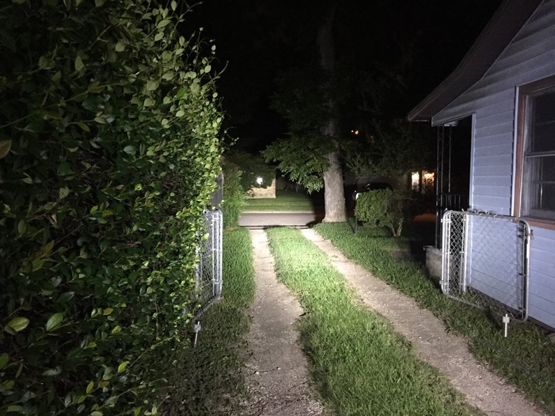

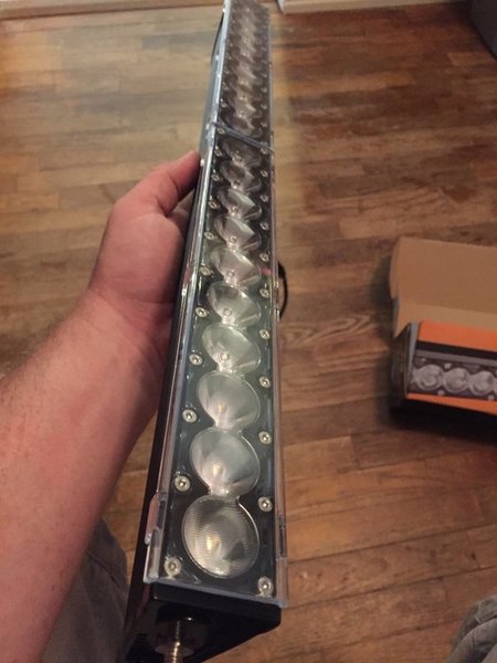

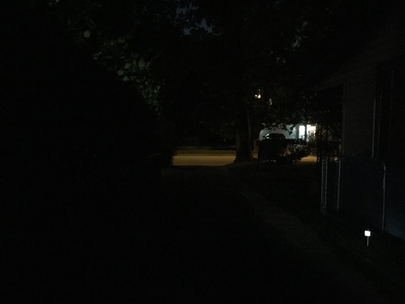

    Here's the 20". The 40" bars will be the same style.
    Before the bar.
    With only the 20" bar on.
    greeneggsnspam likes this.

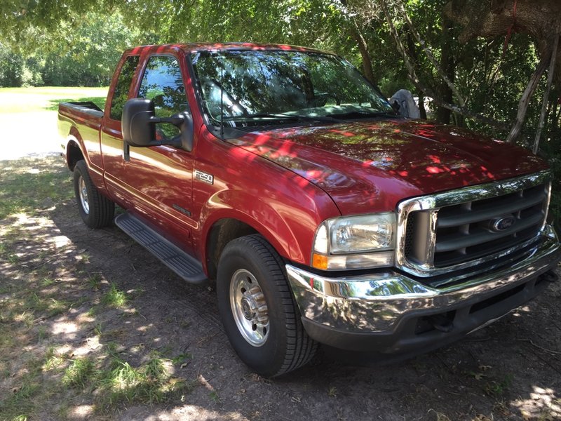

    It's official, Smokey has been retired from daily driver status. Say hello to Bandit!
  16. Jul 30, 2015 at 4:23 PM
    #1376
    geekhouse23
    geekhouse23 The "Liftman" - @DrFunker
    Jul 14, 2013
    #108251
    15,685
    2GMGMDCSB4WDTRDFTMFW!! TL;DR
    mostly stock, grocery gettin' Prius
    Nice! 7.3?
    SMKYTXN[QUOTED][OP] likes this.

    Yup, 2002 7.3 with 130k on the clock.
    Thanks bud.
