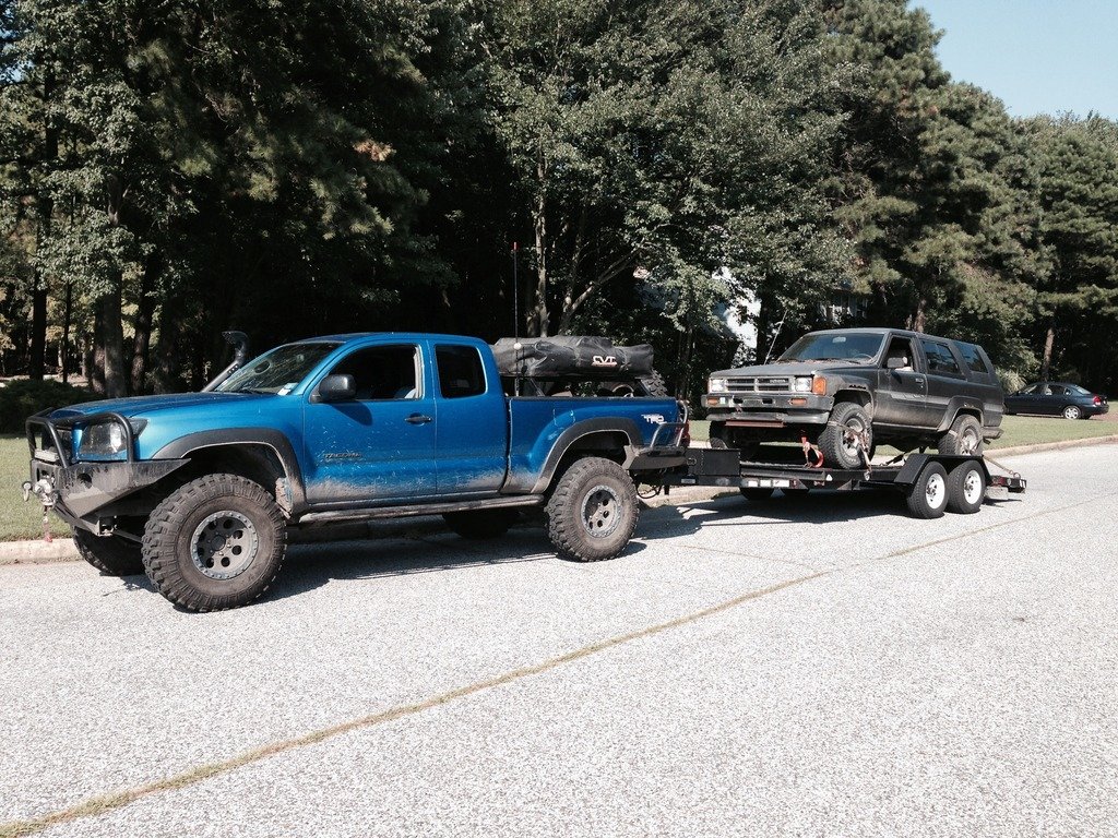

    I'll load Smokey up this weekend to figure out how I'm going to secure her. Any thoughts on securing the front IFS?

    Nice! Here's how we secured an IFS runner last week. 4 straps on each wheel, then one through the front frame and one through the rear hitch that were cinched down just enough to keep the suspension from bouncing around.
    FA0E971C-8DF3-4B40-9F31-D5CA7528BC01_zps_5462f6d120c07ddc336ab71f0108a840abc37d91.jpg

    I think I'll be able to get the rear axle tied down just fine, just have to figure out the front end. Your suggestion about going around the tires is what I'm considering.
    Something along these lines. Just have to find those nifty short straps with the loops.
