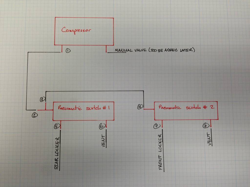

    Here's the diagram for the pneumatic switches. I'll have to get into it before I figure out where the bulkhead fittings will go. There will need to be at least one in the firewall for the main supply. If there is room below the center console to make the bend I'll put the remaining air lines through the floor.

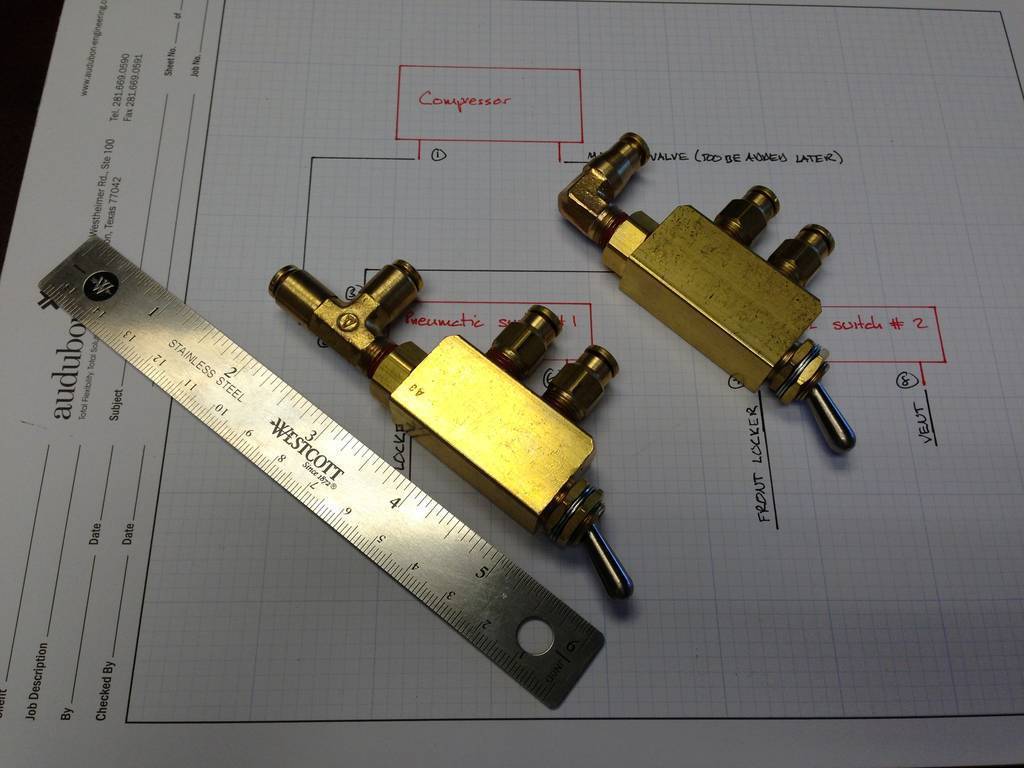

    DCFB

    thems are purdy. where are they going?

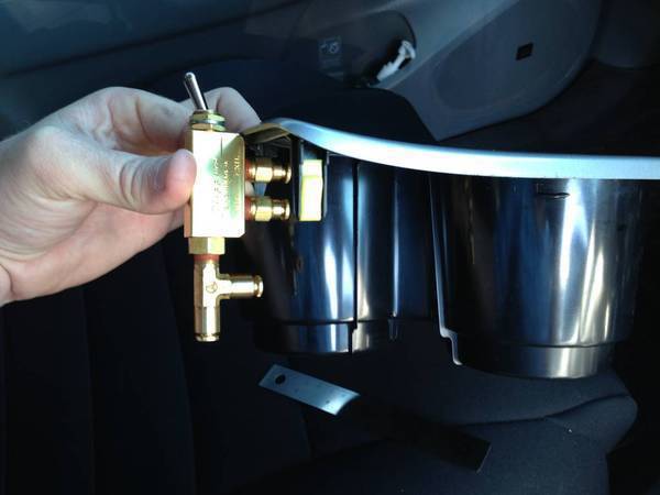

    I took a walk out to the truck. I may need to change around the fittings to make this work. There is space between the bottom of the cup holder and the floor of the truck, but probably not enough to support a bend.
    I may need to order a different "T". See below

    either a new T, or just get a 90 degree solid elbow, with a male fitting on one side and female on the other, and then reuse the exsisting T.
    Home depot/lowes will carry the 90*, but i doubt they'll have the T.
