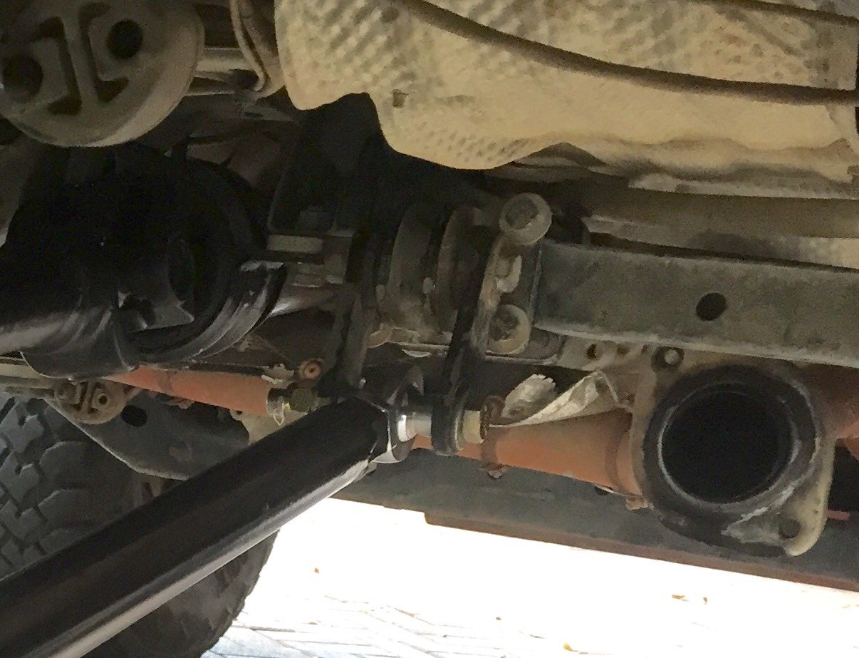

    By the way, nice job on the traction bar project! Was that a one off, or possible addition to the trail toys selection after some R&D?

    Nathan, on the new bar, did you use bushings at the axle, and then a bushing at the upper end of the shackle? rod ends at the front of the bar, and where the upper link hits the lower link?
    if I don't get around to linking my rear end this summer, I'm going to have to knock out a traction bar until I can.

    Thanks bud. Right now it's a one off. I don't know how many people would want to sacrifice their stock muffler for a traction bar. I had planned on making a new front mount, but ended up using my old ATO mount. That made my life easier, but didn't help with R&D.

    The upper and lower axle mounts are rubber bushings. The front mount is a 3" shackle with a heim, and the middle is a heim as well.
    Remember the front mount on the old ATO bar? Didn't you help me put that thing on way back when?

    Here's the front mount. I had to crop and lighten another picture, so if this isn't clear I'll have to take another shot later.

    I 100% remember installing that pain in the ass crossmember mount. I just couldn't remember if it was a bushing or heim.

    I found the dent in the body from the "custom" clearancing needed to get that mount in place. I'm just glad I didn't toss it.
    There's a bushing in the mount of course. I should put a gopro down there and see how the traction bar is behaving on acceleration.
