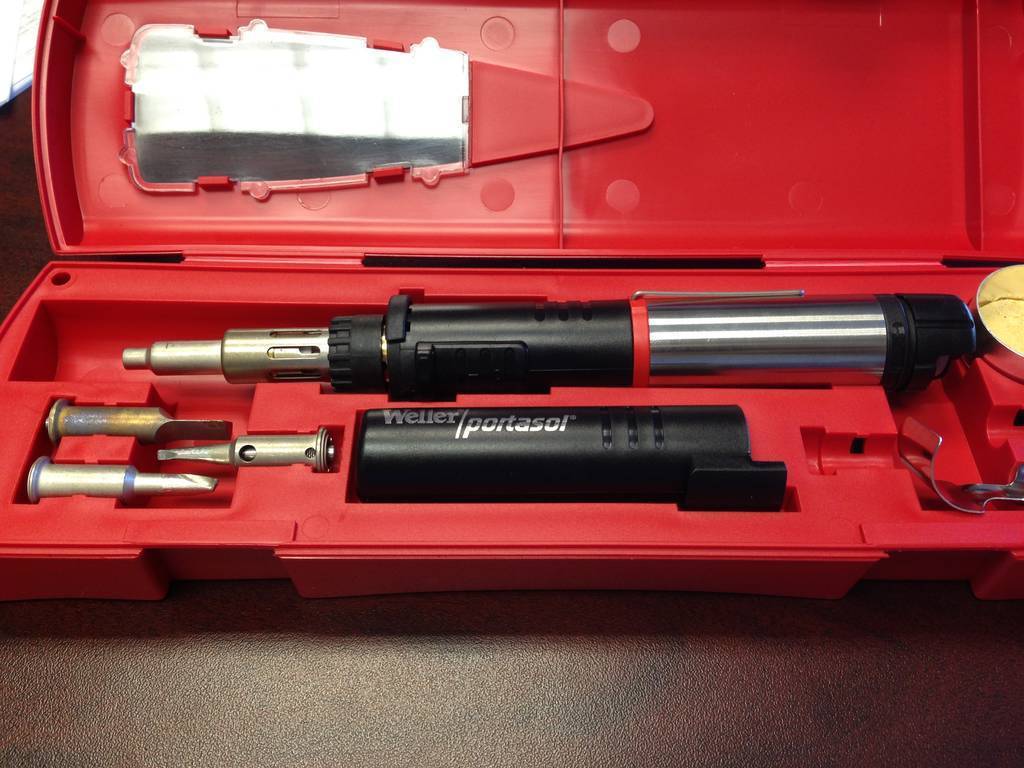

    We'll take a look at options on Sunday. For now everything will be electricly switched. The compressor is installed and powered, just need to clean up some wiring. My crappy soldering iron wasn't cutting it last night, so I went out and got one of these. :D

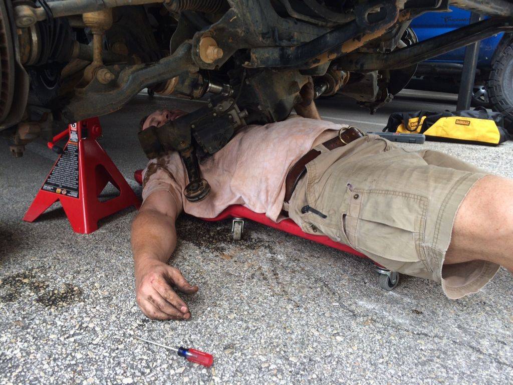

    The front diff went in today with Colin's help. It was definitely more of a chore than the rear, but we all know that. This time we only had to make one trip to the hardware store. Neither of our tool collections contained a 12mm hex anything. Fortunately the creepy sears is just down the road.
    Everything went along pretty smoothly till we went to pull the diff from the truck. At one point I managed to pin myself between the diff and the crawler I was on. Of course Colin paused for a photo before helping me out from under the diff. :)
    Getting the diff back into place wasn't cake either, but we managed. We got everything buttoned up and went out for a quick test drive. We had one small problem though, the 4wd light was flashing at me, and I hadn't even tried to put it into 4wd yet. As it turns out the ADD was DOA. :( After a little quick research online we found that swapping the ADD wasn't as big a task as we thought it was. We removed the three main bolts from the diff and lowered it down. The ADD was able to be unbolted and swapped out. The only downfall was that the new diff fluid we just put in was wasted. Oh well.

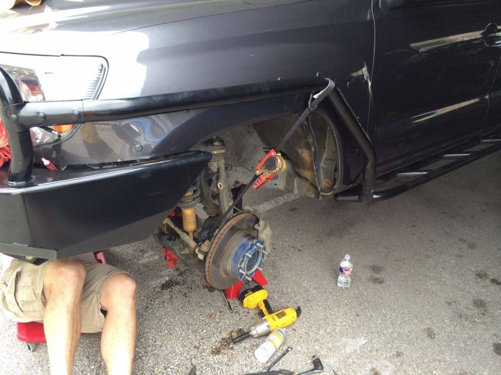

    We also discovered an unintended use for the new scrub bars. They do a fantastic job of holding up the spindle while it's disconnected.
