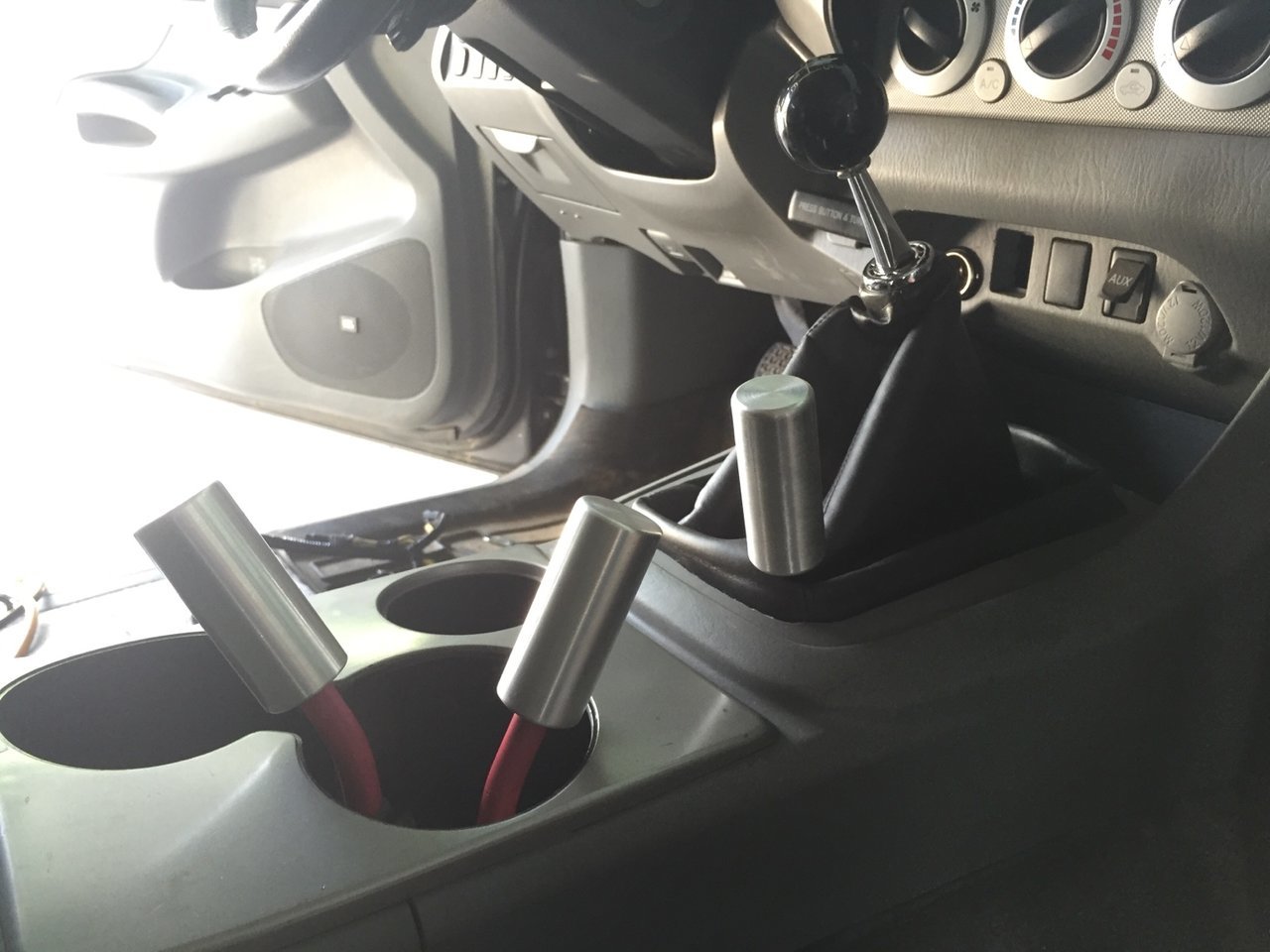

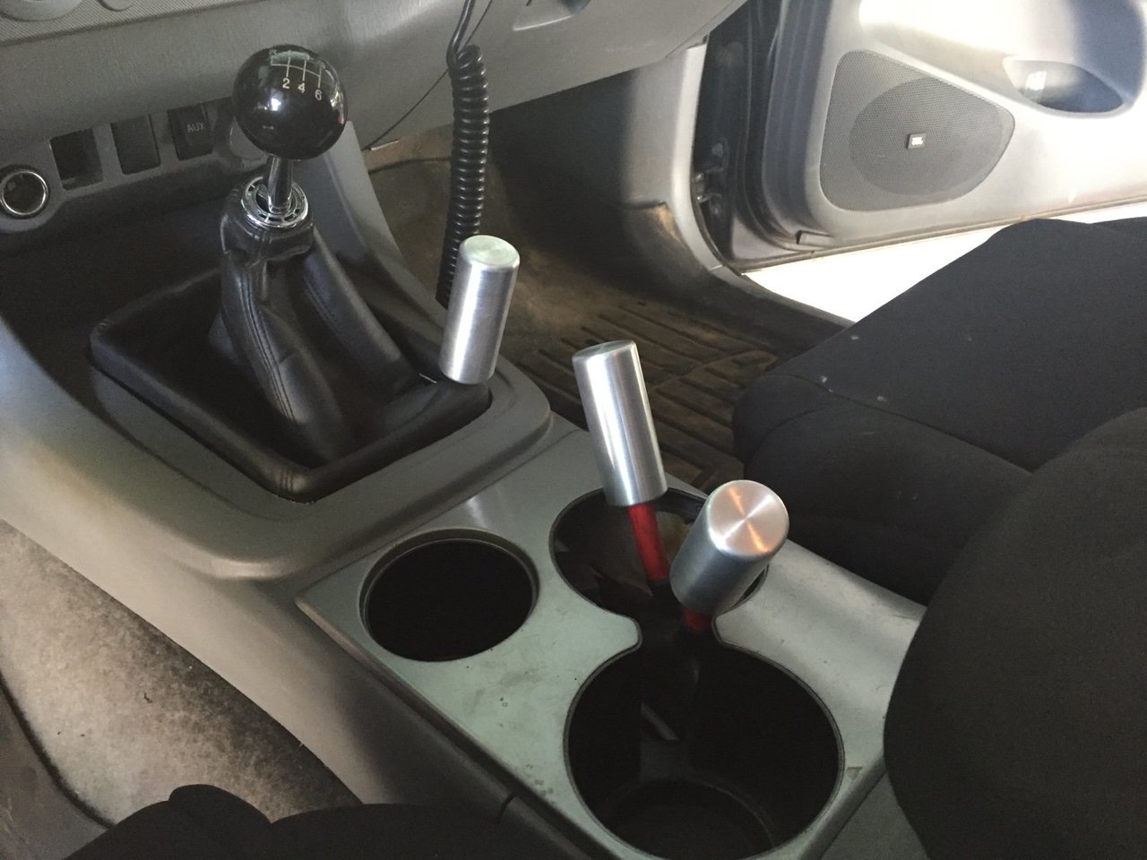

    Shifter ideas
    My favorite

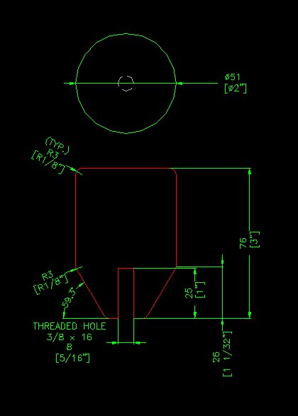

    Here's the plan for the new knob. It's similar to the others, but different enough to be comfortable in hand as it will get the most use.
    Just sent the drawing over to my buddy.

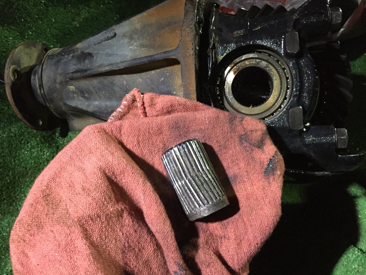

    Camp fire is tonight....
    I was able to swap in the new axle by 11:00 yesterday morning, but ended up with brake problems. Pretty sure I have air in the abs module. I was able to get about 75% of the pedal back last night. Maybe I'll get to wheel today.

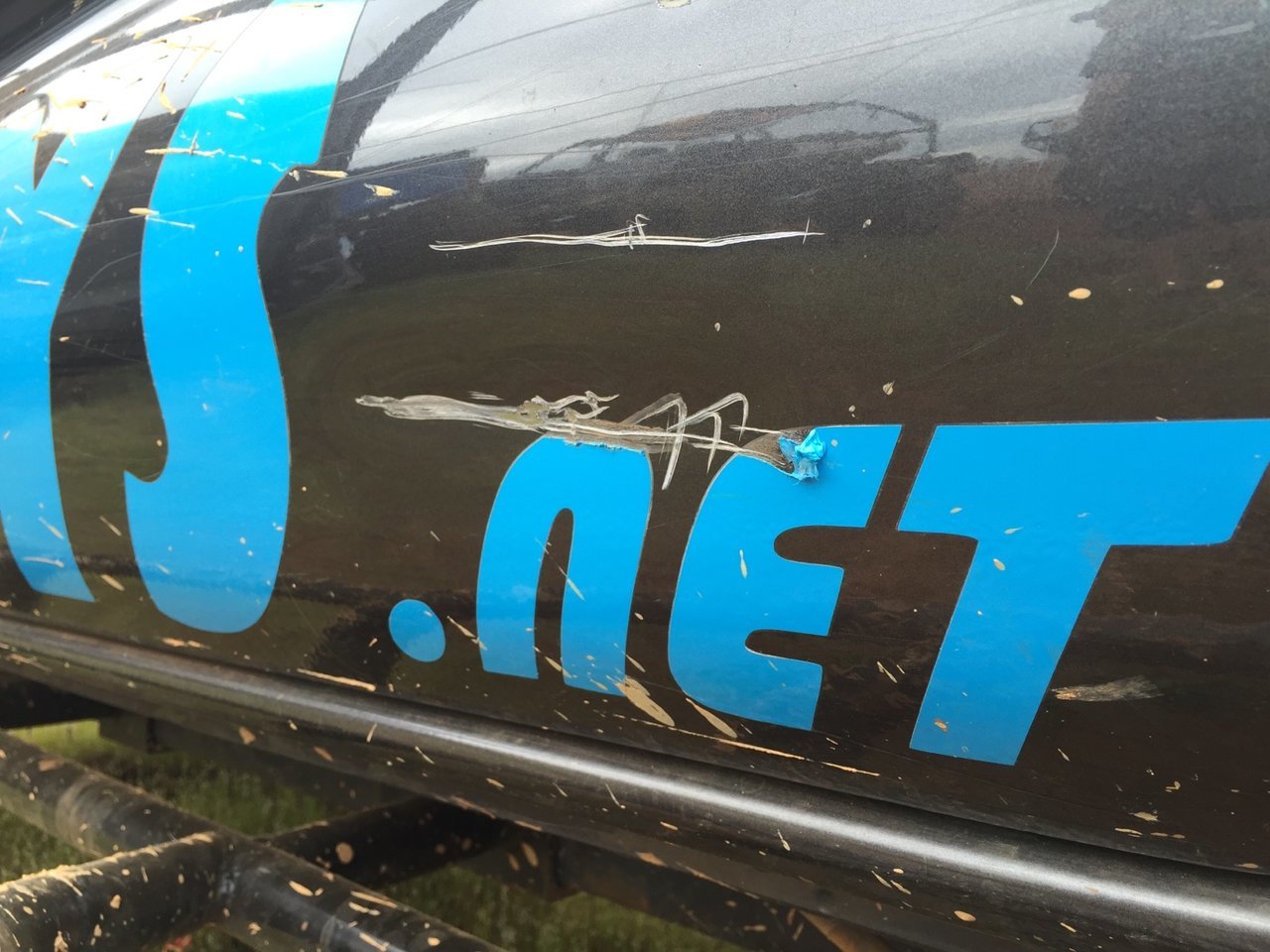

    Yesterday while pivoting around a rather large rock I managed to cave in my slider. This wasn't a hit, just constant pressure on the turn. I did slip of the slider just a bit though.

    I'm glad someone got a picture of this. We tore Smokey apart Thursday night and had the new shaft in by 11:00 Friday morning.
    I had brought my grass for the booth, but figured it would be better put to use for this task. I think the grass will be making all the trips now.
