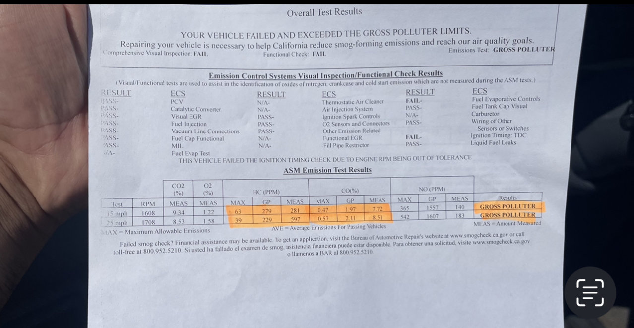

    Having trouble passing smog. Has anyone had similar issues?
    Guy from smog said my timing was off RPM Are to high. Going take it to the mechanic tomorrow.

    Yup you guessed it California …. No check engine light on. Thought it would have pass. Going go to autozone right now to get some EFI cleaner. Just don’t know if it’s worth taking it to the mechanic or me trying fix it myself.

    There are other issues, she failed the visual for thermostatic air cleaner and functional EGR. The tech could not verify idle ignition timing because it would not idle at recommended idle speed. You are now flagged as a gross polluter and this puts you in a special category smog wise. For some reason you are dumping fuel into the motor… what motor is in the truck?

    The paperwork is laid out poorly. The pass/ fail is to the left of the item checked, so the two fails on the visual are actually Fuel Evaporative Controls and Ignition Timing TDC.

    Yes correct took me a second to read it.
    What fail was the Timing TDC and Evaporative control
