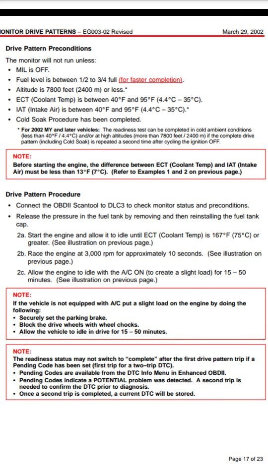

    I am having the same issue at this point I have driven 274 miles in a combination of freeway speeds of 60 to 85 miles an hour 50 to 70 miles around town on city streets at varying speeds got frustrated and look up the exact Drive pattern or whatever they call it the you supposed to do and it is ridiculous you are supposed to drive between 40 and 60 something miles per hour for 150 seconds then idle for 2 minutes then drive at 25 miles an hour for 40 seconds then idle for 10 seconds and do this 10 times I don't know where to go do this as people will either be honking at me or trying to drive around me this is very frustrating so I am purchasing a scanning tool that says you can leave it plugged in while you drive and the lights will indicate when they have reset

    I forgot to update the thread. So after I brought truck to smog shop last weekend, I took it home and put the old,, original gas cap back on then i unplugged the battery for 2 hours. Reconnected it and drove it 70 miles on the freeway. Then on Friday, I went to the gas station and put enough gas (92 octane) to fill it a bit higher than half a tank. I then drove about 3 miles in stop and go traffic until I reached the freeway.. I then drove on the freeway for approx 50minutes between 50 and 60mph. Stopped, had lunch then immediately drove it a few miles to the closest smog shop. Had to ask guy to plug in OBD reader to check (they don't like doing this) and he said it was ready. It passed in 10minutes! A big relief since Toyota wanted to charge me $300 to diagnose! Thanks for all tips and tricks!

    Thank you. I was so stressed out over it because reg is due in a day or 2. I have no way of knowing what made it pass. I think it was driving slower on the freeway with foot on pedal whole time. I think that got the cat converter hotter.
