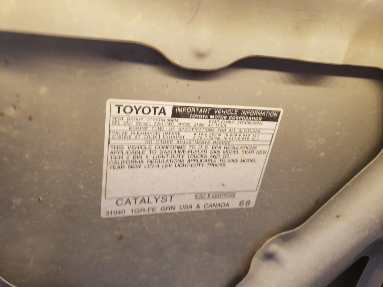

    About to fail smog. The guy thinks there should be a MAF upstream from the air box. A second MAF.
    Anyone have documentation showing only one MAF on the 1GRFE?

    Should be the sticker on your hood if you don't have that you'll fail smog too, take it to another shop?

    They go off of the under hood emissions label. Is yours missing? They have resources they are required to use in order to determine what the vehicle should be equipped with. They should document the failure reason on the invoice.

    is he referring to the secondary Air SAI? If so that is only 2012-2015. Pre does not realize you do not have this and never did. Likely this is what he is referring to.

    The "2A/F" here seems to be the problem...

    You failed an inspection for a "missing sensor" that doesn't exist?! Sounds like you need to find a new shop.
    Or trucks only have one MAF sensor, very few vehicles have more than one, those that do have 2 throttle bodies and 2 air intakes.

    A/F is Air/Fuel Ratio sensors, yes the 1GR-FE has 2 and they are on the exhaust not the air intake.

    Ok we're good. We pulled up the FSM on my head unit and looked at the diagrams.
    Feel bad for these guys, a thankless job and always one missed detail away from losing their license. The CARB sends them undercover cars regularly.

    You'd think they'd have smogged a 2nd gen before by now...weird.
    A/F is obviously air/fuel sensor, must've been a new guy doing the test.
