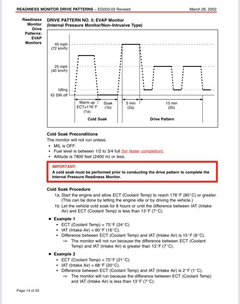

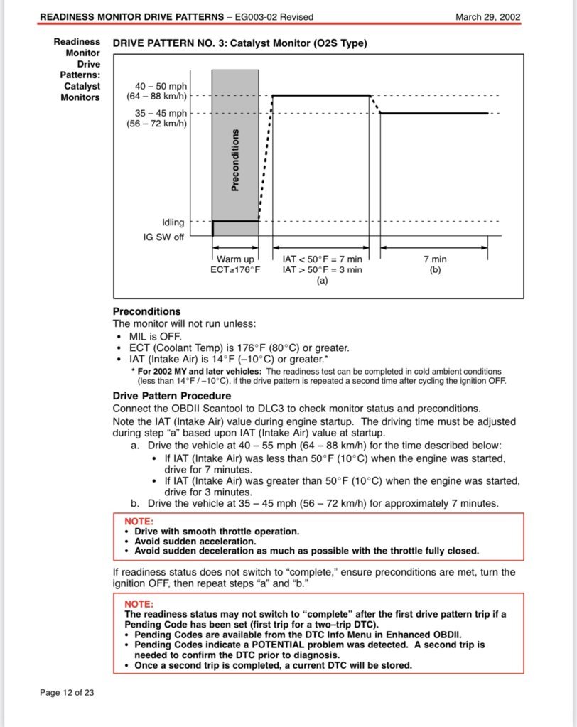

    Our 2000 Tacoma is an SR5, 2wd, AT, 5VZ-FE. Went to smog it a few weeks ago and the test guy told me it wasn’t ready. I came home and put my OBD reader on it and it said the Catalyst wasn’t completed and I had a pending P0420.
    I did the shop vac on the muffler trick and found multiple exhaust leaks at two of the exhaust gaskets. I red RTV’d both those unions and verified the leaks were gone. Drove around more and got the full code this time, P0420. Cleared the code and replaced both the upstream and downstream O2 sensors.
    Ever since I replaced those two sensors, I have driven it and driven it and driven it. The code has never some back and nothing is pending either. So it seems like I fixed the problem, but STILL no smog readiness. I cannot get the Catalyst to complete its test. And ever since that last time I cleared the codes, I also now can’t complete the Evap System test.
    I am following the directions in the factory TSB EG003-02 concerning “Readiness Monitor Drive Patterns.” I don’t understand why they both won’t run but I’m also no longer getting any codes. The truck runs great but now my registration is expired. Ideas?

    Have you verified your coolant temp is getting high enough?
    The monitor will not run unless: MIL is OFF. ECT (Coolant Temp) is 176F (80C) or greater. IAT (Intake Air) is 14F (–10C) or greater.

    Stock
    I’ve done all this. Yes my coolant temp is high enough. I’ve verified coolant temp at start up and at operating temperature. I’ve done the cold soak. I’ve driven from Burbank to Magic Mountain and back. Twice. Plus miles and miles of in town driving. Hoping the fuzz doesn’t pull me over with my expired plates.

    2000 Tacoma SC 2.7 4x4 5spd
    Some of those readiness monitors are weird about the speed they need to complete. Don't remember where I read it, but I think the catalyst monitor needs something like 55mph for 20 minutes or something surprisingly long (don't quote me on those numbers).

    I’m using the Toyota TSB as my guide. I have the exact requirements.

  12. Jan 18, 2025 at 8:02 AM

    For a stubborn cat monitor I have had some sucess doing the following. From a cold start let it idle for a few seconds then rev her to 2500 rpm and hold it there for 3 minutes then check your monitor. I know it doesnt make ANY sense but like I have said it has worked for me a few times.
    Found the video
    https://www.youtube.com/watch?v=BuZYAy_xi0E

  15. Jan 18, 2025 at 2:30 PM
    pouncey
    pouncey [OP] Member
    Dec 11, 2018
    #275531
    12
    Burbank, CA
    2000 Tacoma SR5, 2wd, AT, 5VZ-FE
    Stock
    Hey, this partially worked! I let the engine warm up to 176, then held a steady 3000rpm for 3 minutes and I completed the Evap System test. So I’m partially there. Still need to complete the catalyst, but now I can just focus on that.

  16. Jan 19, 2025 at 9:50 AM
    #16
    Glamisman
    Glamisman Well-Known Member
    Oct 22, 2016
    #200436
    4,938
    The cat test is a bitch... 55 mph for 10 minutes, yeah, right. When I have to do this it is 10 at night to avoid the traffic. The other thing i can tell you is that if you have your scanner hooked up and are driving and monitoring for cat completion, it wont complete while you are watching, why, have no idea just how it is at least for me.
  17. Jan 19, 2025 at 9:58 AM
    #17
    pouncey
    pouncey [OP] Member
    Dec 11, 2018
    #275531
    12
    Burbank, CA
    Stock
    I’ve wondered about that exact thing. So I stopped doing that as well. Now I just drive it and check it when I get back home. Drove 40 minutes, roundtrip, on the freeway last night, and didn’t look at it until I got back home. Still incomplete.
  18. Jan 19, 2025 at 10:03 AM
    #18
    Glamisman
    Oct 22, 2016
    #200436
    4,938
    I looked for an answer but have found it yet... I know that certain years of vehicles in CA can be smogged with one incomplete monitor, does that include the CAT monitor, like I said cant find a definitive answer.
  19. Jan 19, 2025 at 10:19 AM
    #19
    Diy2k
    Diy2k Well-Known Member
    Mar 4, 2024
    #445210
    76
    MG
    02 Tacoma, 2.7
    Softopper, shocks
    You can have one CEL for the other checks. BUT it cannot be the cat monitor.
