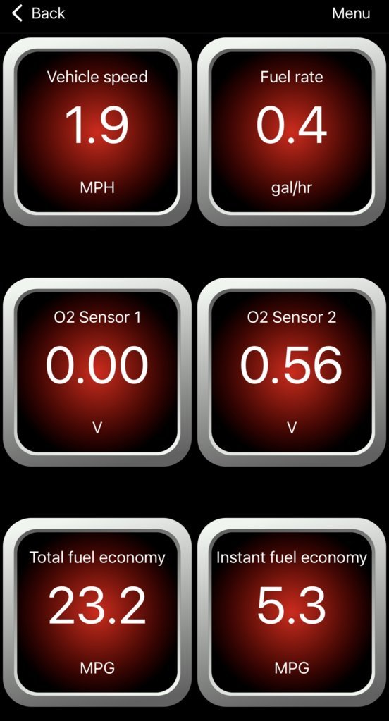

    So…..still haven’t completed the catalyst test. As you may remember, I replaced both O2 sensors a long time ago. I noticed recently this monitor on my OBD reader.
    While I’m driving, O2 sensor 1 never shows any value but #2 constantly changes. Is that supposed to be that way? Wouldn’t I get a code if the sensor or the wiring harness was faulty?
