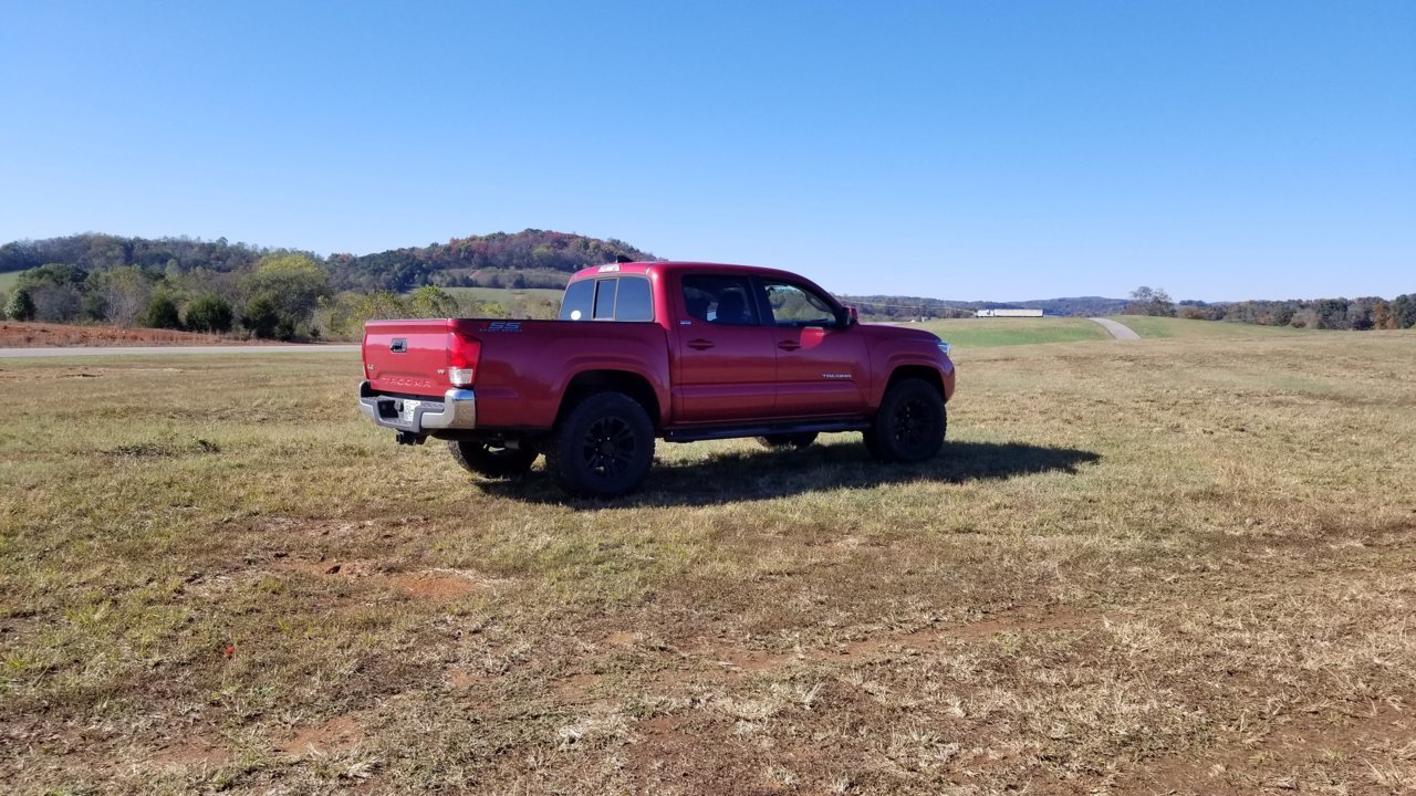

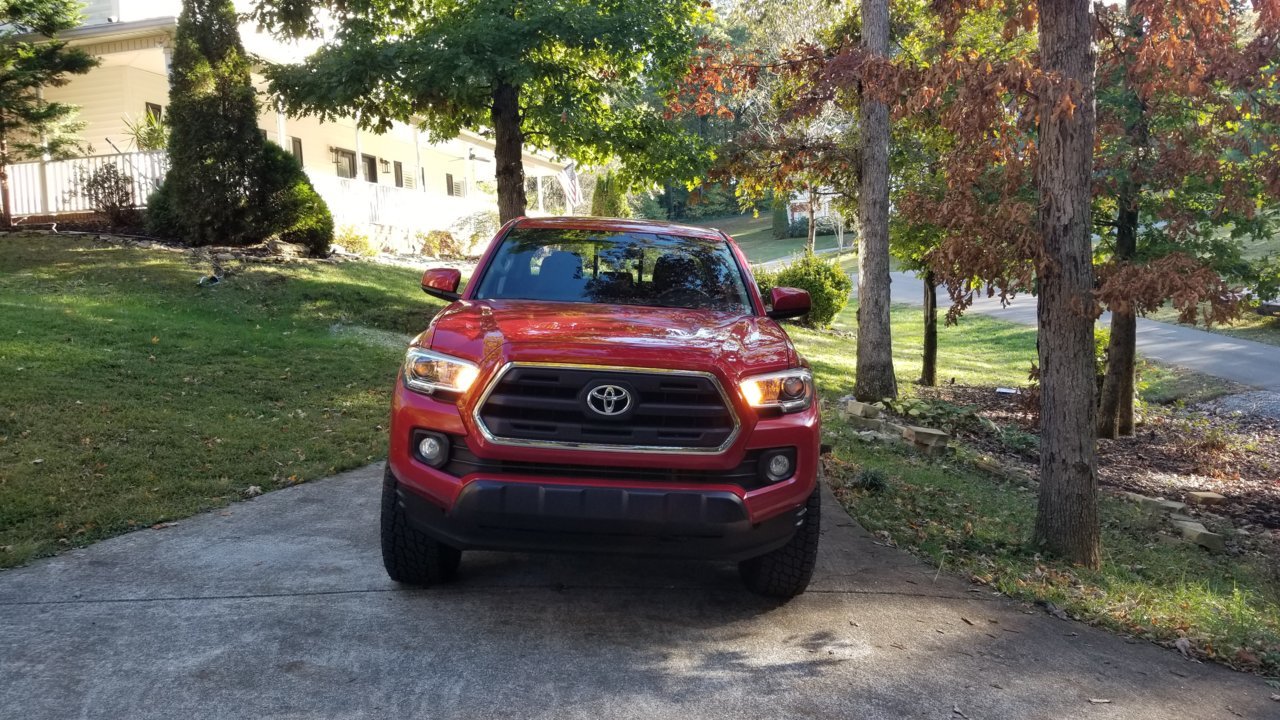

    Hello, everyone.
    I just bought my first Toyota about two weeks ago. 2016 Tacoma TSS Package 4x4 77K miles. I LOVE the truck, but for the past week, it has been smoking significantly upon startup.
    At first I thought it was normal condensation, but it seems like a little too much for that. It doesn't smell sweet or like oil, and it only does it upon a cold start. It doesn't do it at idle or acceleration. I added coolant the day after I bought it because it was below the full line. There doesn't seem to be any coolant leak, no oil leak, the oil is not milky, and it isn't missing at all.
    My coworkers are Toyota enthusiasts and even they think it is a little strange, so I wanted to post here and get some feedback. I really hope I am being overly concerned because I really really like this truck and want it to last a very long time.
    Here is a link to a video that I just took of the startup: https://vimeo.com/371163239
    It has been sitting for two hours and is currently 50 degrees outside. There was a lot more smoke this morning when I started it after sitting all night (39 degrees) and it was much more white than this video.
    Thanks in advice, guys. I hope to stay here for a long time and be a contributing member.
