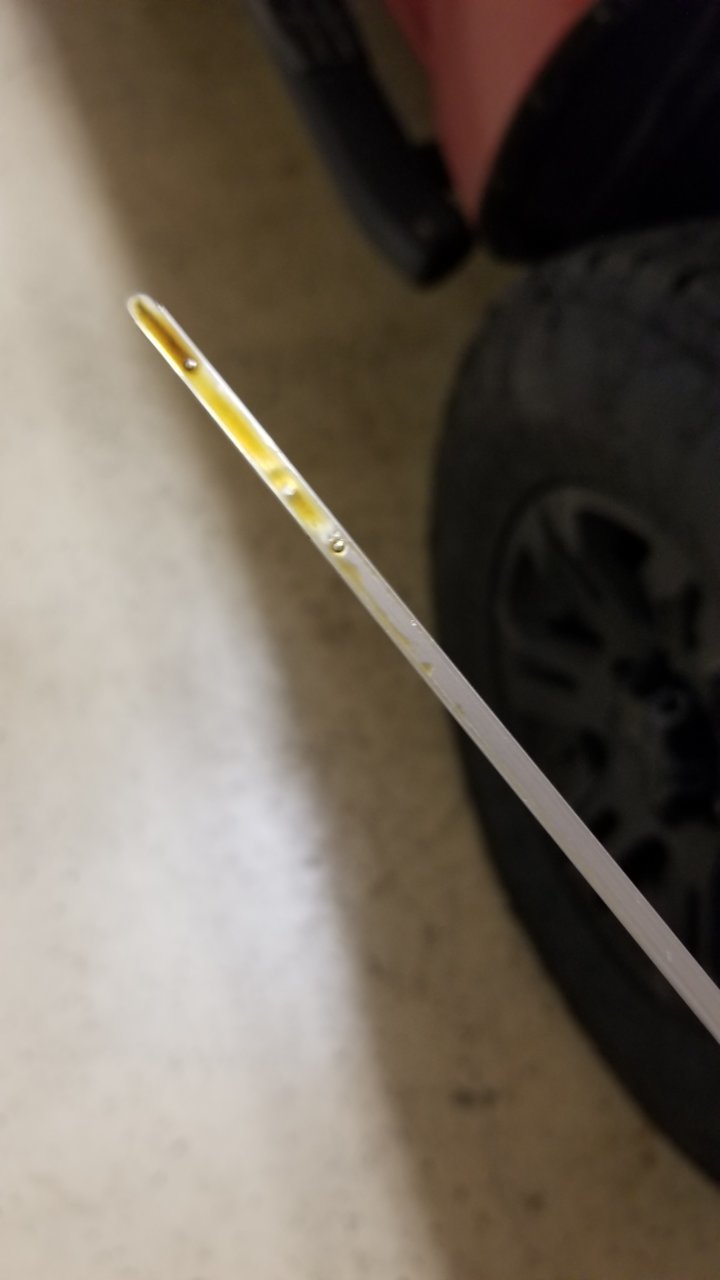

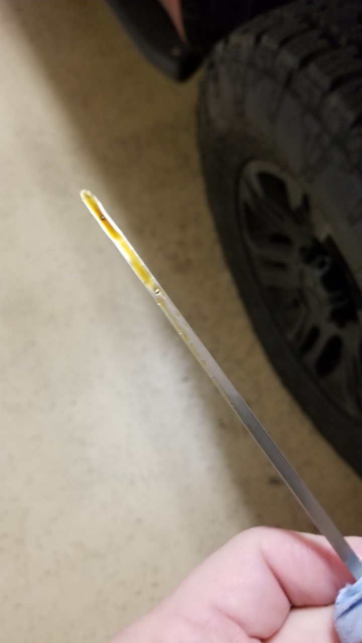

    Before making the post, I was leaning towards valve stem seals. I will start with the PCV Valve and go from there. I also thought maybe it had too much oil in it from the last oil change.
    Here are some pictures of the dipstick from yesterday morning after sitting all night. 20191104_070638.jpg 20191104_070717.jpg
    Oil change was at 75k.

    It’s valve stem seals. It’s not a big deal. A competent mechanic won’t even have to take the head off, they’ll pull the spark plugs and fill the cylinders with compressed air to keep the valve from dropping and do them in place.
    It’s not a head gasket and it’s not the PCV system. And no amount of additive was going to hide that. The conspiracy theories here are hilarious.
