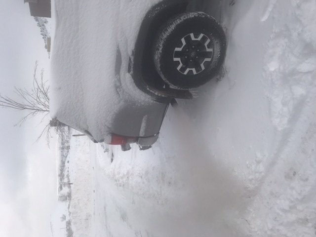

    I had a similar problem on my 2017 last week. Left it overnight in the cold, and when I started it in the morning it had a bit of trouble, then was smoking for over a minute. The smoke on mine seemed more gray than yours, but same symptoms. Temp was around 0f when I started it. Here is a photo of the smoke, I did not think to take a video though.

    That looks like harmless water vapor to me. At least from that pic.... perhaps the lighting it making it look grey?

    It was definitely not just normal condensation. Much darker than that. It gradually got lighter until it was just normal water vapor in the exhaust, but by the time I thought to take a photo, it had gotten much lighter.
