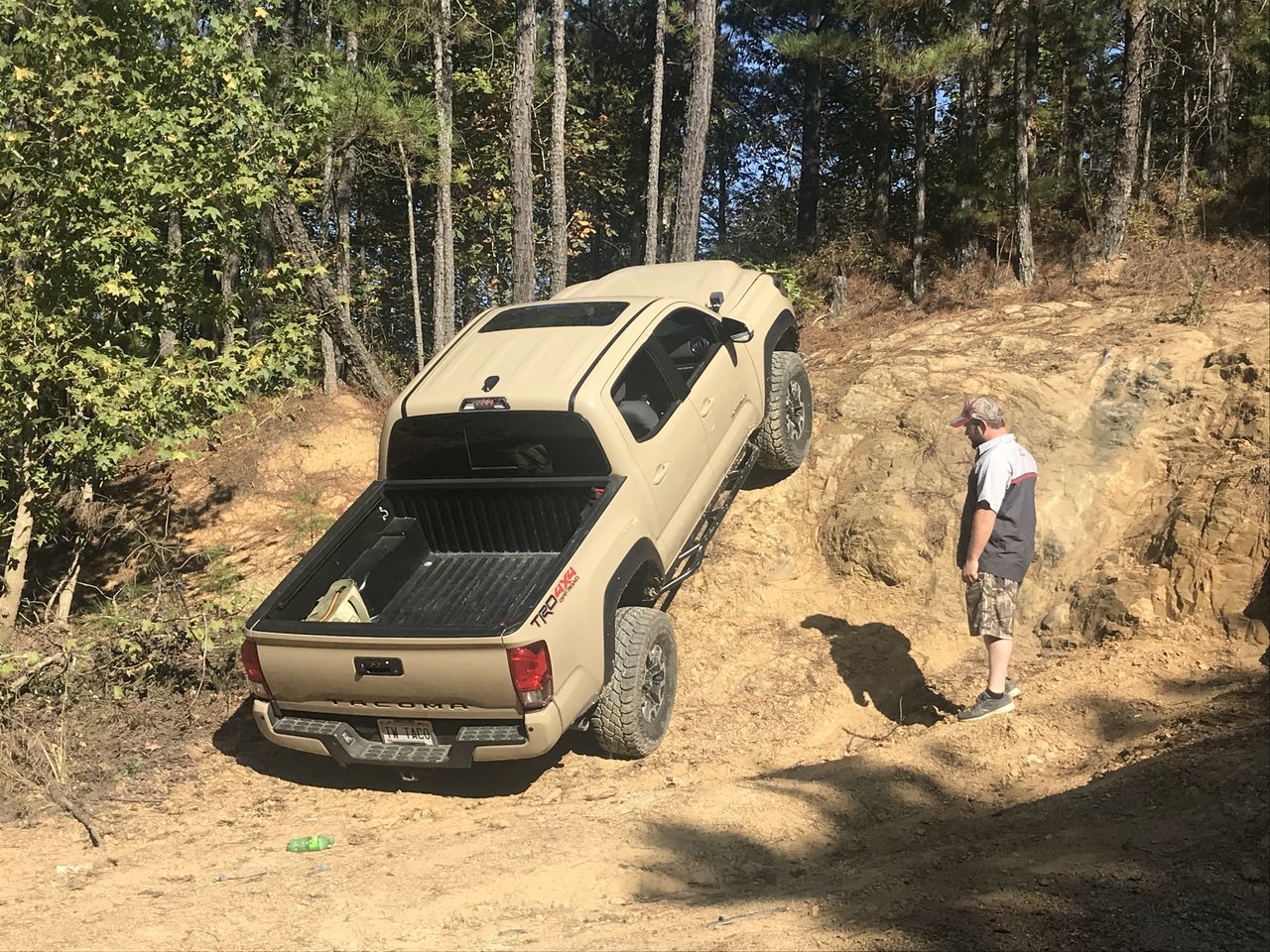

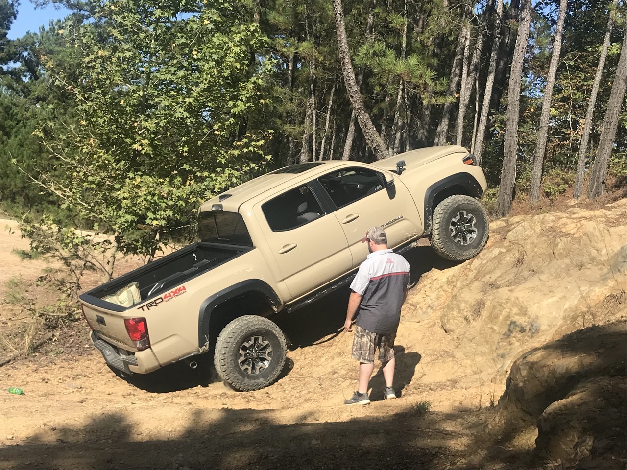

    Ok, so I have searched TW and had no luck finding any information on this topic. However, I have heard from some guys in the Alabama Thread that is can be a 3rd gen thing. I am trying to determine if this is a problem I need to get fix under warranty.
    Problem: White smoke is pouring out of my exhaust after attempting a couple hill climbs. The smoke does not start immediately, but rather after a couple attempts of trying to climb the hill. I start to lose power after the smoking has been happening for a couple mins. Additionally, there seems to be a knock/click sound right before the smoking starts. This is what has me the most concerned. If I back out and level out the smoking stops. All fluid levels look to be fine.
    Situation: This only seems to happen on inclines above 35 degrees and after a couple attempts.

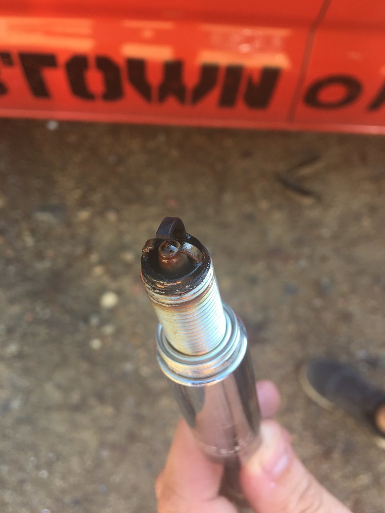

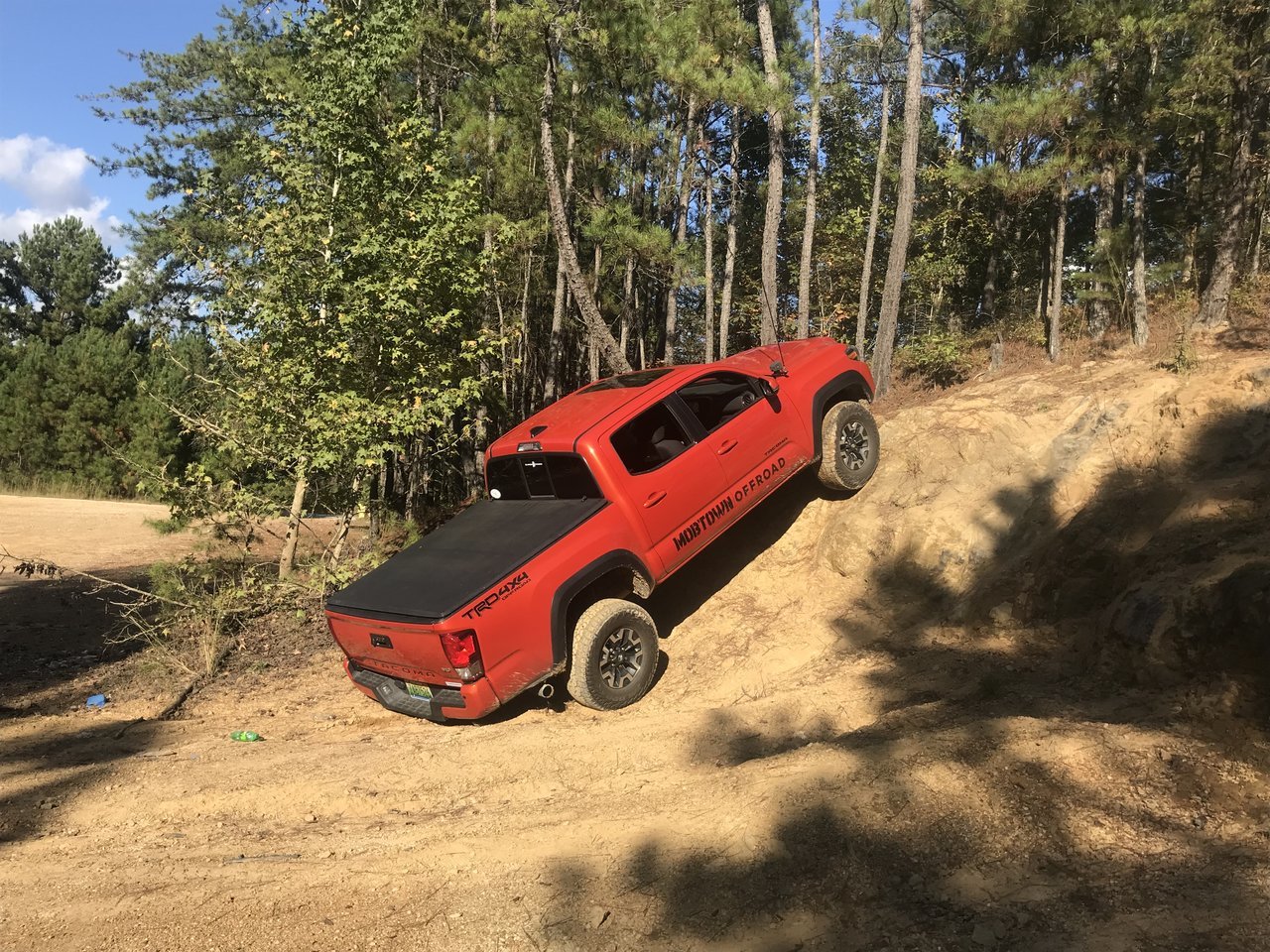

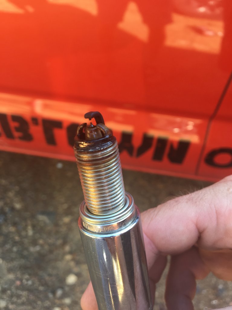

    Sunday I met @tweakit88 out at the Slab in Montovallo to see if there is anything we could come up with. First step was to find a hill about 40-45 degrees and see if I could make it smoke and ping. This did not take very long at all, went up the hill unlocked to let the engine work and within 3mins I was smoking like a SOB! Like always the ping happened and the smoke was right with it.
    @tweakit88 popped the hood and listen to see where it was coming from. Sounds like it was coming from the back of the engine.
    I backed down and the truck was idling rough still smoking but no ping. So I turned it off and we got the tools out. First thing we do is pull the rear spark plug on the passengers side and it is covered in oil!!:eek:
    Put it all back together, so I guess the next step is to take it into Toyota. :notsure:
    @tweakit88 decides he is going to try the same hill and see if his truck does the same thing. Low and behold it does, pinging and smoking like a SOB.:censored:
