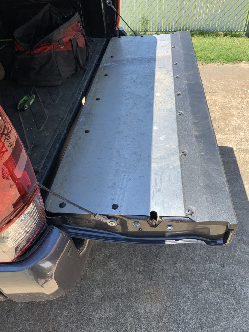

    0C9569E4-5710-4BB8-864C-678378170002.jpg I made a smooth tailgate out of some scrap I had left over from another project. I have a guy gonna line x it for free0C9569E4-5710-4BB8-864C-678378170002.jpg

    I’ll load up the finished pic after I get it line-x and put back on

    Post some dimensions, so we can bypass more *expensive* options. Is yours bowed from the supports?

    I just pull the factory one off and measured the inside and cut to fit and rounded the corners so it would fit inside it an marked all the hole and drilled them used a 3/4hole saw were the latch goes the filed it straight

    Don't the supports sit proud? Does your plate bow?

    It is flat when you take the old one off
