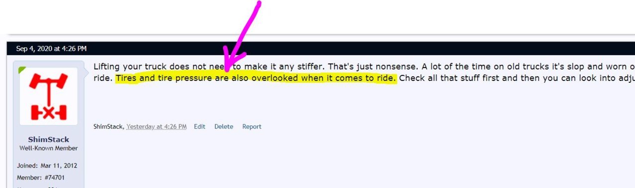

    Lifting your truck does not need to make it any stiffer. That's just nonsense. A lot of the time on old trucks it's slop and worn out bushing that create a harsh or jarring ride. Tires and tire pressure are also overlooked when it comes to ride. Check all that stuff first and then you can look into adjusting rates of your suspension hardware.

    No one mentioned tire pressure that I saw I smoothed my ride quite a bit running 32 psi

    Damn I need glasses ‍♂️
