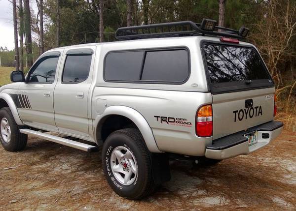

    Next major mod is the Rolla roof rack. I have a reinforced cap and decided to add some storage space. It actually has come in handy quite a few times. Take note, the Rolla rack rusts quickly. I have to sand it and repaint it already, but it’s been holding up ok after that. Takes some nerve to drill them holes… remember… measure twice, cut once. I also went with Line-X bedliner at about the same time. This stuff is ultra-durable and after years of moderate abuse, still looks great.
    Also added some additional backup lighting to the rear of rack wired in parallel to reverse lights.
    More about it here:
    http://www.tacomaworld.com/forum/1st-gen-tacomas/64597-roof-basket-security.html

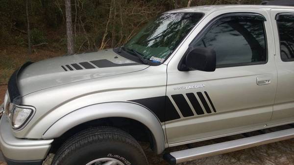

    Sock Monkey Graphics:

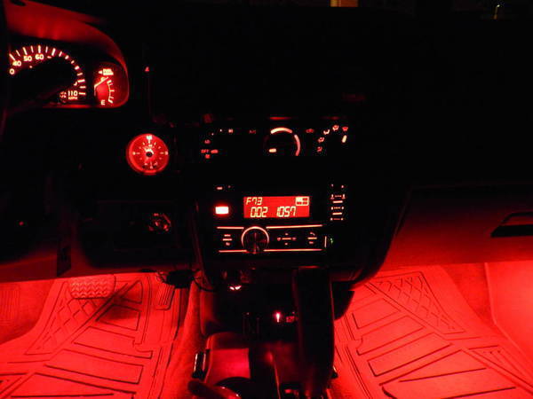

    Red LED lighting throughout. Really easy on the eyes at night. The pics looks a lot more intense than it is in person… but you get the idea.
    Also installed autometer analog clock. Can read the time even with car not running.

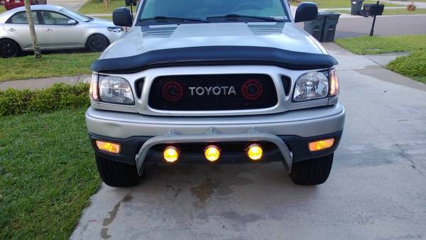

    Satoshi Mod... lots of work but glad I did it. Added "TOYOTA" logo, Hella Supertone horns, PIAA 530 LED fogs, with Laminix amber film over top.

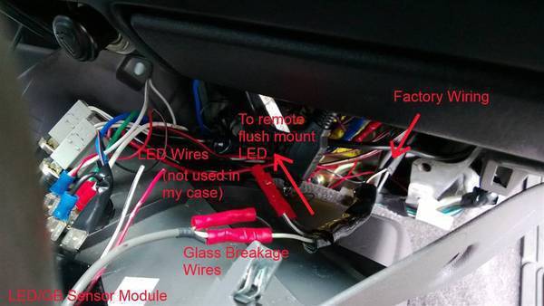

    Thanks for the compliment on the rack. It's very solid and functional. It may cost me an MPG or 2, but I like it.
    Also, I've been keeping an eye on your build... lots of awesome info in there... your LED ignition key ring mod is on my short list :D
    I had to open it up and take a look to remember how I did this. This was actually one of my first mods a few years ago. I remember buying the LED GB module from the part number on the customtacos thread, but don't remember where from. It came with 4 wires and no harness, so I had to splice it myself. The wiring for the module is as follows:
    LED GB Module:
    - Glass Breakage sensor
    -- Thick grey wire with 2 inner wires
    --- White wire
    --- Bare metal wire
    - LED
    -- Red wire
    -- White w/ black
    These are the wires coming from the left in the pic. I actually didn't use the LED wires from the module, but used a separate LED that was in a more obvious location (more on that later).
    Then you have to locate the factory unused wire from the customtaco thread and route it down where you want the module.
    Onelowrx7 from that thread relocated his hazard switch and put the LED GB module where that was. I didn't do that. Can't remember why exactly, maybe cuz I was too lazy or didn't like the light location or something. It does require splicing and lengthening the 8 wires on the hazard switch to relocate it. In retrospect, I may have done it like Onelowrx7 to make it cleaner if I was to do it today, but this was one of my first mods... plus it works fine. So anyway, the factory wiring is like this:
    Factory wiring harness:
    --- White wire (connects to white of module)
    --- black wire (connects to bare metal of module)
    - LED
    -- Brownish (connects to Red wire I think)
    -- White w/ black (connects to White w/ black I think)

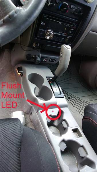

    If the LED doesn't work, just swap wires. When you lock the doors it turns on solid, then starts blinking after a minute or so.
    I ended up routing the LED wires to a flush mount LED on the center console near the cup holders to make it more obvious. The LED works great and I think the glass breakage works, but I'm not gonna test that :p

    Thank you for your reply. I really appreciate you taking the time to crack open your work and document these little things in detail. I feel I owe you a beer or something :proposetoast::cheers:
    I actually spent a good amount of time last week rewiring the hazard button to the lower panel exactly like what Onelowrx7 on CT did, so it's funny you mentioned his work. It did take a lot of time, half way I was thinking if it was really worth relocating lol. Well a few butt conntectors and spare wires later I have an empty hole in my dash where the hazard used to be and ready for a used GB sensor/LED module to fill it up. I was able to find a used vertical module off eBay now kind of hoping it's similar to the one you have.
    Nice touch on the aftermarket LED! I read that on CT that it's possible, and nice to see that you were able to get this done. I live in a townhouse and in front of my kitchen window I have a nice view of our carport where my truck sits pretty for me to enjoy :) I plan to purchase a bright red aftermarket LED light and mount it right below the rear view mirror or on middle top portion of the dash so I can easily peak thru the window to double check every now and then that I armed/locked my truck.

    If you are ever in Jacksonville, FL... I'll take you up on that beer. ;) It is a 12v led I bought from Radio Shack. I did think about having both LEDs and they should work fine if you wire them in parallel, not in series.
    My only thinking about it was that it might look gimmicky and not real if I had multiple LEDs blinking (just based on factory ones I've seen in different cars). I don't think any alarm will stop a career thief, but maybe an authentic looking alarm might make a juvenile delinquent think twice. ???

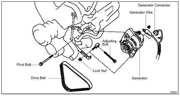

    2 days ago, I was cruising down the road with the fam. Just got back from my son's graduation and decided to GO BIG and eat at Red Lobster :rolleyes::p. While I was driving the radio started to cut out and kept resetting. :confused:. After messing with it for a minute or so, I decided to scroll through my scangauge meters (I knew I bought that thing for a reason). Looked at battery voltage and it was down around 10V. Buy the time I got my truck stopped, the lowest I saw was 7.6V! :eek: I happened to be near a Wally World and picked up a new battery. It was over 2 years old so just decided to get a new one. On the ride home, it was pretty evident that my alternator was dead. Voltage started at 12.5V new and slowly crept down to 11ish by the time I got home.
    I ended up buying a new alternator. I could have put new brushes in myself, but decided to upgrade to an 80amp version. I've always thought the Tacoma stock alternator to be a bit underpowered. Plus with only 120K miles a professionally rebuilt one should last many more years, possibly the life of the vehicle. Here it is in all it's glory...
    For those of you who haven't done this before, I can tell you it is very simple and should take less than an hour. Here is the FSM drawing:
    I used 14mm, 12mm, 10mm sockets, screw drivers.
    I disconnected positive terminal of battery
    Popped cap off generator wire with screw driver and removed nut
    Removed generator connector
    Loosened pivot bolt
    Removed adjusting bolt lock nut and loosened adjusting bolt to remove tension off belt
    Removed pivot bolt
    Pried out alternator
    Here is a pic of the bottom of the alternator where you can see the adjusting bolt lock nut facing you and the adjusting bolt to the right.
    Easy day. After second day, tension seems to be holding on the belt good. I'll keep checking it over the next few weeks just to make sure.
    Here are some specs for ya:
    Drive belt Tension
    New belt 116 – 169 lbf
    Used belt 66 – 88 lbf
    I don't know how to check this... so I just went slightly more taught than my used belt prior to removing it.
    Torque
    Pivot Bolt: 38 ft·lbf
    Adjusting bolt lock nut: 25 ft·lbf
