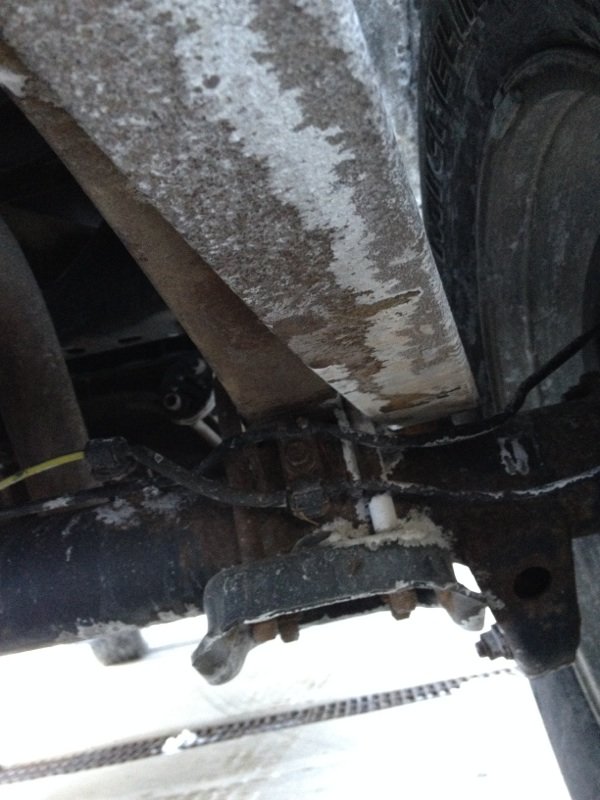

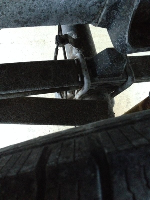

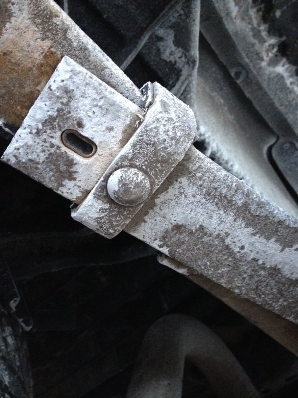

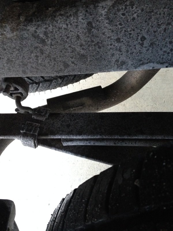

    So I guess I pushed it too much this weekend. My dad and I both hauled 6 truck loads of wood in our Tacomas this weekend......His passed the test, mine is showing its miles. I guess i pushed it too far. I just put 5100's on the front at 1.75" and don't want to have to sell them but i do think its a good time for a lift.
    Any ideas on a small lift to take it from level to 2" more and still keep my new bilsteins up front?
    I'm not real sure how it got out from under the shackle either.

    Set the billys on 2.5 in the front and get a dakar or all pro leaf pack. Probably should get new 5100s for the rear too.
    The dakar pack has 7 leafs on each side and gives almost 3 inches of lift. But its easy to remove a leaf or two.

    I'm sure there are plenty more options out there, but I have Icon's 1.5 inch AAL in the rear. It just replaces the factory overload leaf, but it looks like you snapped the one above it so you may need a whole new pack. That is, unless you can find someone on here who is willing to sell you their factory leafs.

    Take that broken leaf put and put the pieces together and measure the length and width. Go to a junk yard and find an old f150 or chevy and snatch the leafs off of it. Go home cut a leaf to size and install. Repeat for both sides. And viola. Better load capacity and small amount of lift.
    It's what i did to replace my sagging springs and now my truck is stock height and can handle all my stuff i put in it without hitting the stops
