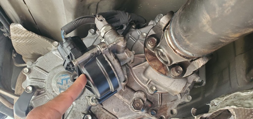

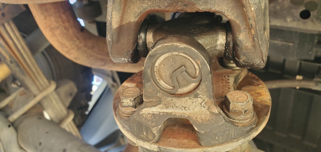

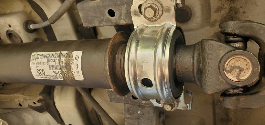

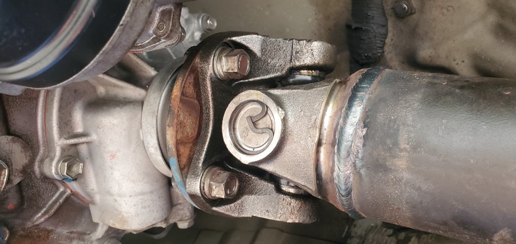

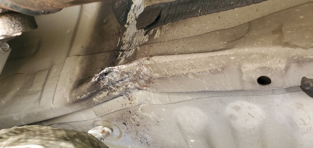

    So I got my truck back and man it runs so much smoother took pics of what they did, it caused it a little bit of undercarriage damaged not too bad and then there's the transfer case sayin the rod inside is bent, what are yall thoughts, I payed $730 for all :annoyed:

    My question would be: How do you know something's bent if you weren't inside? It's hard to tell if the driveshaft hit the actuator. If so, maybe that's all that needs to be replaced.

    Well from what he stated was about to put the actuator on and saw the bent rod inside, like I said, I don't have much knowledge on these 4x4 thingamajigs
