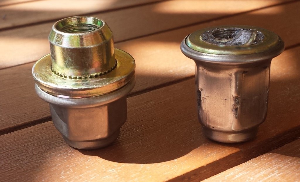

    So now this post will showcase what a normal lug nut (Oreilly OEM) vs the damage one(Toyota OEM).

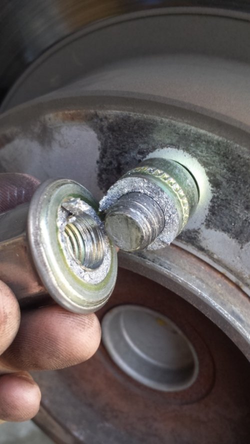

    Another look at the damage lug nut stuck on the wheel stud.

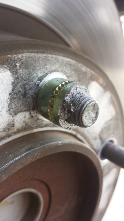

    Another look

    The solution to this issue was to use pliers or vice grip like @nickonfire700 suggested, then proceed to clamp down on the damage lug nut at the base. Then ask for someone to step on the brakes since the rotor will start to rotate if not held in place. After that you are good to go!

    Excellent. I wasn't sure if the rim would come off with piece still on the stud. But now that I think about it, the shank of the lug nut is SUPPOSED to go thru the rim hole. Nice job.

    To be announced
    Op that stud is crossthreaded dont waist your time trying to save it look at the threads in the first pic half of them are missing. cut the fucker off and drive it out with a punch just watch the back side so it doesnt jam up when your pounding it out. I changed tires for years and im a certified hd mechanic. Its easy,its a 20min job max.save your money and do it yourself

    Well, there's your explanation as to why it snapped. It was cross threaded.

    Thank you, for the observation didn't notice it at all to be honest good insight! Time to replace the whole thing muahahaha more fun :D
