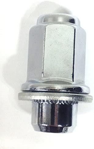

    I used these lug nuts: https://www.amazon.com/gp/product/B086MWB87C?ie=UTF8
    I have wondered if I should get extended thread lug nuts instead.

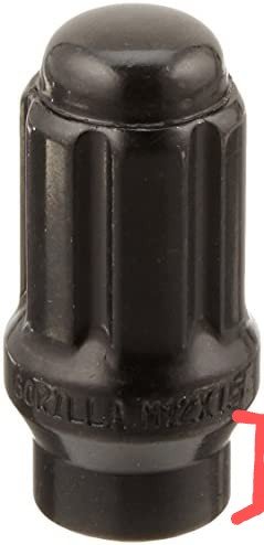

    Straight from Discount Tire in another thread, yup you should be using ET Lug nuts with Level 8 wheels.
    When you specifically said your were torquing them and you were still snapping off I pretty much new you had the wrong lug nuts.
    Also Amazon ones are junk get a good set of Gorilla Spline drive ET lug nuts.

    An ET lug nut is just an "Extended Thread" seat lug nut.
    That red bit there, it's just got a longer collar to help support the wheel and engage more of the lug stud thread so that both a re supported and side shear load is reduced which is what's snapping off OP's studs.
    It's basically a longer nut for thicker wheels.
    Heck even the stock Toyota ones are ET lug nuts.

    The OE lug is not an ET lug it’s a mag seat lug with a conical end so you can use it on the steel spare wheel.
