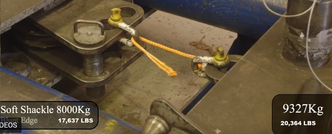

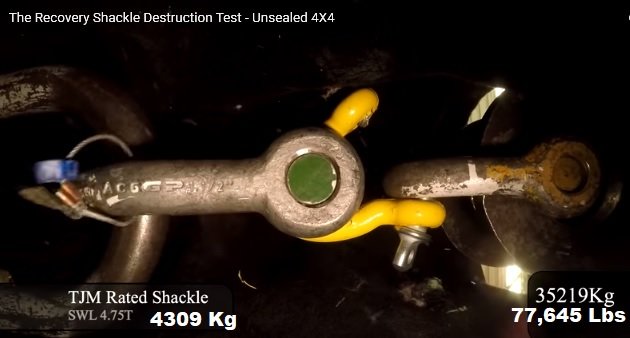

  18. Dec 6, 2019 at 8:57 PM
    #38
    cwadej
    cwadej Ballerina Award winner
    Feb 23, 2018
    #245352
    1,211
    Right Here
    2011 Access Cab 4x4
    not all tests were on "sharp" corner. didnt break, untied. not that mode of failure matters, it failed.test.jpg
    and to compare to steel shackle
  19. Dec 6, 2019 at 11:14 PM
    #39
    jbrandt
    jbrandt Made you look
    Feb 12, 2011
    #51038
    17,612
    Justin
    El Dorado, CA (NOT El Dorado Hills)
    '04 TRD Tacoma 4x4 DC
    Kings, J59's Total Chaos UCAs Custom skids Sticker mod
    Oh yeah, I didnt mean to imply they only did “sharp” corner tests. Just that those “sharp” corners they used were basically the same as what my bumper, and most bumpers/recovery points have. So you either need to carefully modify the recovery point, or use a D ring.
