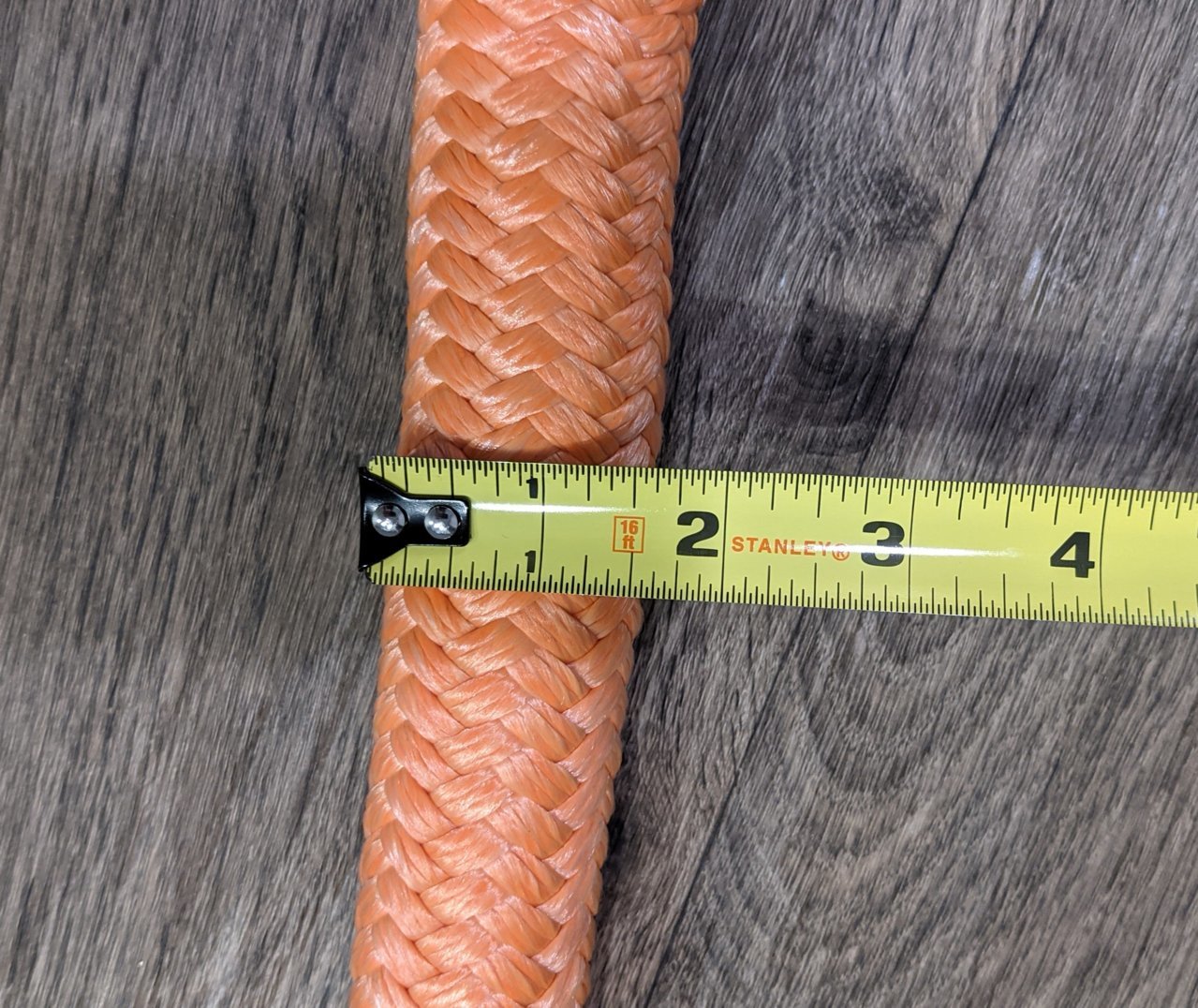

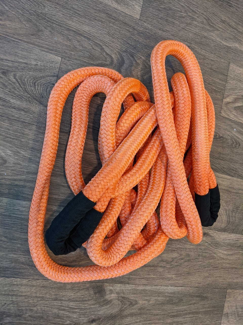

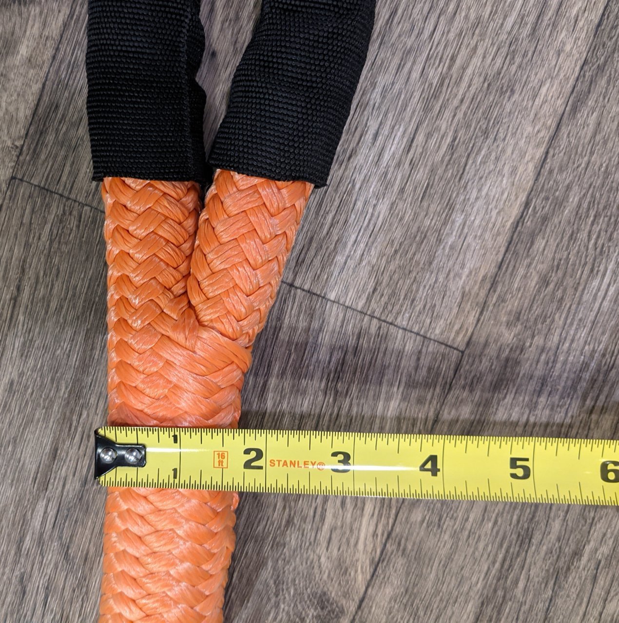

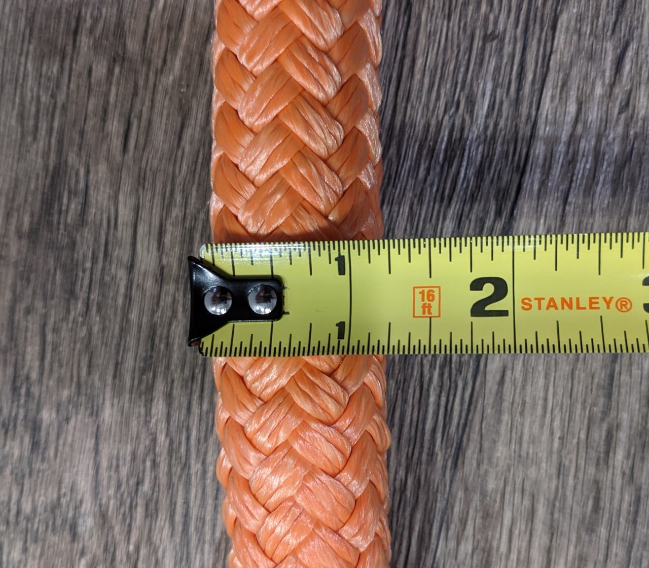

    I bought this BILLET4X4 U.S. Made 1 inch X 30 ft snatch rope.
    It's supposed to be 1" thick, but if you look at the photos below, it is actually thicker.
    Did they send me the correct model? Maybe it will be 1" once it stretches out while in use?

    Measure the rope just above the splice. It should be close to 1" there. As for if it is the correct size, a rating 2x the vehicle weight is a good place to start.

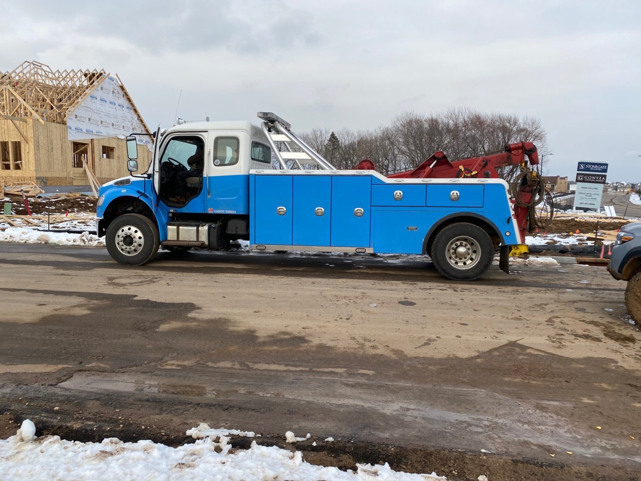

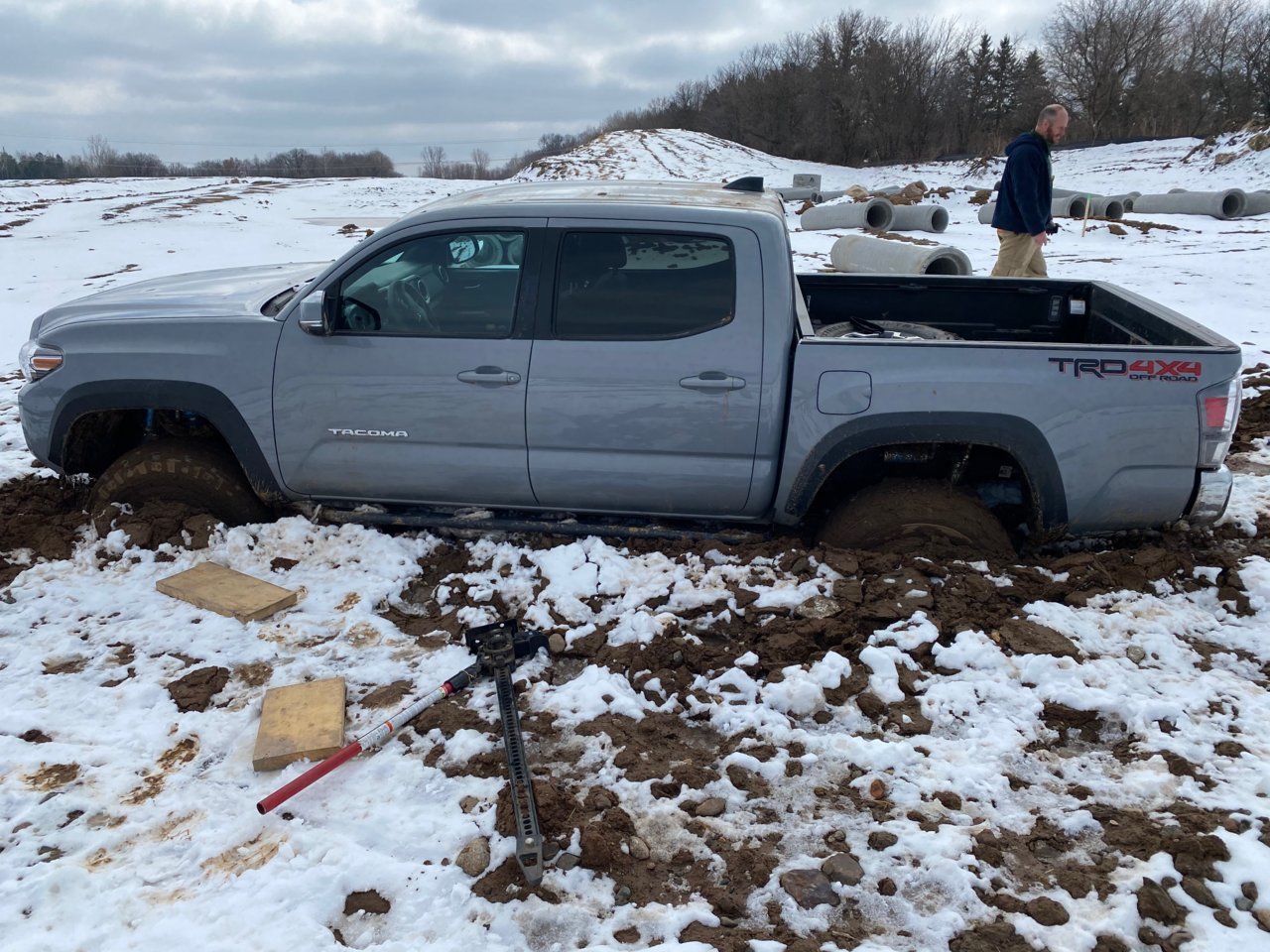

    I used the OR hook during this recovery with a 20,000 lb winch and 300 yds of steel cable

    Ya. No one wanted to drive out to me including my buddies with 4x4. A tow company sent out their semi tow truck because it had enough cable.
    I got stuck the day before when the ground was more frozen. By the time I got back to it the next day the temperature had risen far above freezing and it was soup.
