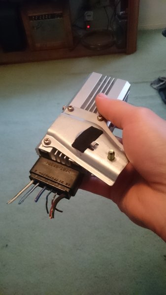

    Thank you very much for your response on that. I greatly appreciate it and definitely follow it a bit better now. My apologies for getting back to you so late on that. I am a bit familiar with pwn as it is used in LED lighting for marine aquariums which I have a good understanding of, but for sending that signal to a relay...idunno. If it has an operating trigger signal that ranges from 1 volt to 5 volts and a capacitor inline to mellow out the pulsing (I think that sounds about right), that'd be great! Not sure about one that actually exists though. I need to look.
    Wiring up a fuel pump ECU doesn't seem all too hard... But it'd be easier to just find existing wires and send 12v to the Tacoma pump. Here is an image of it with it's wires. This one is for sale on eBay for something like $50. Not sure if it's correct, but just to give everyone an idea of one looks like.

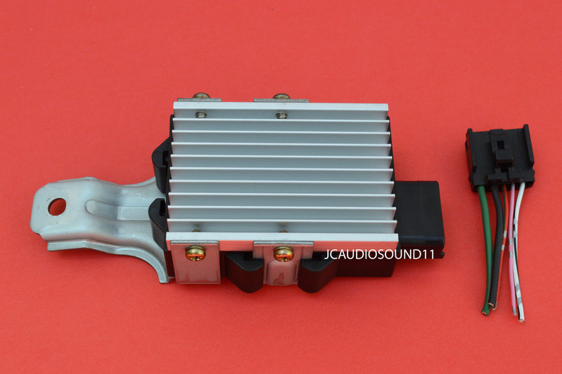

    From my understanding-
    On the far right:
    Big Black/Red wire is 12 volt supply from battery to Fuel Pump ECU.
    The two smaller wires (black/blue, black/red) to the left of that one- one is from vehicle ECU sending the pwm signal turning it on and telling it how to run the fuel pump and the other small wire is to check if the fuel pump is "healthy." Not sure which is which yet but will find that out.
    Then there is the big Blue/Red wire. That is the signal to the fuel pump.
    I have no idea what the far left two wires do yet, which one is white and black and the blue and white.
    Have to head to work right now, but will try to see what the other two do.
