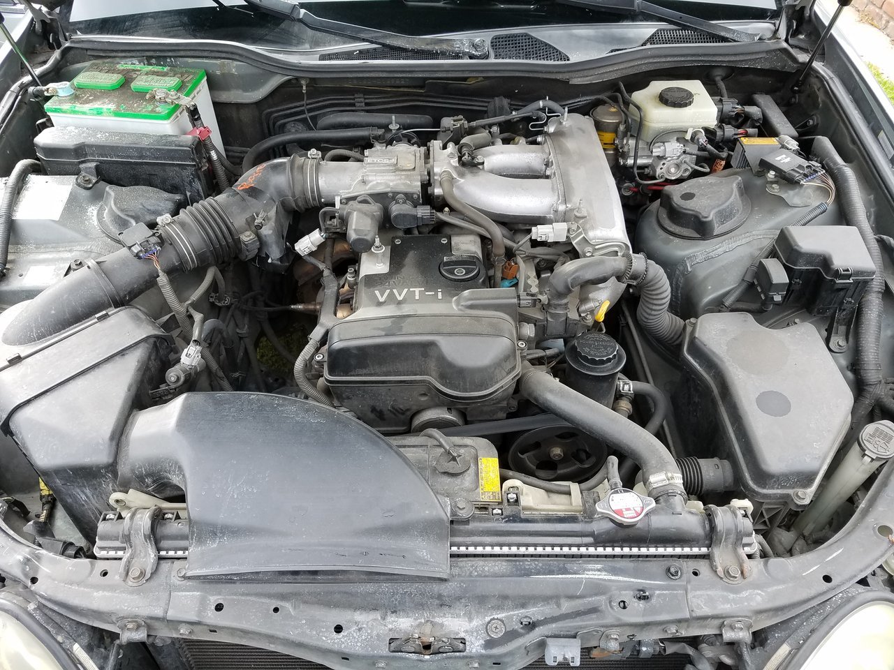

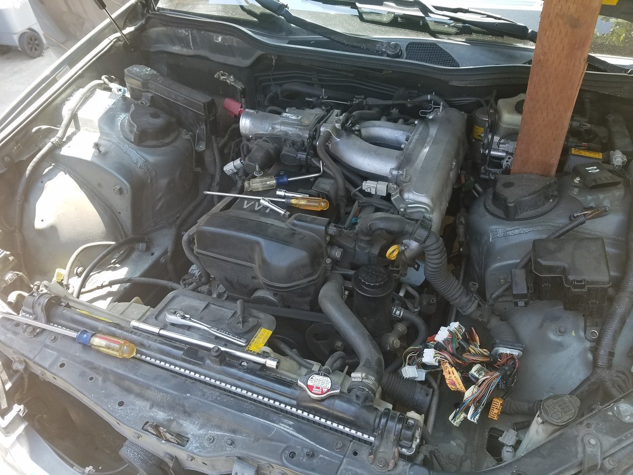

    Currently pulling everything out of the GS. Planning on transferring just about everything over. Really excited, because everything I need is at my fingertips here.

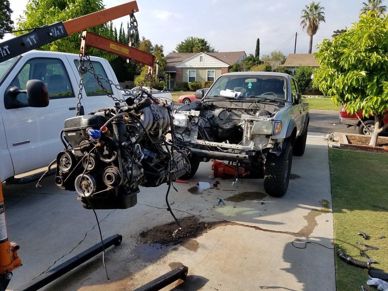

    Alright guys, today is action day. Motor is coming out of her today. Plan is to get the hydroboost unit in, weld up the power steering pump bracket and get everything cleaned up. Tomorrow whole usdm motor and harness is going in. I'll be sure to take lots of photos this time....

    Here she is! Time to clean everything up. Will post a total bunch of photos together later on in several days. This was just the start before all the cool stuff happens.

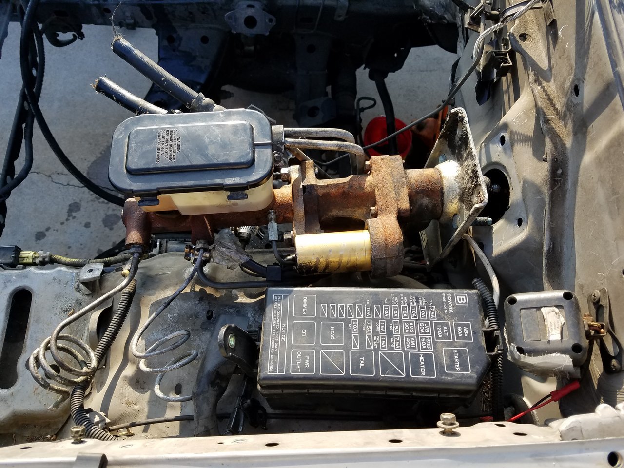

    Guys I'm stoked! Just have to share this one last one for today. Had to turn the fuse/relay box sideways or else the hydroboost was going to hit it. Got lucky, 1 outa 3 holes lined up somehow for the fuse box. Means it was meant to be haha!!
    Hydroboost is out of some '89 GM dually. The 4 bolt booster bracket I have on the Tacoma matches up perfectly with juuuuuust enough space to spare after I drill some holes in it. I'll share some photos of this down the road.

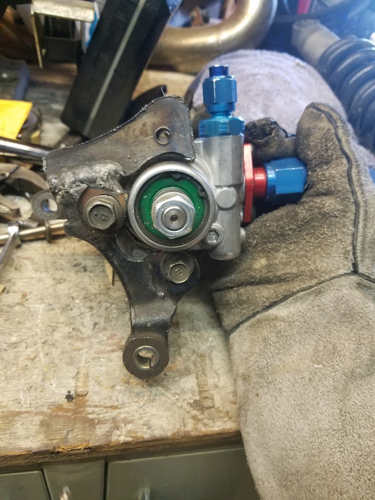

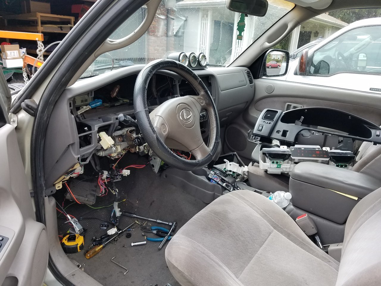

    Brake booster - pretty much done now and fully mounted.
    Power steering pump- kinda done. Mounted up pretty well but needs some reinforcement with the welder and some plate steel.
    Lexus steering column- sub bracket done. If I make enough love to it, it'll hook up with the Tacoma steering shaft. Main bracket is going to need a lot of work still.
    Lexus gauge cluster... I really really really want to make it fit, but I don't know. Ehh. I'm taking a break. Been up doing this since the crack of dawn. No beer all day yet.

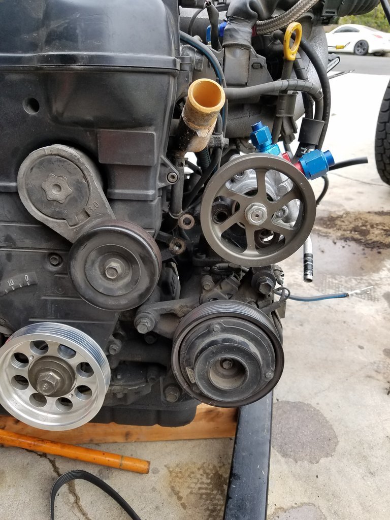

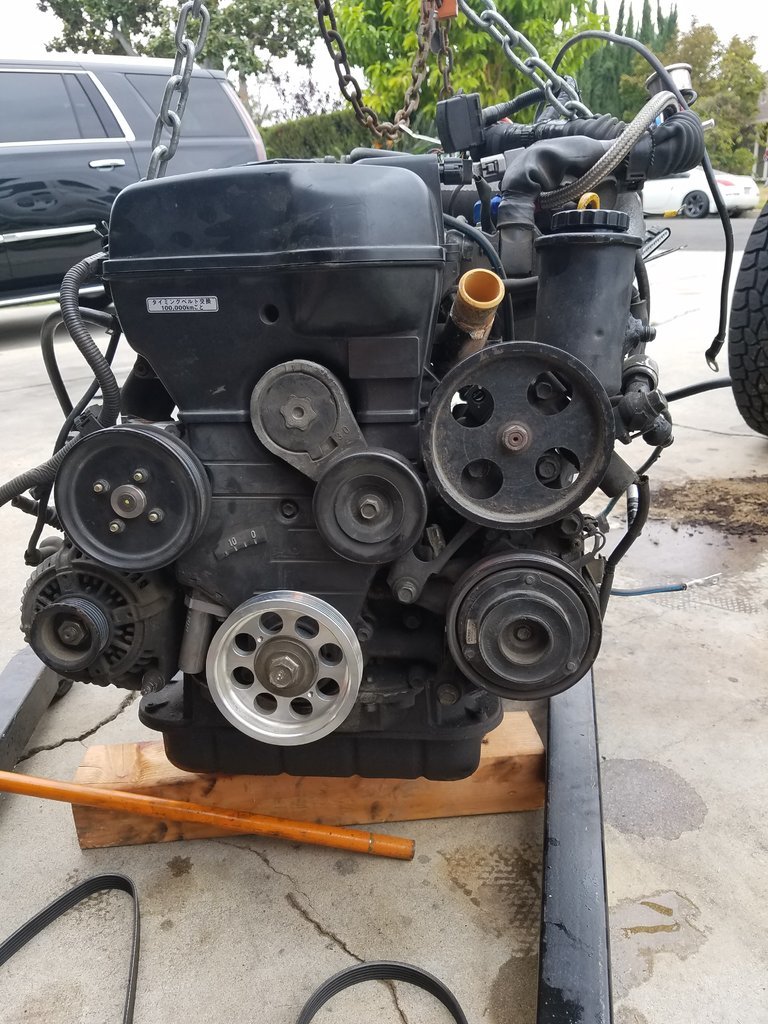

    Uses stock bet size now with underdrive pulley. No more odd sized belts! Tensioner is dead centered and pulley alignment in all directions is spot on. Bracket is pretty from afar, but far from pretty. But as for my own self, I'm totally happy with it!!
