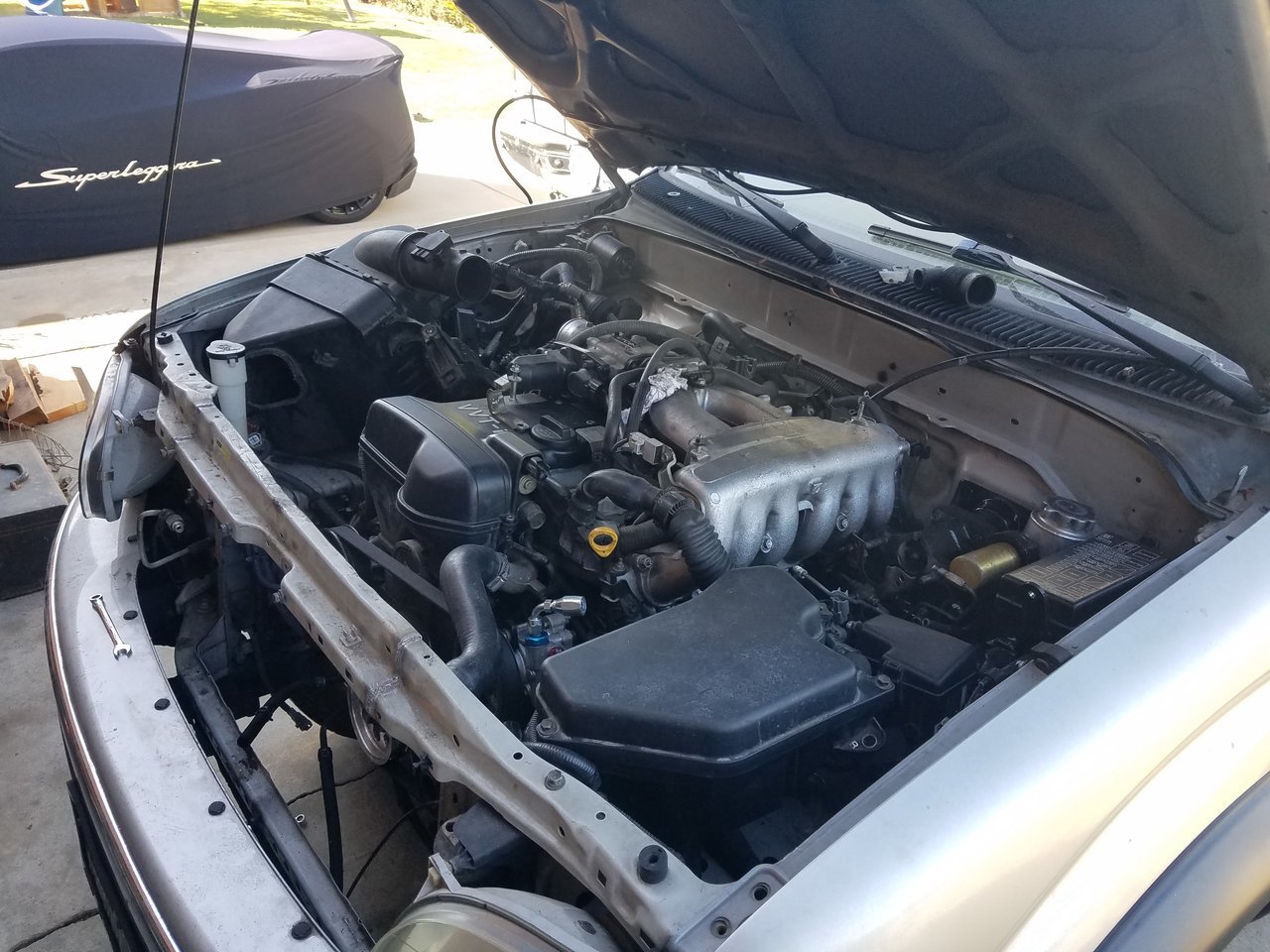

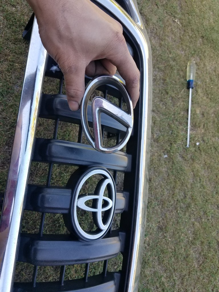

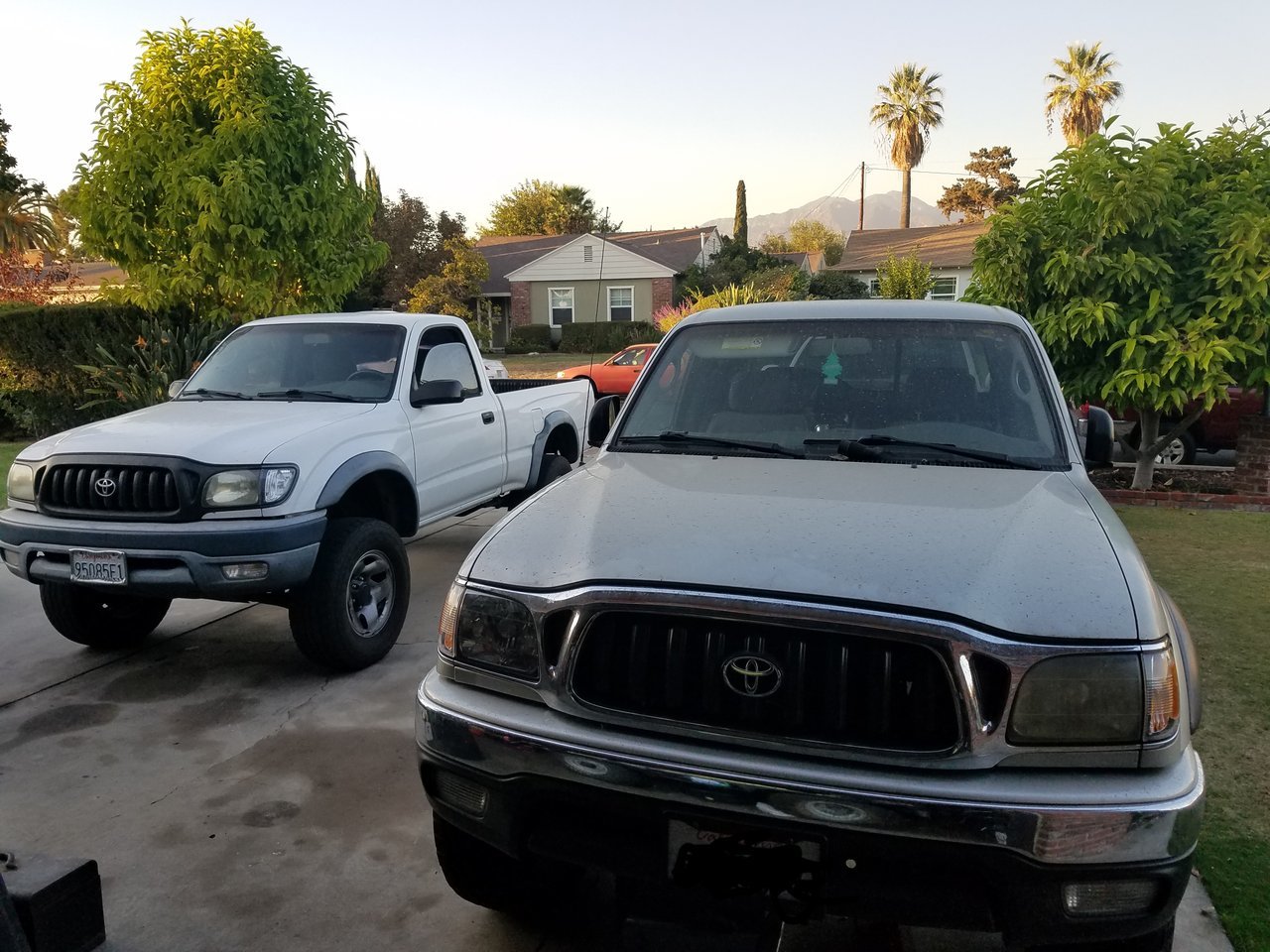

    Front end welded back on and getting some interesting ideas here with the grill...!

    What's under the car cover in the background?

    That's my neighbors '08 Lamborghini Gallardo

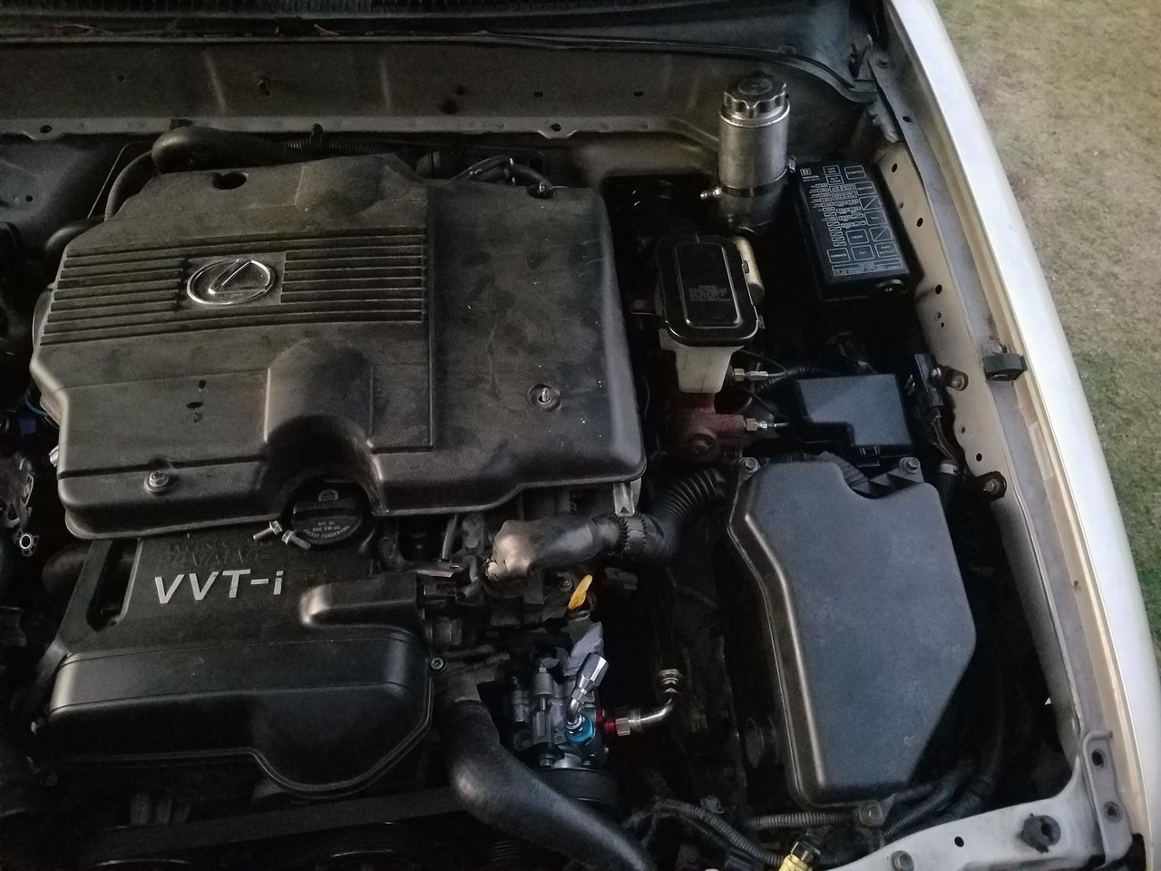

    Let's end the night looking at the kinda sorta nice looking side. Officially have brakes now. Will cut my boost lines tomorrow.
    Also, raising the radiator up a couple inches this time. Will cut the bracket tomorrow as well. I was loosing a lot of coolant and I figured out it was because the radiator was sitting way too low.

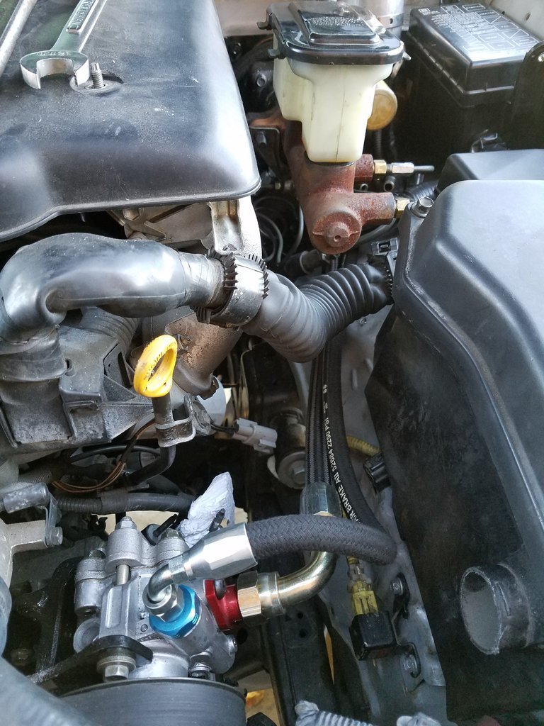

    Got that early morning power steering and hydroboost line connection going on right now!

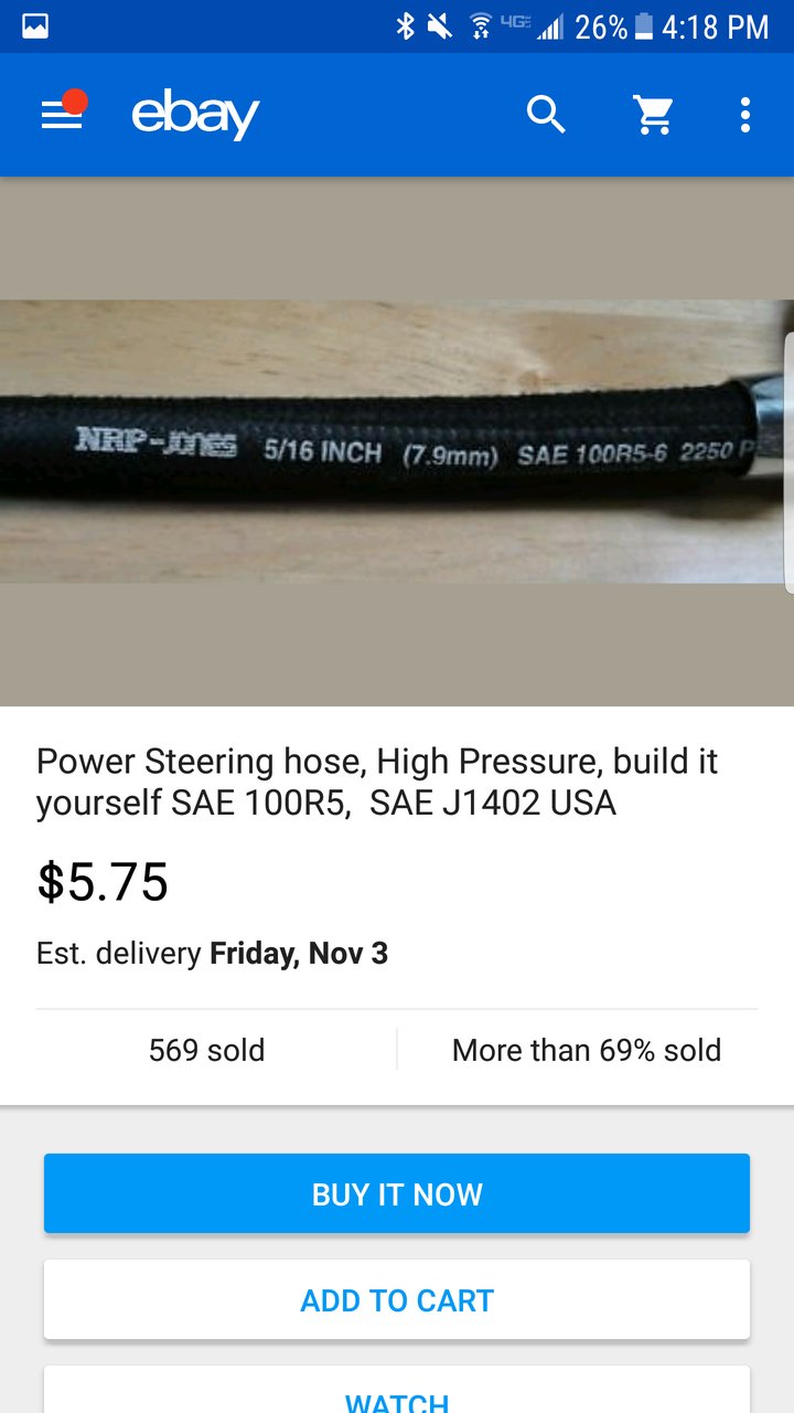

    Where did you go to get your powersteering lines done?
  20. Oct 30, 2017 at 4:39 PM
    #260
    Tyler Lacasse
    Tyler Lacasse [OP] Well-Known Member
    Apr 3, 2013
    #101237
    795
    Tyler
    San Gabriel
    2002 Regular Cab
    Made them myself because line and fittings were so cheap. $8 for straights and something like $15 for 45s and 90s (pictures are what I used for high pressure lines). They are rated for pressures seen in power steering applications. For the return from reservoir to pump I used Aeroquip FC300 -10 line with 90s on each end. The 2' of return line cost an arm and a leg...
