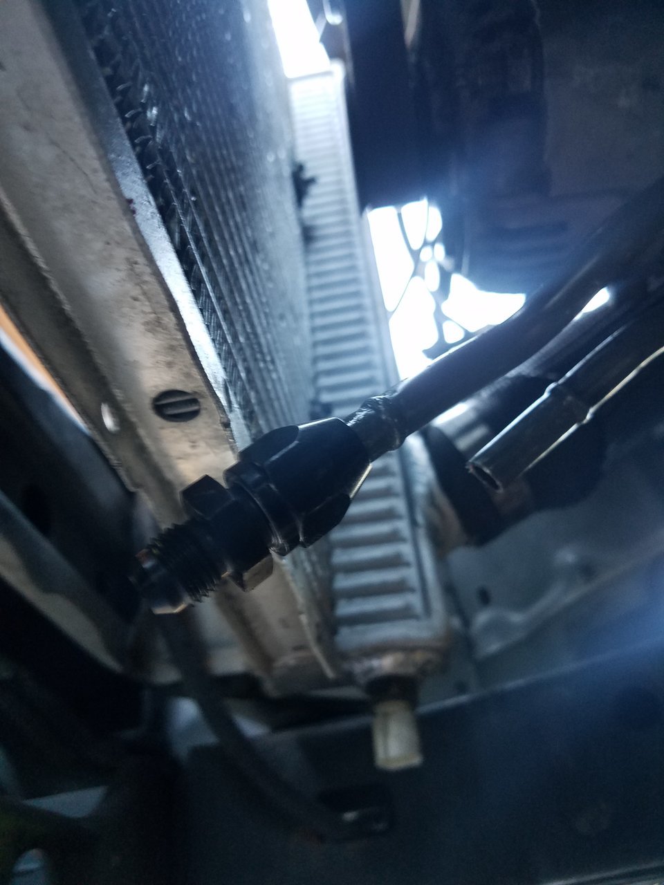

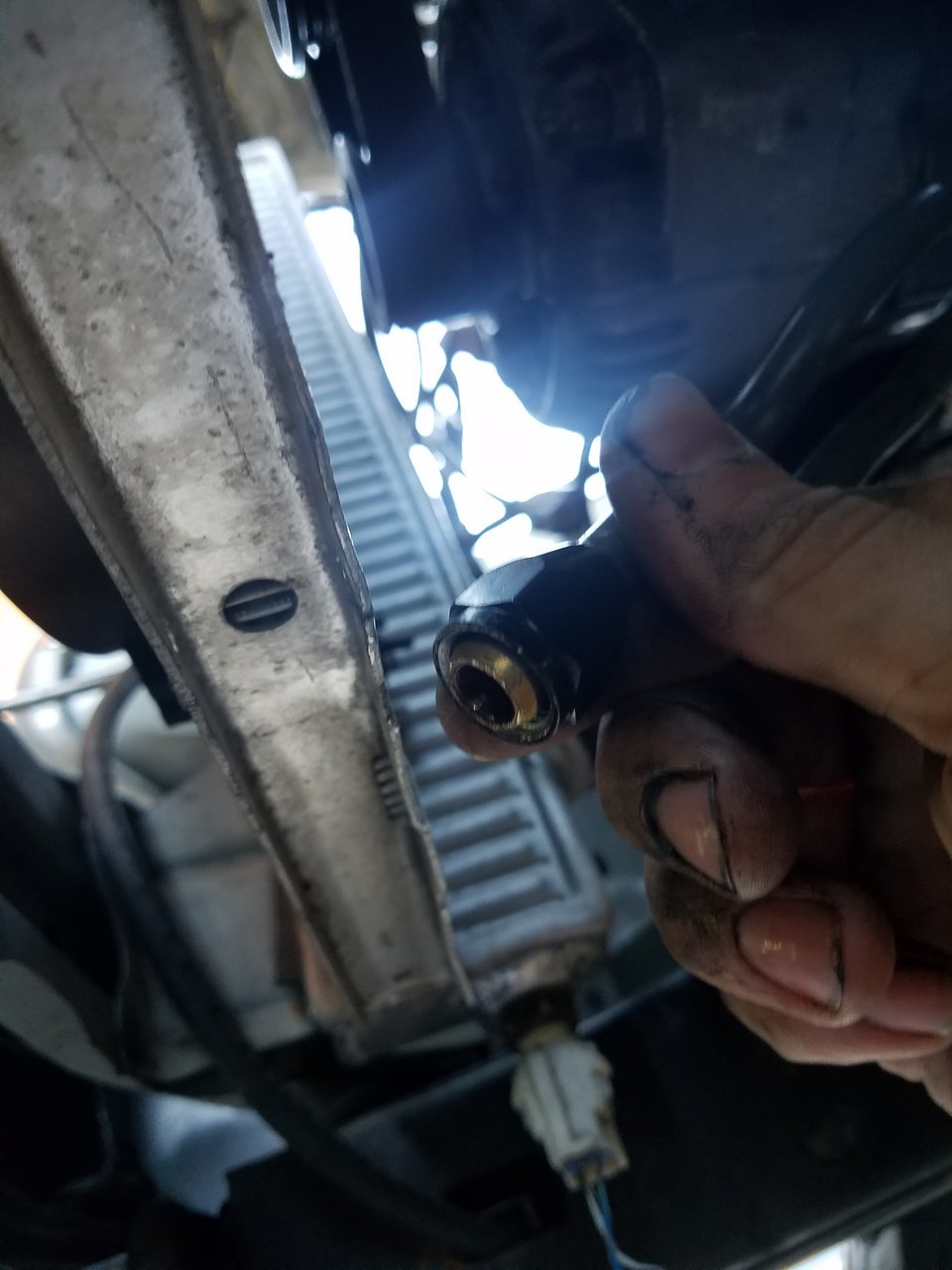

    One of those little things right now... Not sure what size the hardline the transmission cooler is, but 3/8" compression hardline to -6 was too small.
    Drilled out the 3/8" compression side of the fitting, picked out a 10mm compression ring, heated that up with the torch, gave it a little tappy tap tap and bingo!

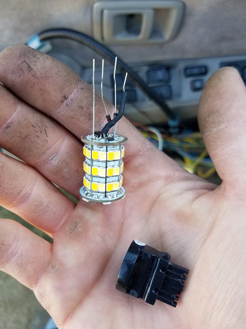

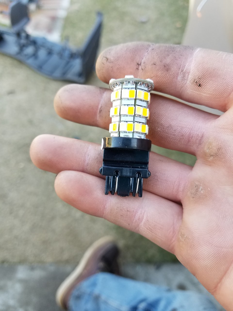

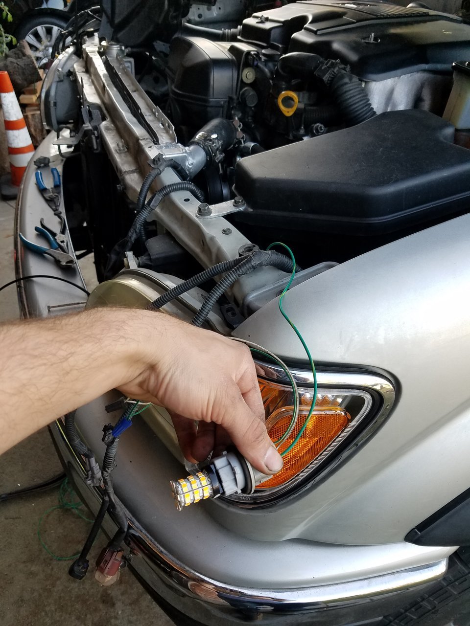

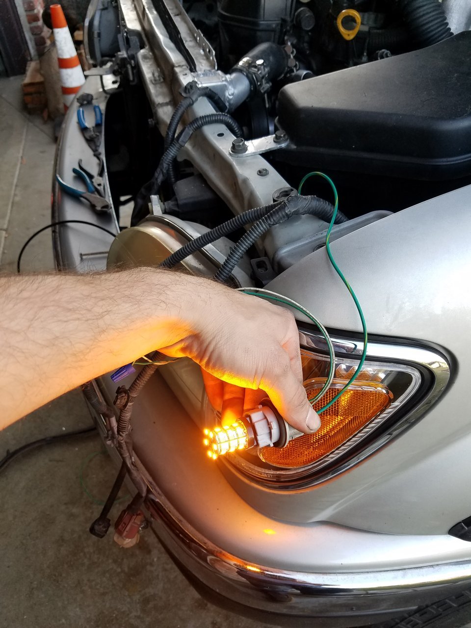

    Switchback from superbrightleds. Because the white and amber are right next to each other instead of opposing sides, I had to do a little switching around.... Drilling the clear corner lights out from my truck and putting those in there on this truck.
    Dalandser likes this.

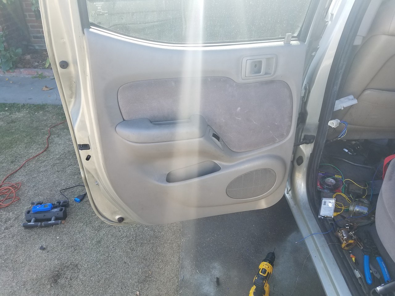

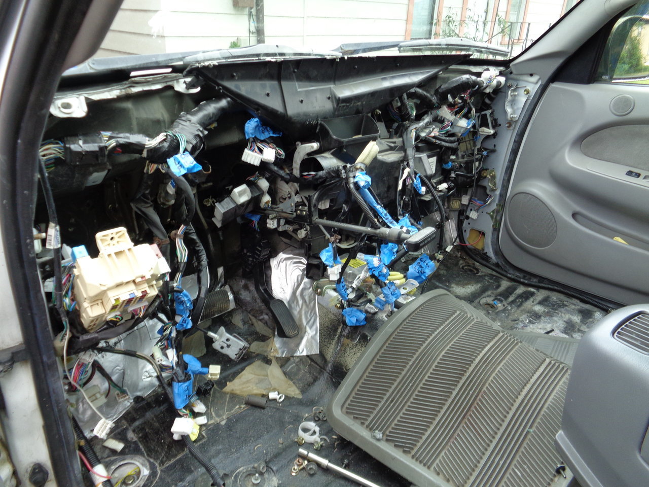

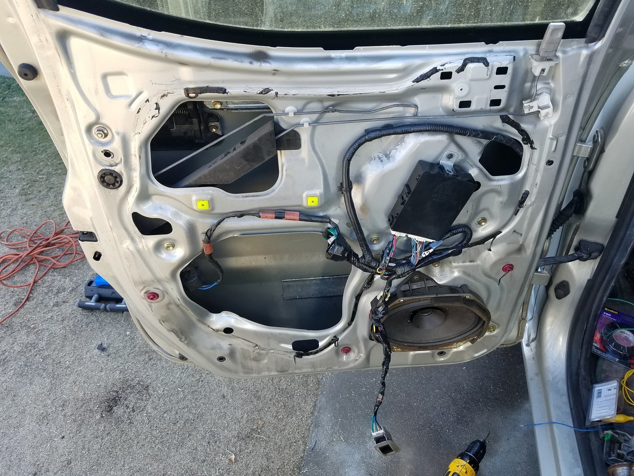

    Happy holidays, everyone! Sharing some progress... All four windows and door locks are functional on all panels. But sheesh, it was such a tight fit to get that door ecu to fit I had to trim the plastic molding marks in that area. Wasn't really sure how to make everything work without the multiplex box, and would have much rather done without it. But it is what it is. All done now with rear doors.
    But to describe to anyone not too sure about this- most window switches are 5 wires. You have a constant hot (in run/acc position). Two grounds. Then you have the two wires going to the window motor and by rocking the switch it channels power to whichever wire for up and down. The Lexus is the same way, but it simply has little signal wires, which go back to the ecu rather than passing real power through the switch like the Tacoma does.
    The Tacoma window motor has two wires. The Lexus one has five, I think. Not too sure what the other wires do, but if I could guess it has to do with the one touch auto up or down and sensing where the window is at. Unfortunately that feature didn't carry over to the truck...
    As I'm writing this about how switches work, I'm having seconds thoughts. I'm using the Tacoma switches. The thick gauge wire leads into the tiny Lexus wire which simply just sends a signal now to the brain box. However, I'm going to see if I can bypass them tomorrow, possibly. Don't want to use them if I don't have to. One less thing to break. Only thing I worry about is if I'll still have control of all windows from the driver side...
    tony2018 and Speedytech7 like this.

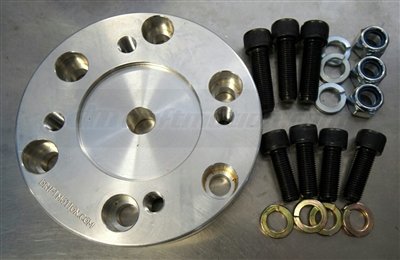

    Haven't got to the headlight retrofit yet... But-

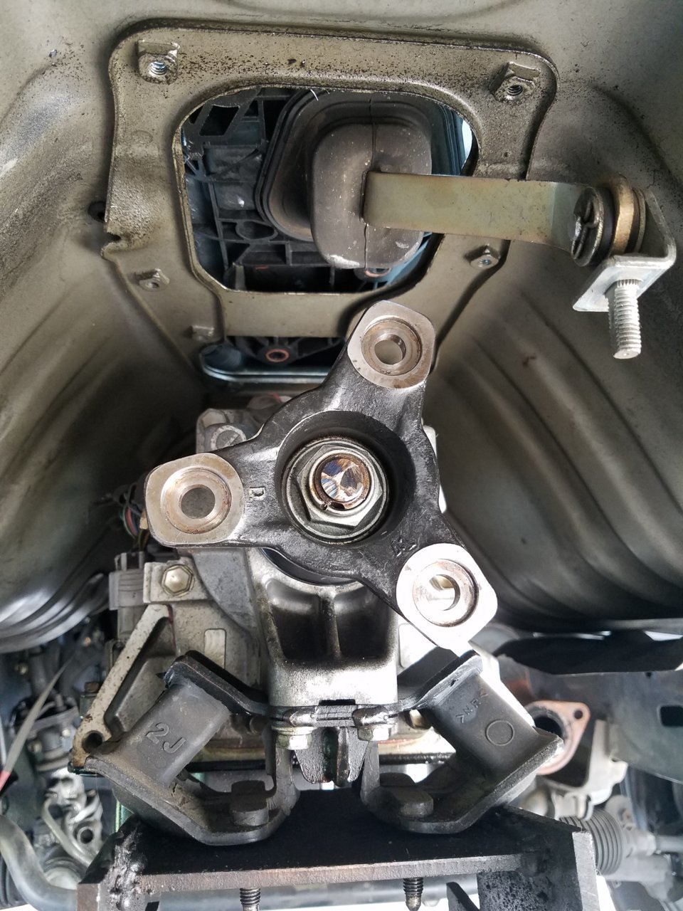

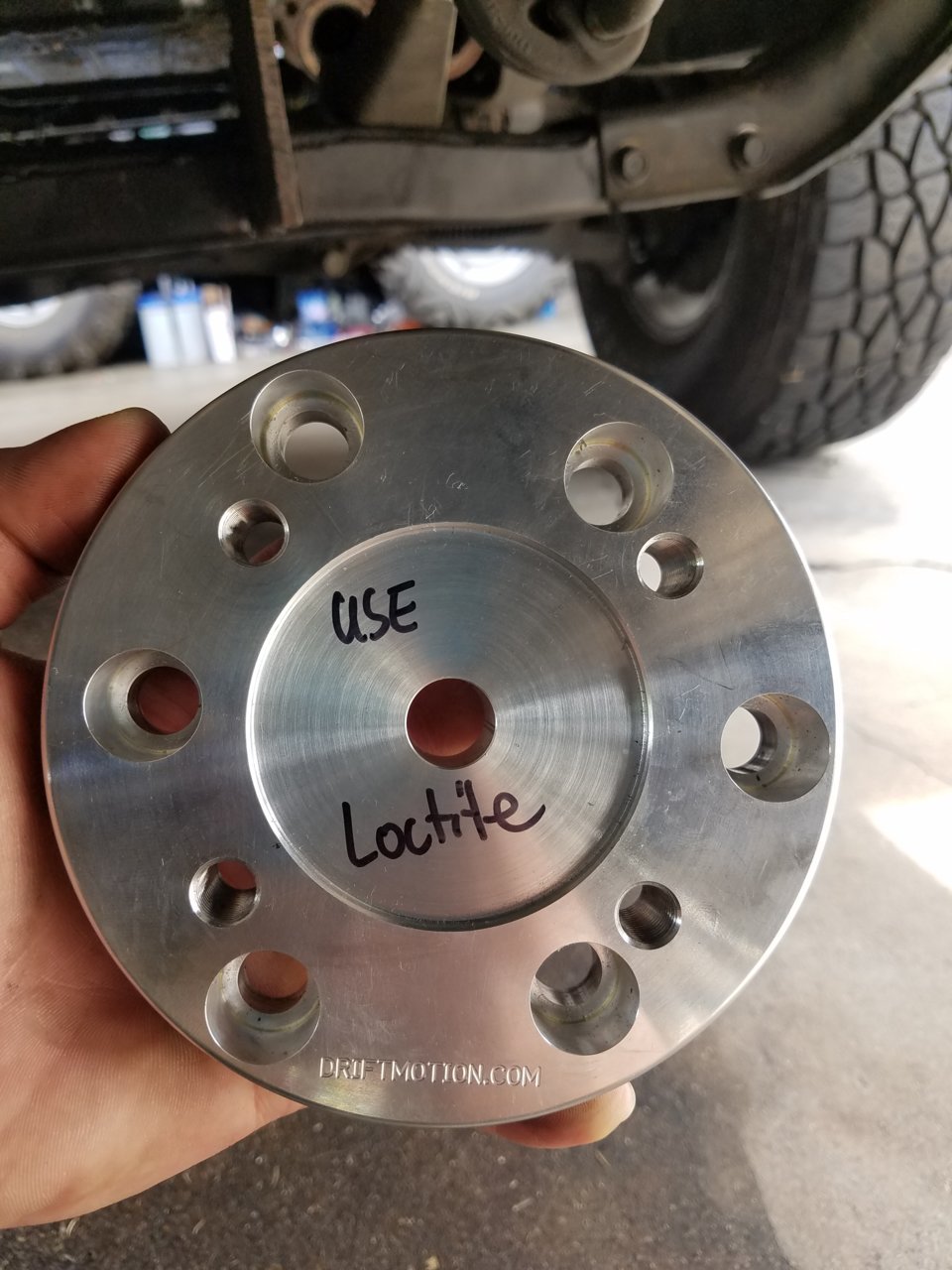

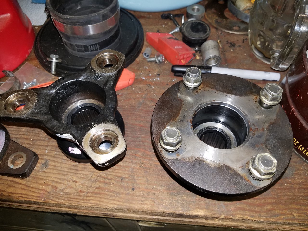

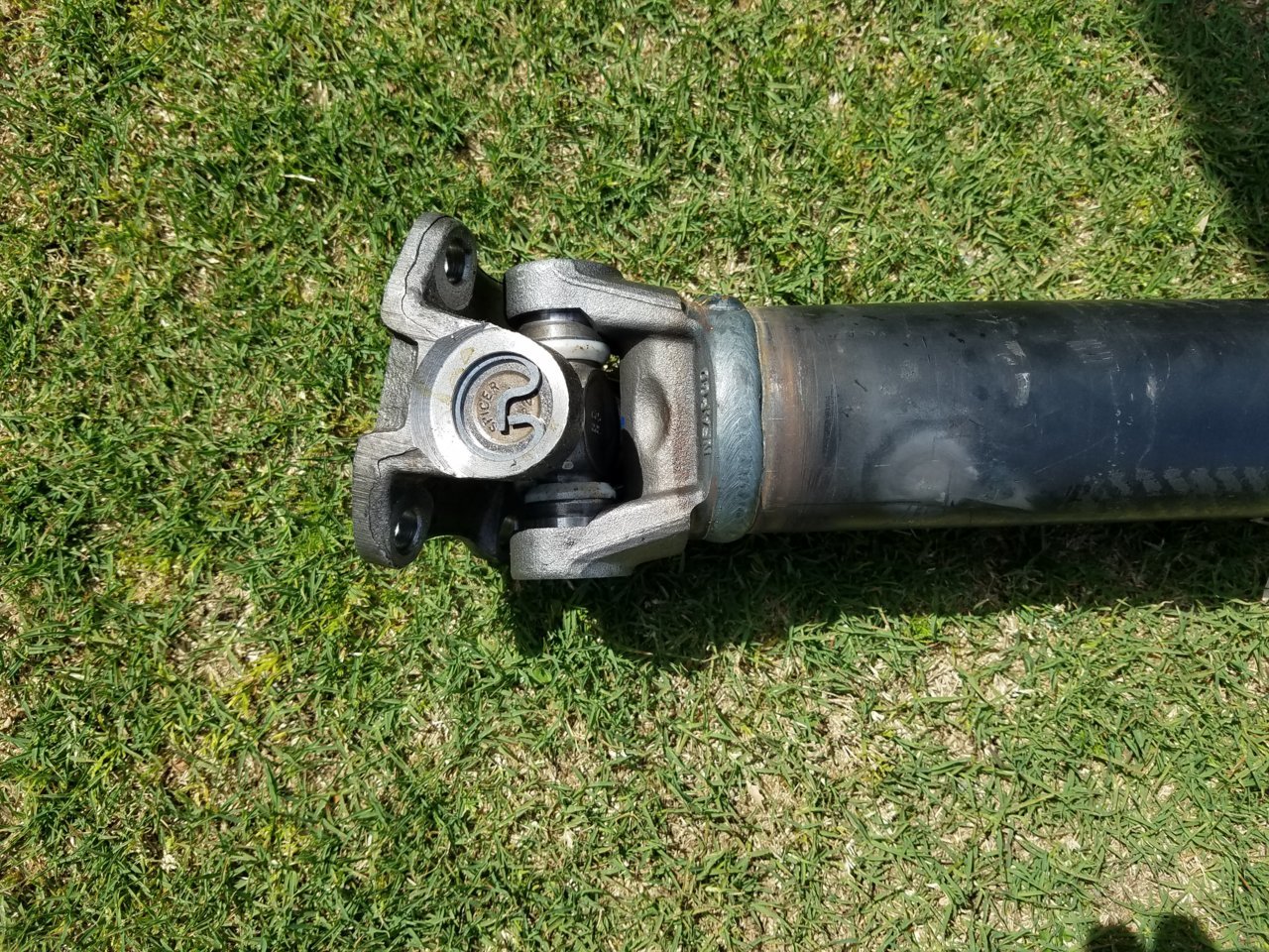

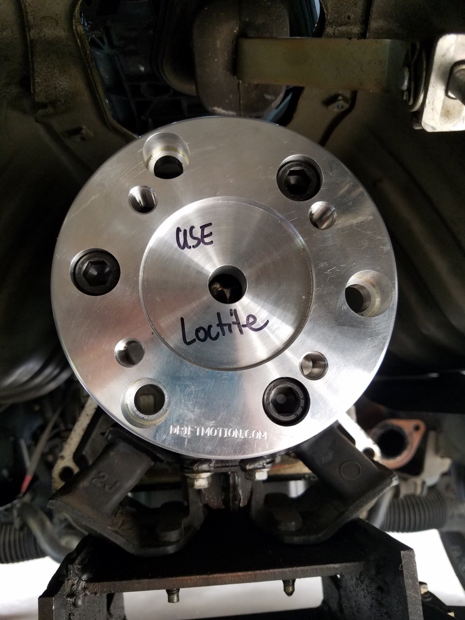

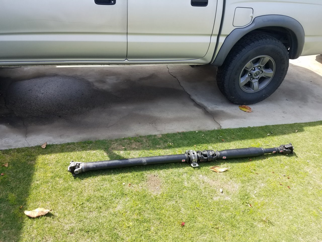

    Drive shaft. You guys know the current issue now, unlike the previous jdm a650 transmission where the Tacoma 4 bolt flange slid right on magically.
    Problem. GS300 transmission output 3 bolt non u-joint flange and Tacoma 4 bolt u-joint flange. Obviously they don't fit. Drift Motion in Montclair by me (I've been there before, really cool people there) somehow magically have an adapter that I think will fit the Tacoma 4 bolt driveshaft and will definitely fit the Lexus 3 bolt flange. Will head to pick it up next week. Unfortunately the drive shaft will need to be shortened a little bit, again.
    I've looked at everything from Lexus LX, Land Cruiser, 4runner, everything transmission output shaft related other than Dana 44 axle which I think has a 26 spline 1.146" shaft, which is close to the 1.35" 26 spline Lexus a650 output shaft. Seen a couple things where someone machinined the 3 arm off and welded the 4 bolt pattern on. I'd rather avoid that the more I think about it.
    So yeah.... getting close.

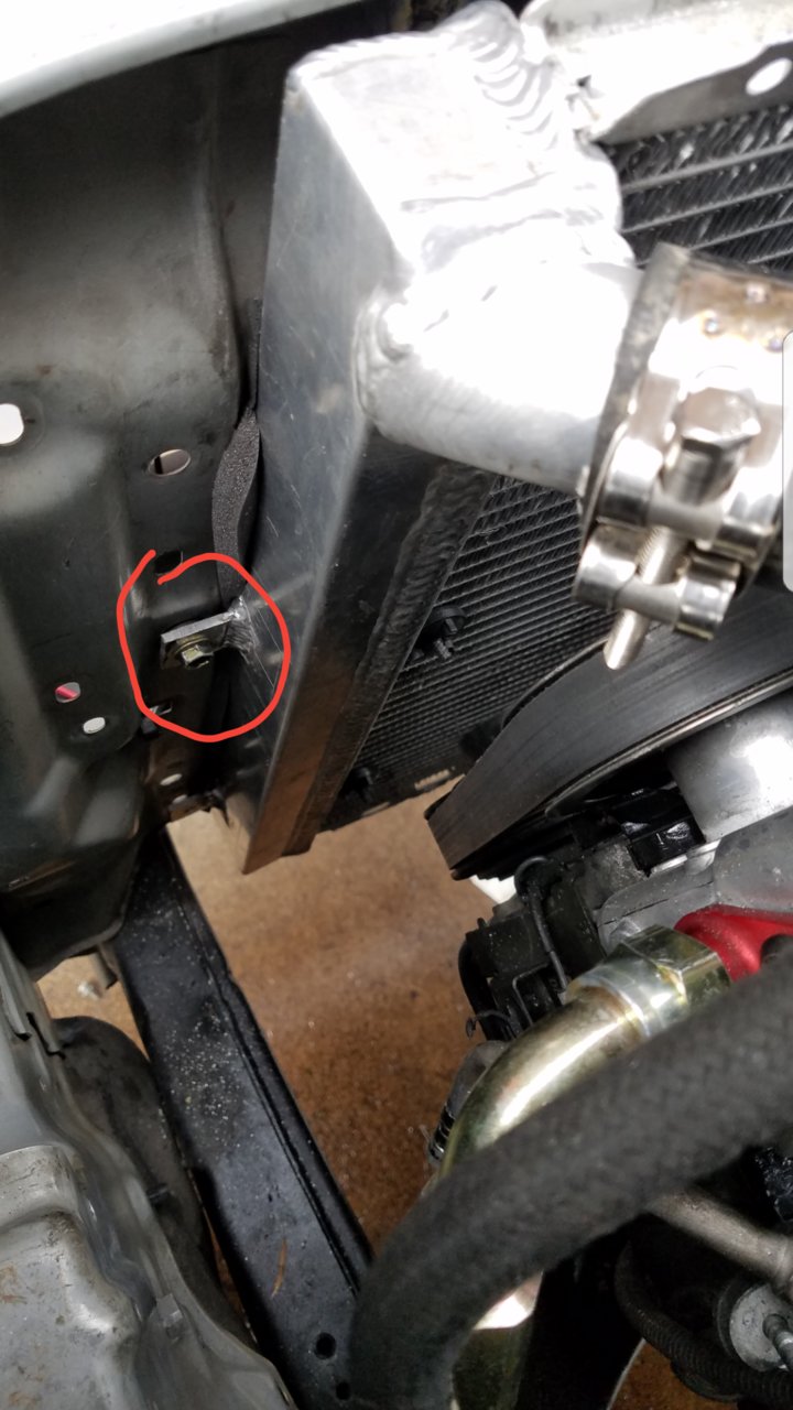

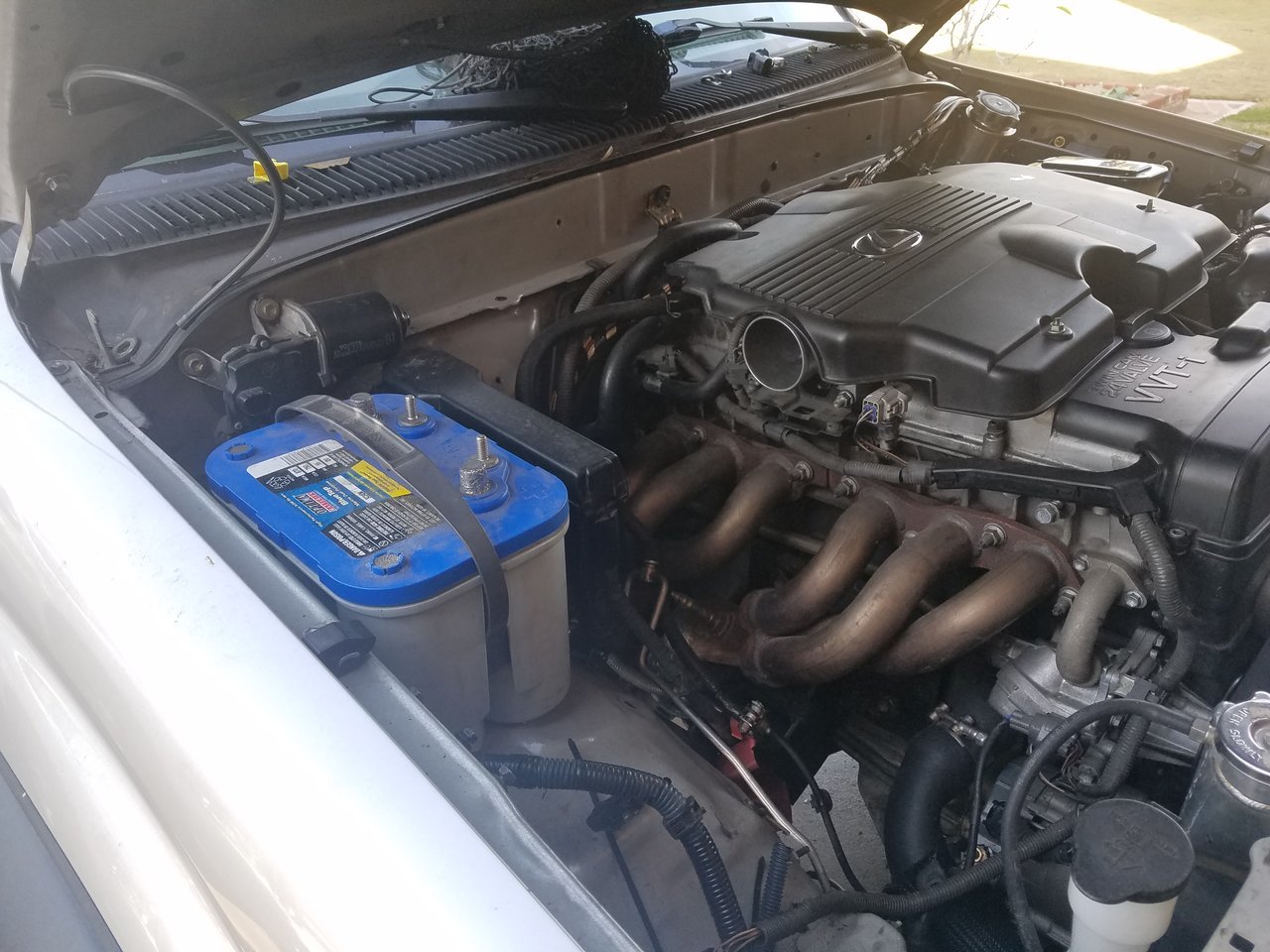

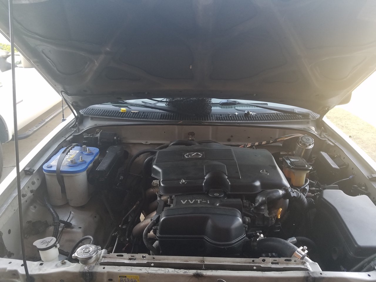

    Found a spot where the battery fits perfectly while safely clearing the terminals between the hood brace and still giving ample room for the intake. Going to do a basic angle iron frame around the base of the battery and then make a (hopefully) nice looking top bracket to secure it to the base.
    Only thing left after that which I really need to figure out is how to fit a CA legal intake for a 2002 Lexus GS300 into a 2002 Toyota Tacoma.... Not too sure about that yet.

    Regarding your air intake - can't you use a CARB certified cold air intake for that engine? A lot more compact than a stock intake.
    I noticed you're getting this ready for California SMOG. Are you using the Lexus' original emissions systems?
