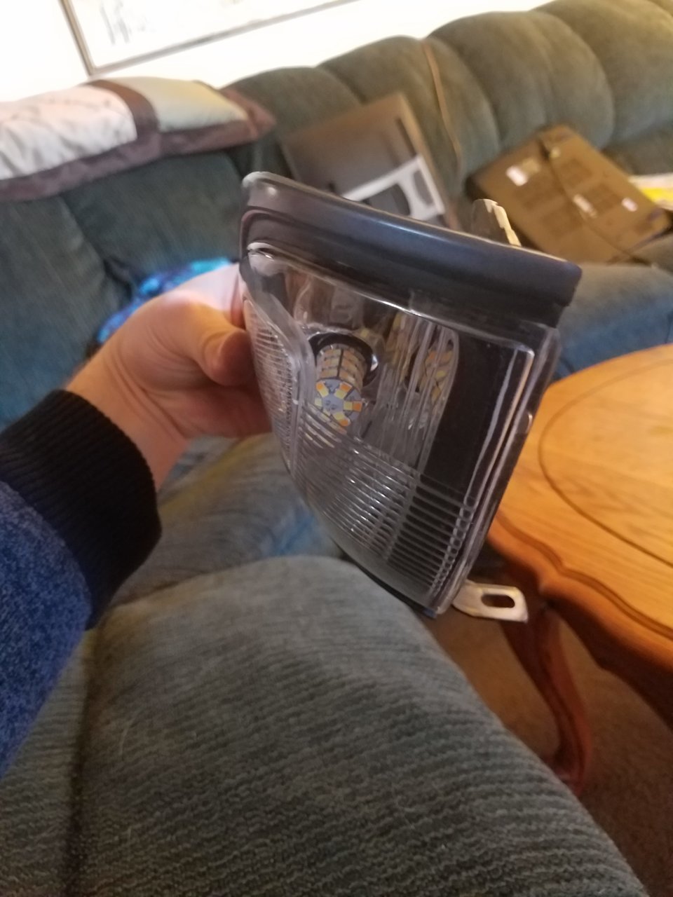

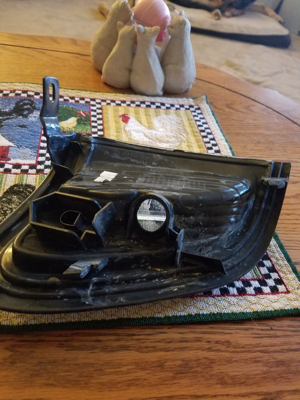

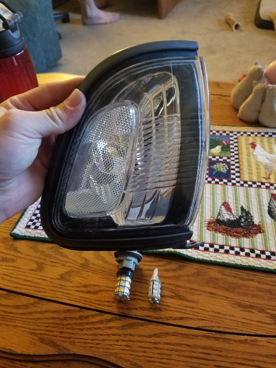

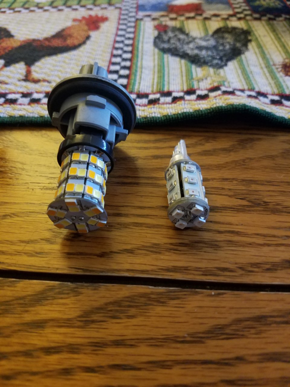

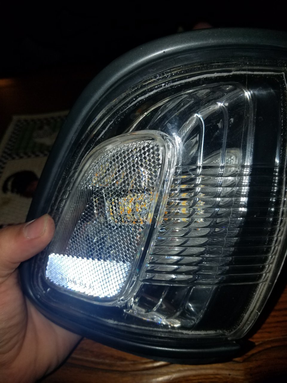

    Wanted to share this switchback setup I'm doing here. Got the bulb a while back from superbrightleds. Doing this in both my truck and my girlfriend's truck. Most likely just going to glue this into the corner light. If I ever need to do a new one I can just cut it out or get another corner light for cheap off of ebay. LEDs should last for quite a while. All I did was take the base out of the turn signal housing, modify the bulb (as seen posted a page or two back for the 2jz taco... Not sure about mine yet), and took a Dremel to grind the hole out a bit bigger for the bulb to fit.

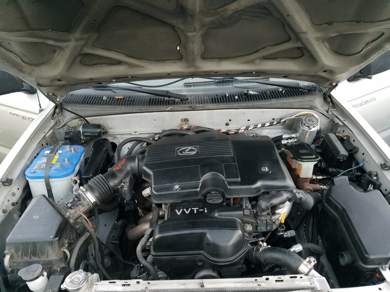

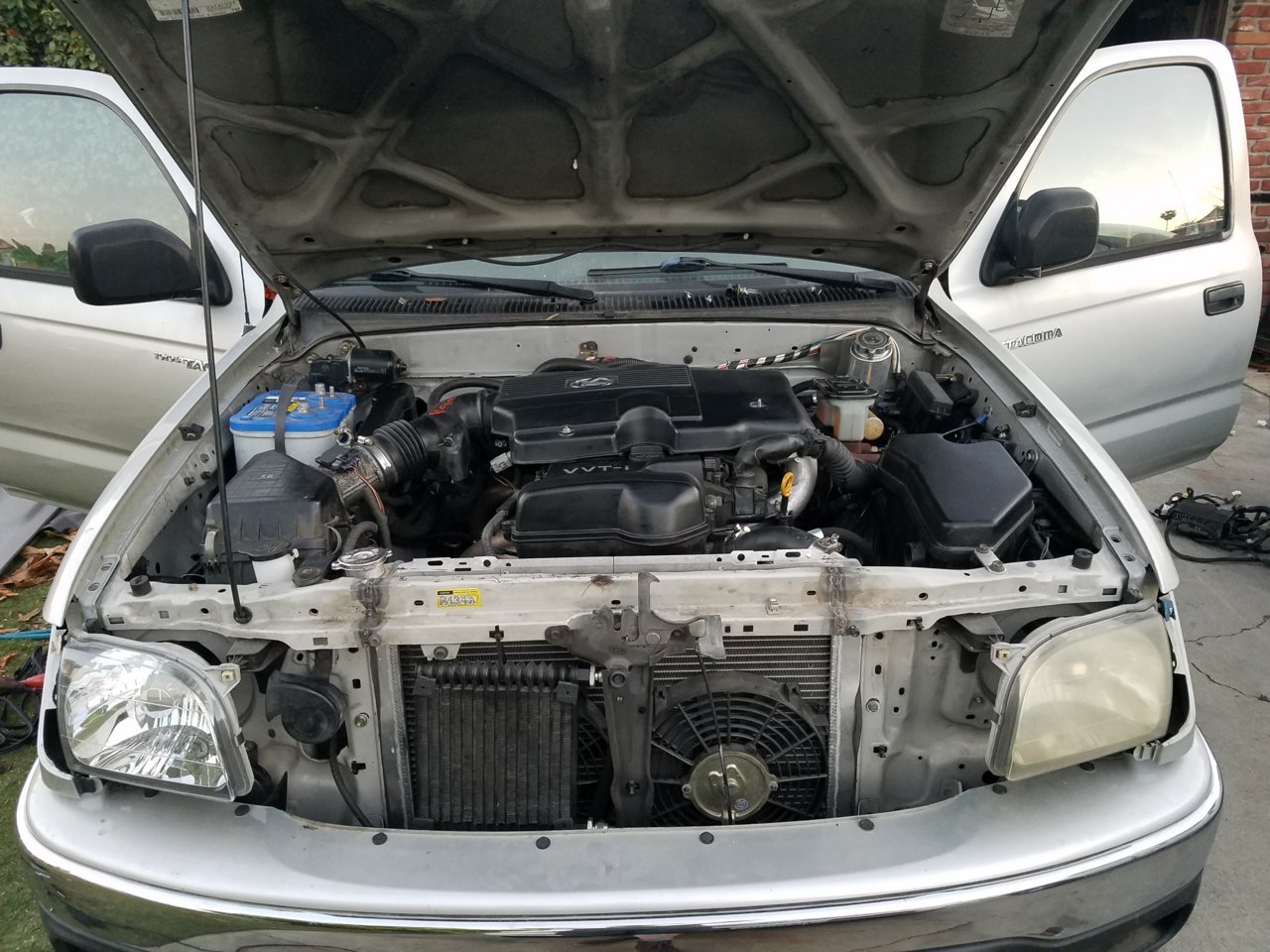

    Wanted to share this with you all. Need to finish the battery tray and cleaning up wires. But other than that...air box! Little Dremel action to bore out where the MAF goes. Very low key and no one would never know it doesn't belong there.

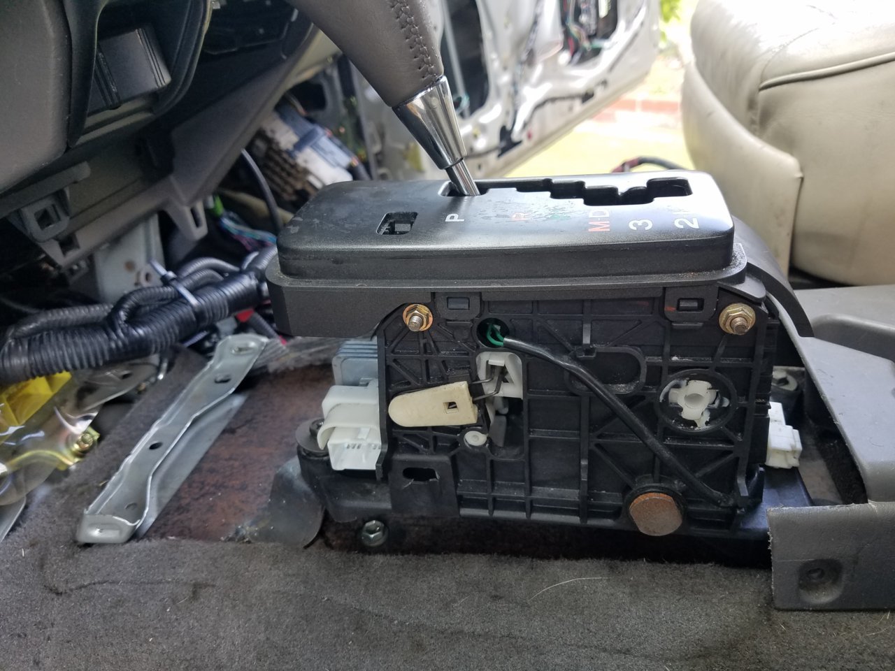

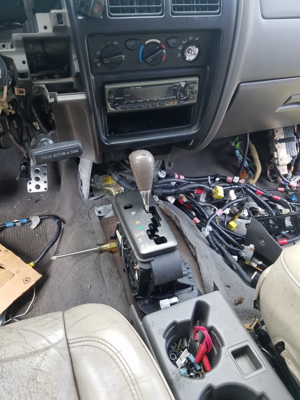

    ^^with that said, I'm definitely going to be putting the 4.30 gears in this truck swapped over from my regular cab. Also, I know it's not as good as having a professionally modified valve body (not going to happen, tight budget), but I'm going to be shimming the springs so it shifts faster and firmer, rather than the current "luxury" sloppy shifts.
    Anyhow, got the shifter semi done and the exhaust is fully welded up now. The Apexi N1 exhaust isn't exactly loud, but it isn't silent either. The truck sounds like a drift car :burnrubber: which is really cool. No rice! I'll have to do a sound clip for you guys. It really sounds super cool!

    Sheesh, so much leftover wiring harnesses.

    Definitely. I'm waiting till I get everything I need working then going to cut off the excess then tuck it in.

    How do you plan on hiding the shifter?
    Post more interior pics, I'm curious on how you hooked up all the body electrical like the windows and mirrors and doors.

    I'd let it stick out, wouldn't matter at this point.

    Will get some more photos for you the next couple weeks as I'm making progress in the interior.
    Going to make a housing around the shifter with 1/8" aluminum plate.

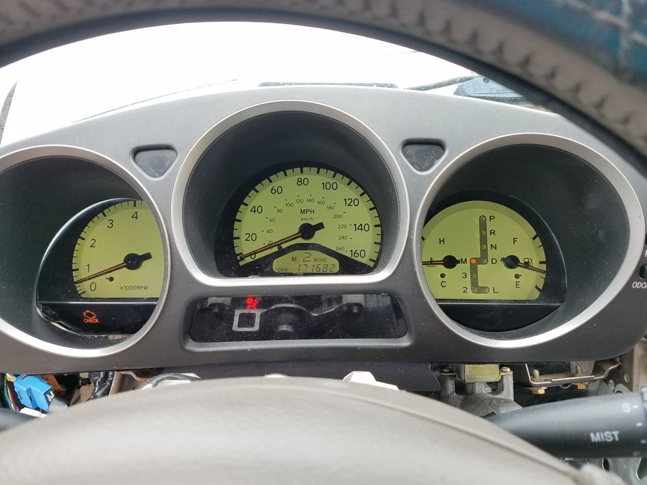

    Got the gauge cluster fully working and it displays what gear I'm in when using the push button shifters on the wheel. Freaking cool!!!!!
    randd, pir897, tony2018 and 2 others like this.
  20. May 12, 2018 at 7:14 PM
    #340
    tony2018
    tony2018 Well-Known Member
    Feb 24, 2014
    #123866
    5,285
    gs300 cluster
