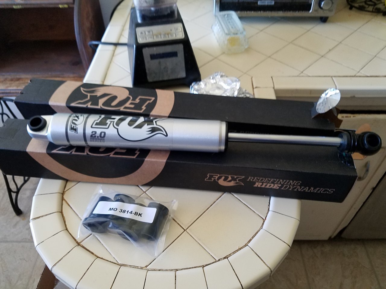

    These came in today! As most of you know I've been doing this on a super tight budget not to mention about to 4x4 Swap my regular cab on top of all this. Ever since I got blue colored SAW Racerunners on my front end its hard to go back to Bilsteins. So found these at a decent price for my girlfriend. I'm still stuck with Bilsteins in my rear though and she's stuck with Bilsteins in her front :( how'd that happen to work out?!

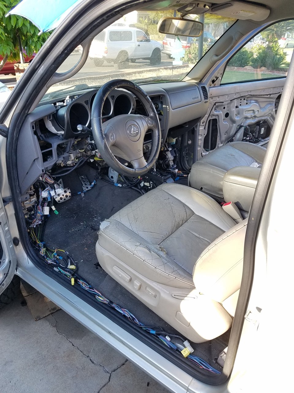

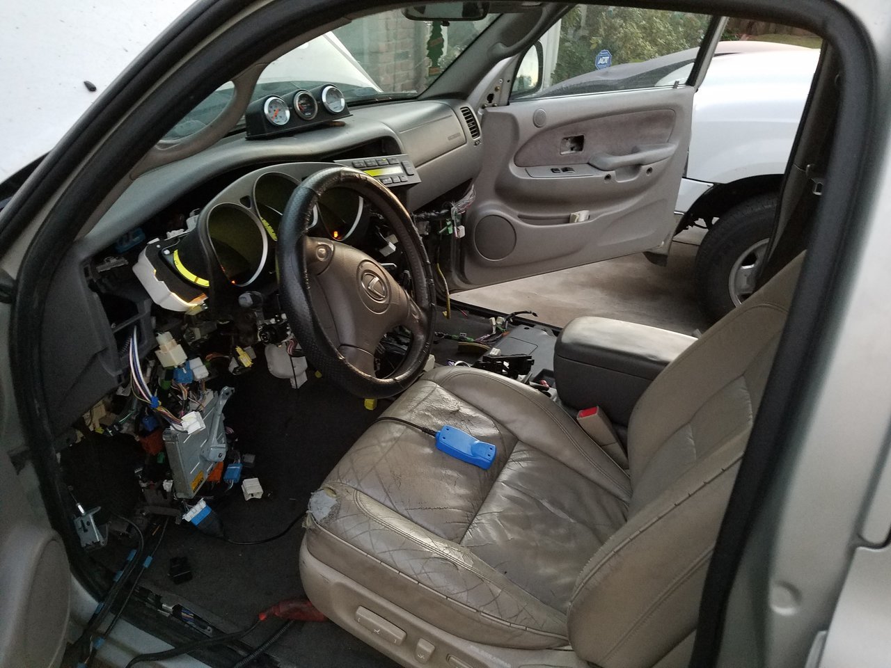

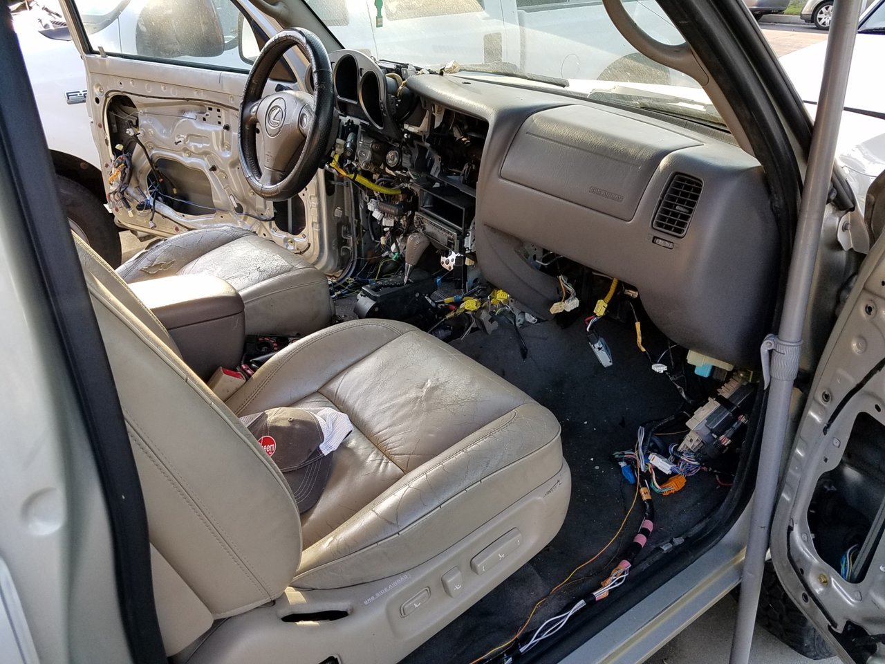

    Cleaned up more wires along the doorway. Geeeeting there slowly but surely. Had to take a break for a bit because I got so tired of this. Worked on my truck instead for a while...but I'm back on this. Some interior shots!

    Did these seats mount up fairly easily or were there some modifications to the rails?

    All I did for the rear of the seat brackets is just weld an "L" bracket, for the front I slightly bent a flat piece of stock downward and welded it to the seat bracket.
    Most amazing seats ever. I honestly can't describe how comfy they are. It's like sitting in a plush yet supportive couch that hugs you just right, but doesn't feel cheap or sloppy. It's amazing!!
